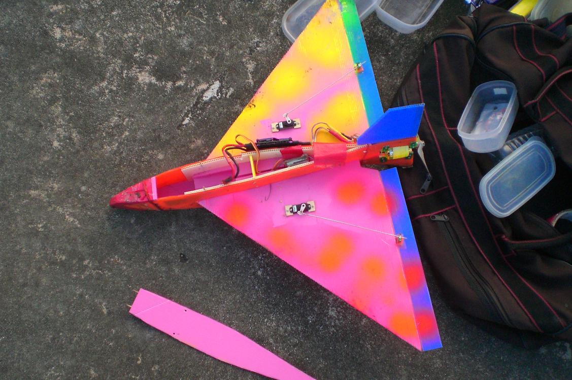

          After replacing the faulty servo I took the delta for more flight test but
          ...I crashed the single fin yesterday.
          Here is the video link or the crashed and some high speed test.
          Will do a postmortem of the crash and hopefully come up with a better build.
          More next time.
          Observation and personal opinions:-
          The Single fin is more stable during a hand launch.
          Have not encounter flat spin tendencies since the modification to a single fin while the twin fin setup is prone to flat spin and unstable flight during a hand launch or a hard bank with little or no power.
          This delta shape(mugi shape) is fast ( I think it is faster than my own design 24 inches micro-interceptor).

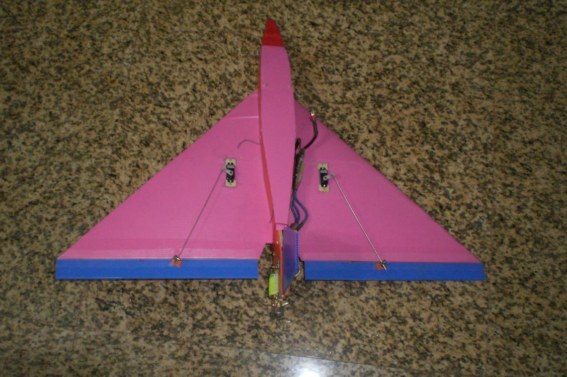

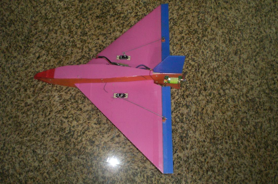

            Improve 24 inches corrugated plastic delta
            Having experimented on the single fin delta plane from my previous I proceed to re-built this nice delta place. The CP material is folded with a lesser thickness airfoil. Although it has less lift it also has lower drag. The result is some really nice performance.
            Here are the some pictures and the test flight videos.
