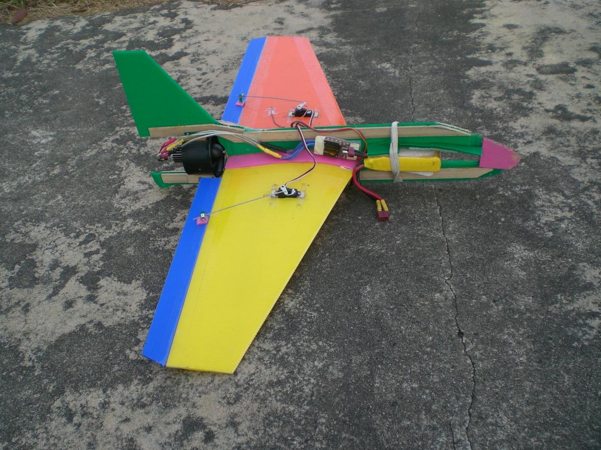

              #21
              coroplast EDF scratch built plane
              Here is the video of the corroplast EDF version.
              happy viewing

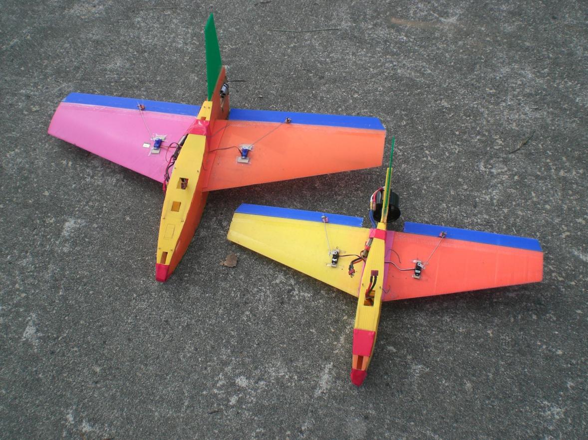

                  #23
                  Here is another corrugated plastic aircraft.
                  Runs on 4S lipo.
                  Plans to upgrade to a more efficient motor. The wingspan is approx 865mm or 34 inches. Its roomy and can pack quite some heavy motor. I have use from 100 to 140grams motor to test this C.P. aircraft
                  The smaller aircraft is only 24 inches wingspan.
                  Both are fun to fly.

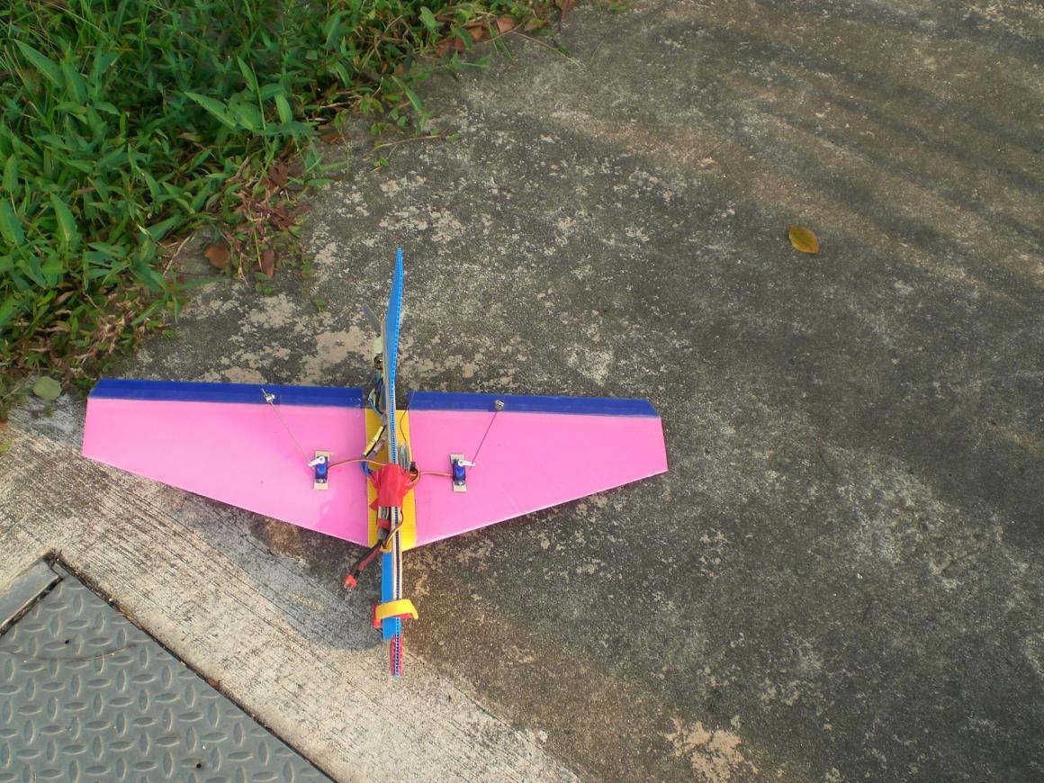

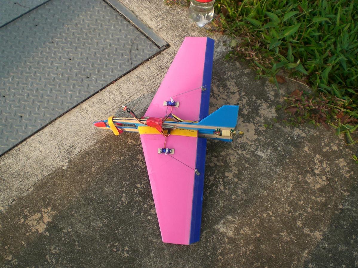

                    #24
                    I have added rudder control to the mini interceptor SPAD .
                    Tight turn and knife edge is a possibility. This plane does not have a separate stabilser that can act as rudder turn during a knife edge turn, hence it take some practice to use the elevon mix control to get the knife turn right.
                    Here is the video link.
                    The first two flight was done without the rudder control added. The 3rd flight has the rudder control added. Unfortunately rain came and terminate the test pre-maturely.

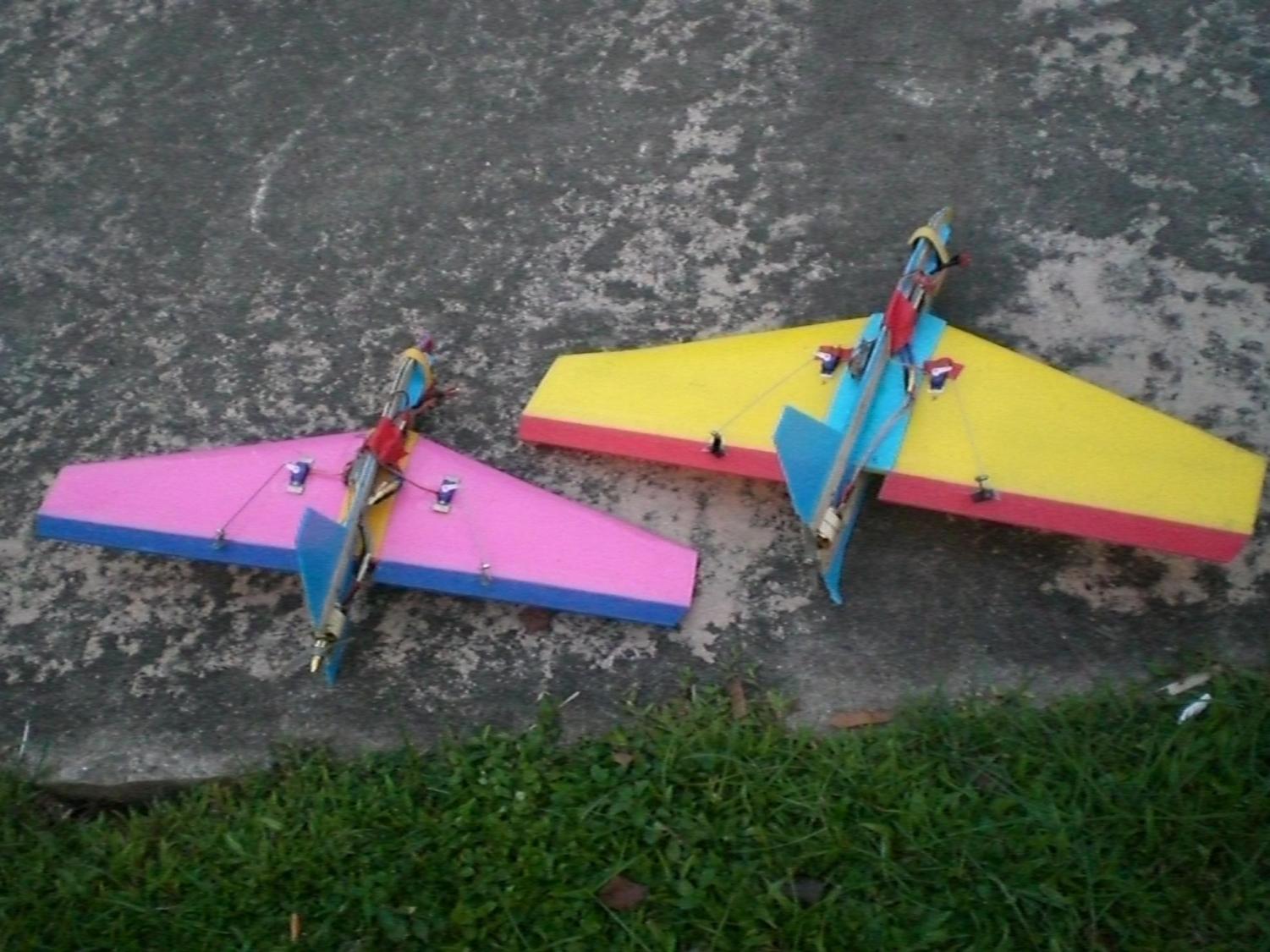

                      #25
                      HERE ARE MY FAMILY OF TAILESS FLYING WING COROPLAST FLEET.
                      All Scratch build. Plan by experimentation.
                      Cheers and Happy Lunar New year.

                          #27
                          Hello b5, happy new year!
                          Generally I prefer my planes without all their innards hanging out but hey since they fly, you can proudly say that you 'designed' these planes.
                          Hey how about providing the measurements for them?
