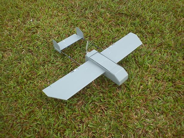

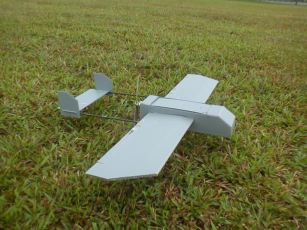

    Uav
    Here is my UAV corroplast build
      #47
      Video
      And here are the video taken early last year...
      TAKE OFF
      LANDING
      Flying characteristics is similar to e-starter.

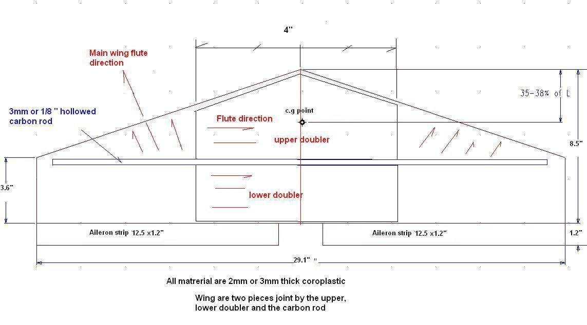

              sorry, at the moment the fuselage dimension is just simple rough sketches .
              I could give you wing dimension but not the fuselage as its difficult to re-produce on PC due to irregulars lines. The vertical fin is approximately 30 to 40 of the L& R wing area.
              Attached is the 29.1 inches wingspan wing dimension.
              You may need to do some experiment to get it right. Try the flat or profile type fuselage.It is easier to built.
              cheers
                #52
                cheers
                L=(8.5+1.2) inches
                so the balance 35% of L=3.395Inches =3.4inches (rounded off) from the vertex join of the delta wind.
                This plane is very stable in flight. No nasty habit.Can fly inverted, slow or fast. Does not stall easily unless you try to land without power and flair the elevon too early.
                Note this plane is very similar to the WWII warbird ME163 Komet "tailess delta warbird"

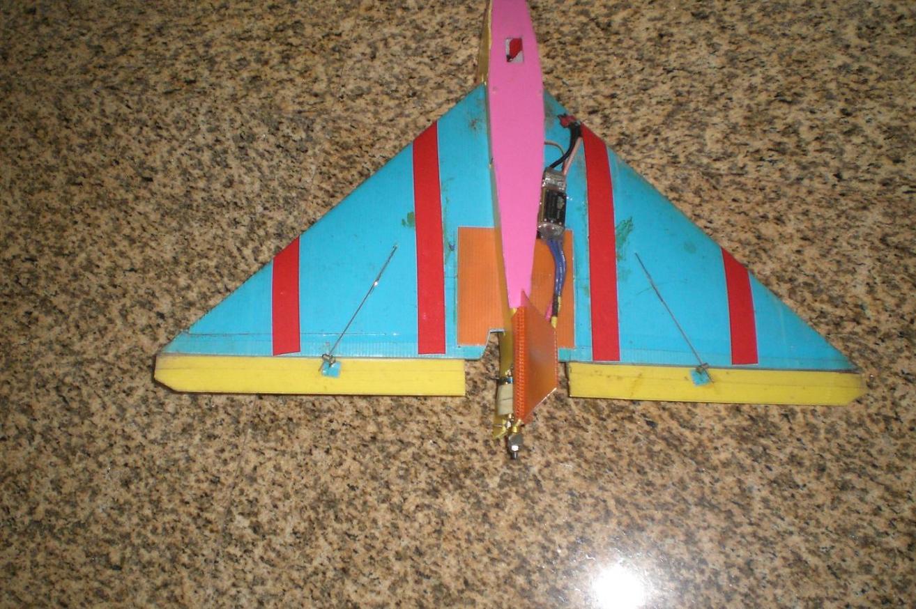

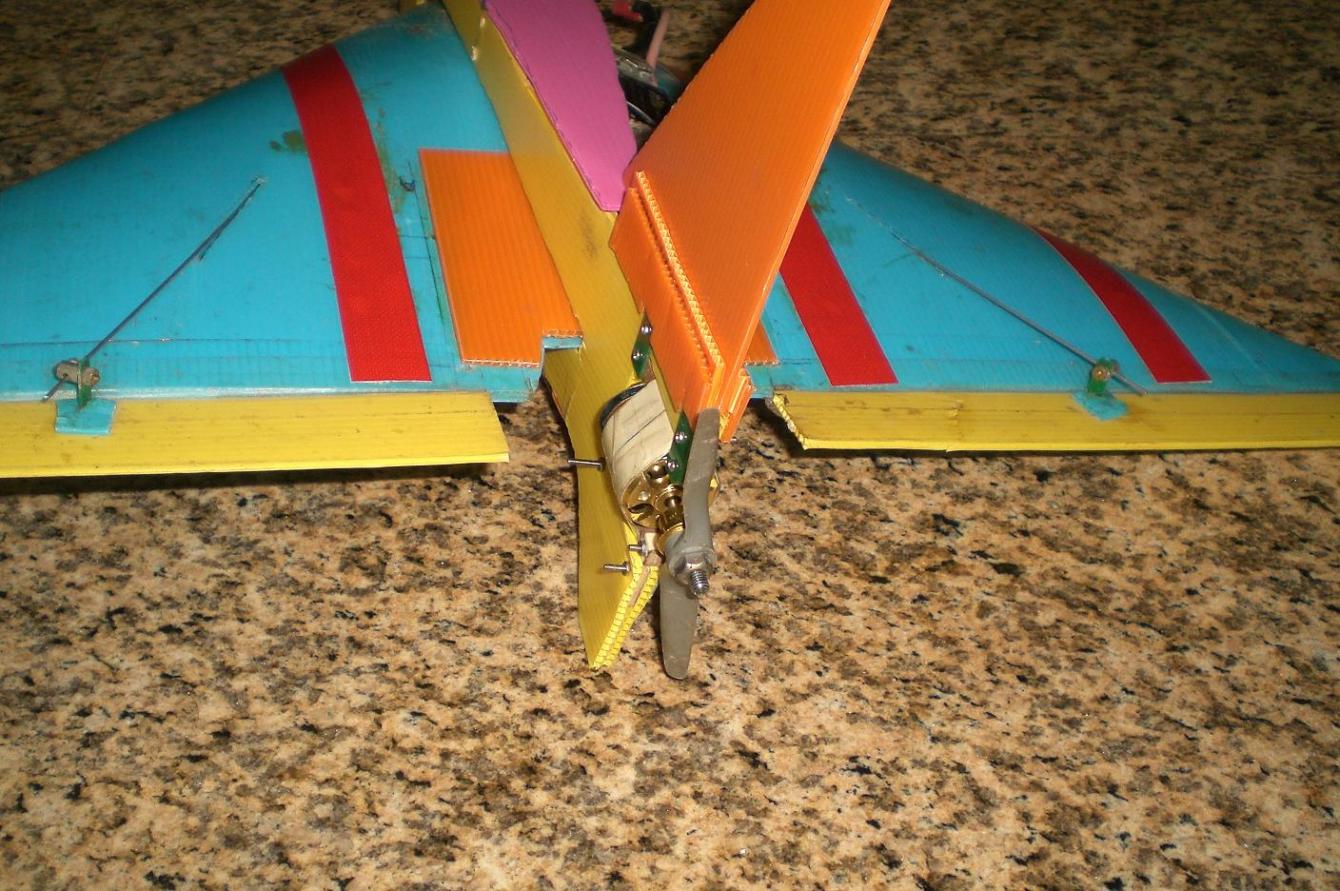

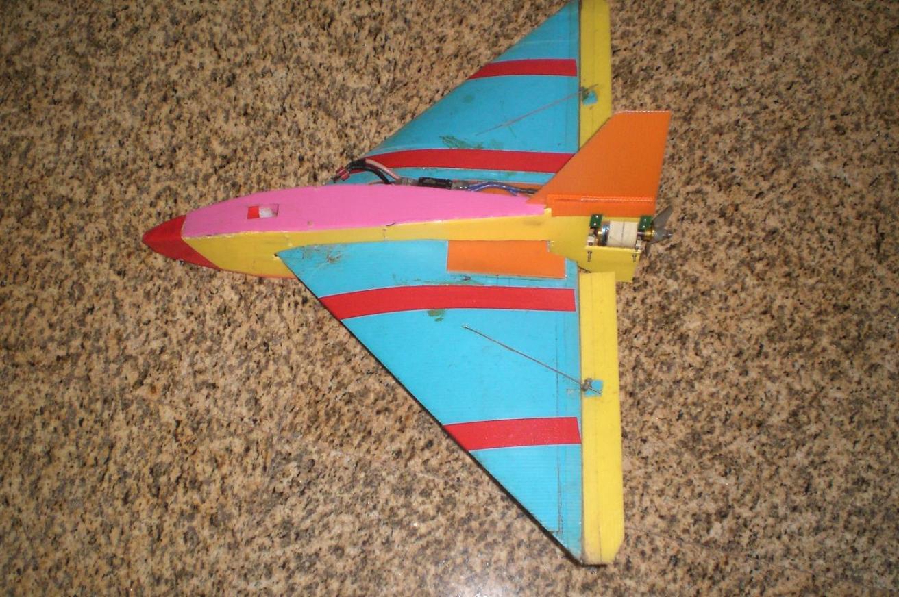

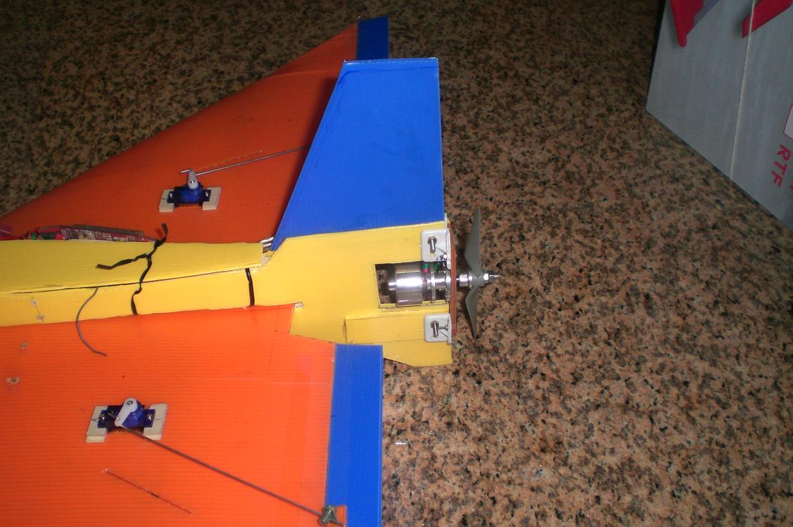

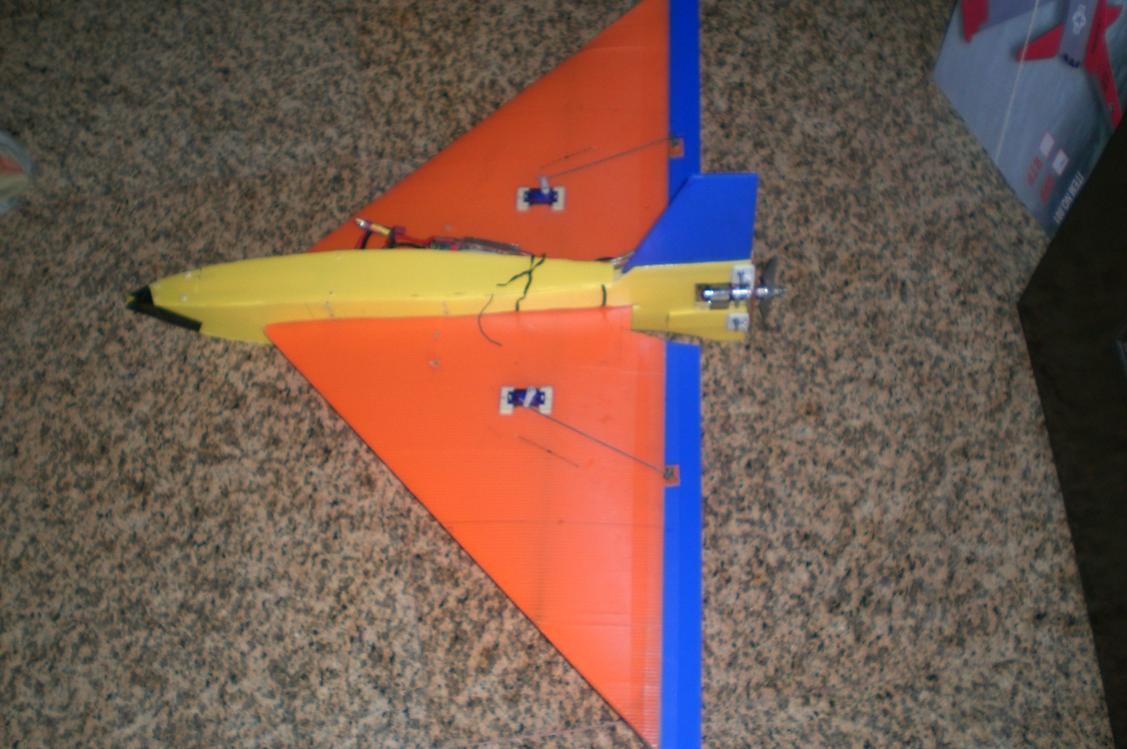

                    Nice, here is my un-original mugi. Its a single fin. It has less drag than the twin fin setup.
                    It flies very fast so much so that at high speed the control become sluggish. I found out that at high speed, the force generated to the surface control is bending and warping the control rod. 2mm hollowed carbon rod added to stiffen the control rod(i hope will fixed the problem) . Spacer was added to both the left wing so that the airfoil came out symmetrical after folding.
                    You won't find this feature on the original mugi

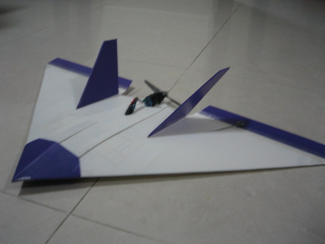

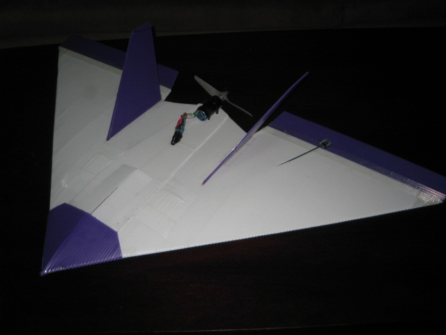

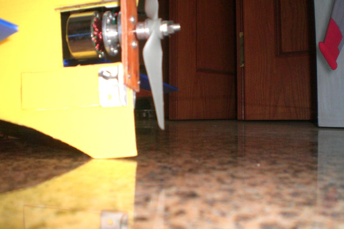

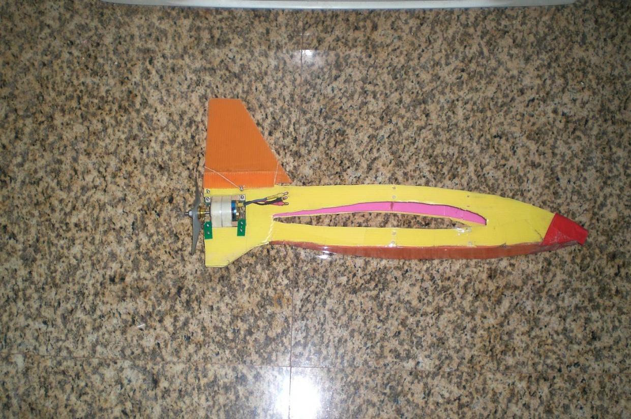

                            New Mugi with differences
                            Here is my latest coroplast mugi . It has undergone tremendous transformation.
                            Hope to maiden today if the weather remains good.
                            Its wingspan is 80cm and runs on 4s lipo with a 4.5x4.1 propeller.
                            Its main feature is the single fin and a generous keel to prevent the propeller from striking the hand or the ground during landing.

                              Manage to maiden the mugi this evening. and here is the video.
                              Tips view and set your PC to full screen.
                              This Mugi is fast because of the lower drag , since single fin vertical stab is deployed.
