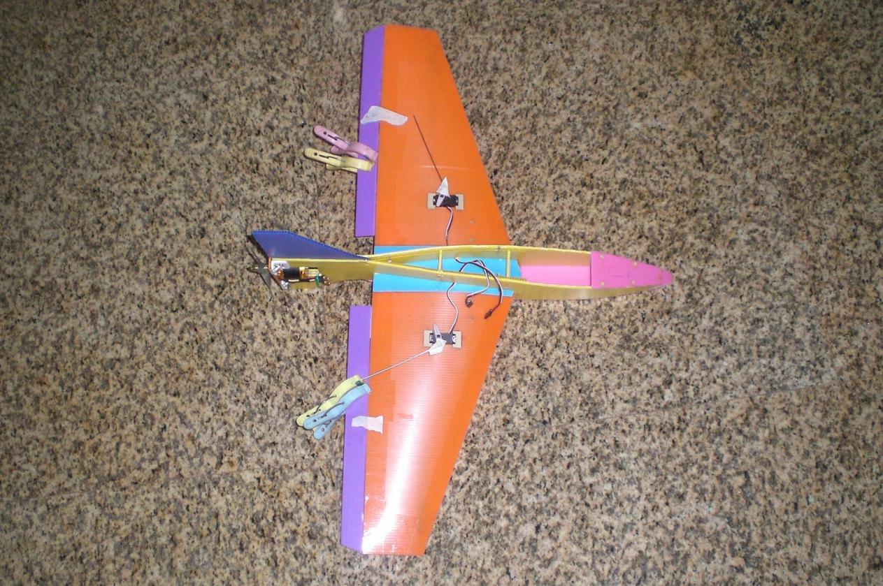

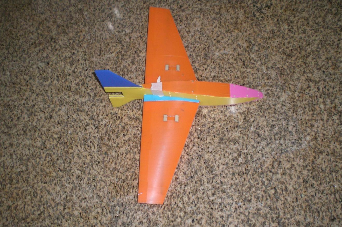

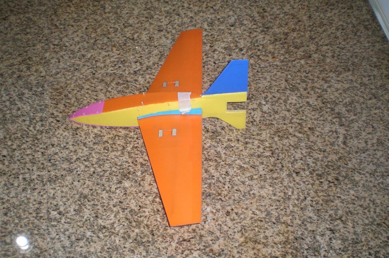

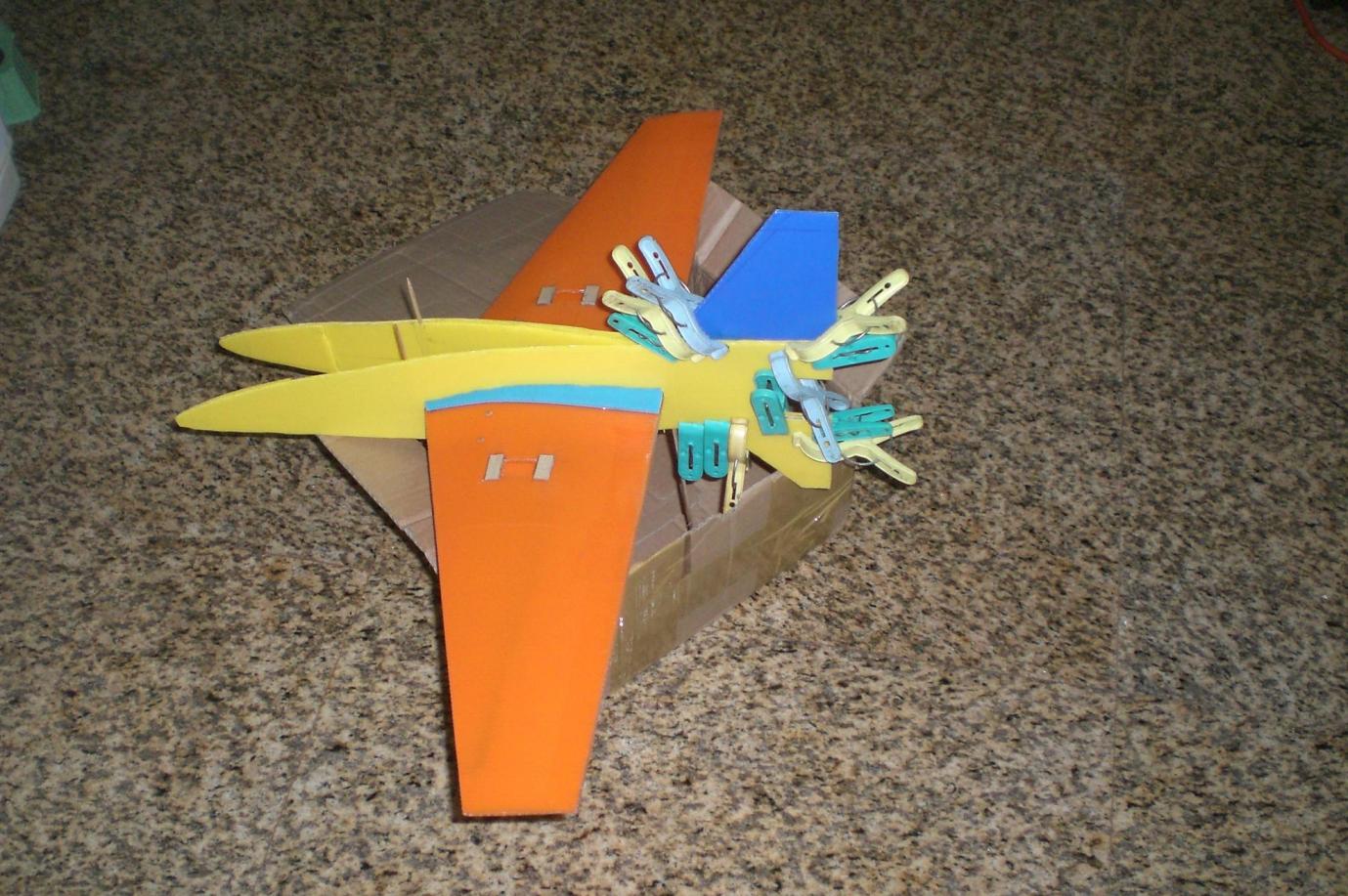

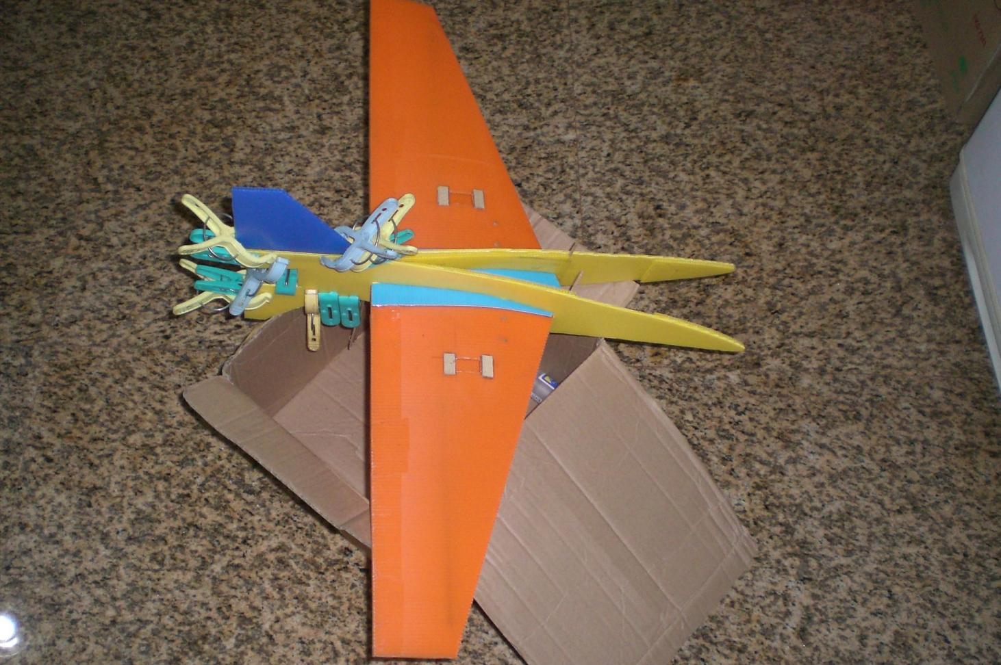

                Hi ,here are the picture of the scratch build coroplastic aircraft in various stage of completion. Aircraft is almost near completion.
                Now waiting for the glue to dry.

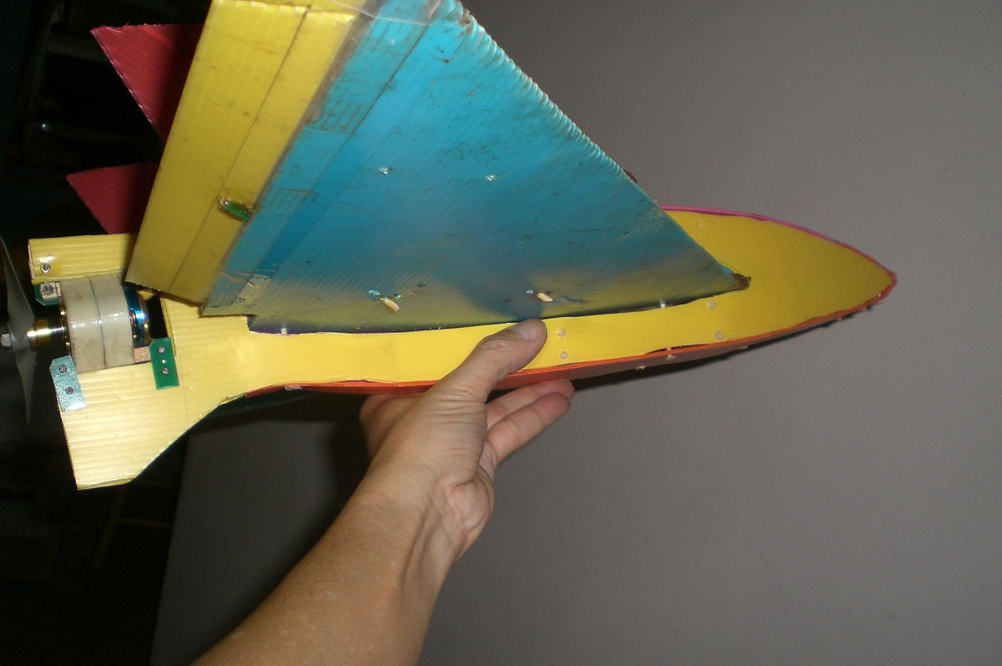

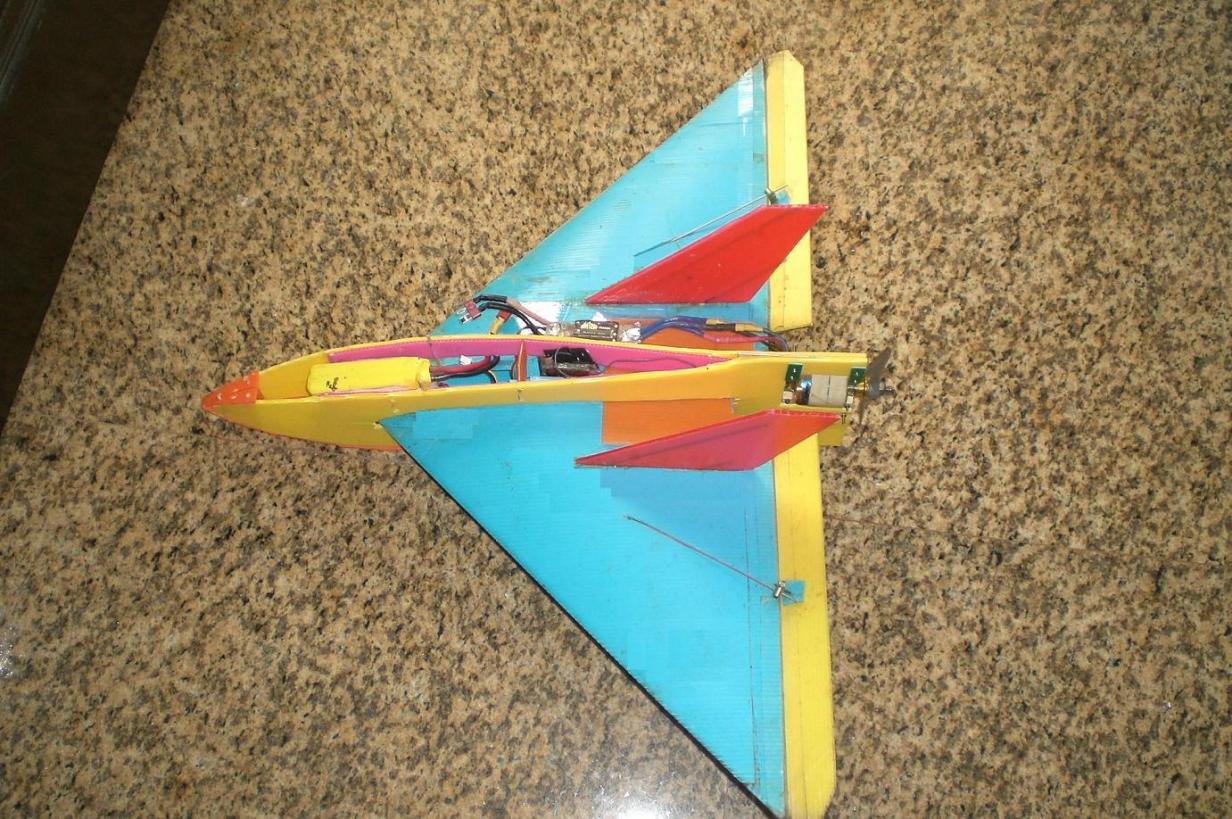

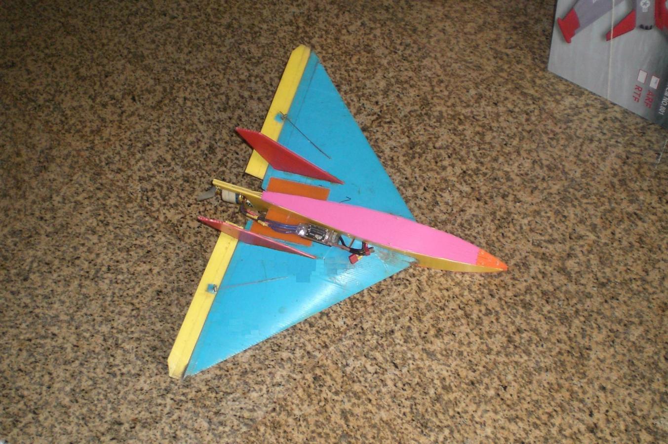

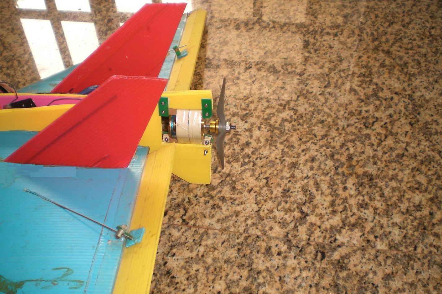

                              Mugi modified with propeller guard
                              My friend got his hand nick while launching the mugi . Fortunately on low power and the cut was minor. This has got me to think how to modify the mugi and made it safer to launch.
                              The mugi has a complete face lift with fuselage.
                              The Spine and exo-skeleton is removed and in place a fuselage with some degree of aerodynamic lift.
                              RTF weigh with battery 1750mah 3S =464gm
                              Advantage:-
                              1) A keel added at the bottom of the fuse so as to minimised the propeller striking the hand or the ground during launching and landing respectively. Act as a propeller guard.
                              2) Keel improved certain degree to the vertical stability
                              3) Fuselage allow plenty of room for battery to get the correct C.G. location.
                              4) The extended nose and added fuselage makes the delta looks appealing more important increase lifting area of the entire aircraft.
                              Here is the picture .
