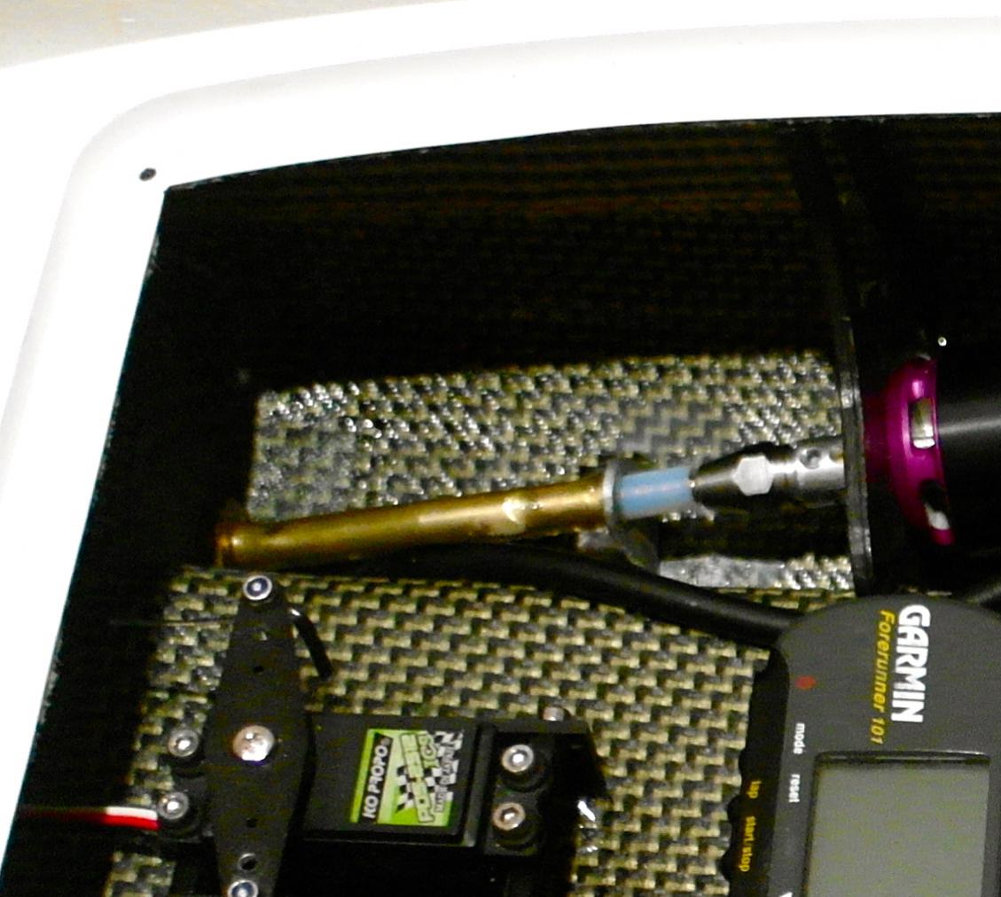

                        [ATTACH]107717[/ATTACH]
                        More done today.
                        Just some observation not criticism , it seems as thou to me maybe because my poor eyesight? that i did not see supportive plates for the brass tubes? it will be needed IMO to keep the brass tubes sturdy. A three point supportive plate will be the structurally sound to keep away nasty vibrations during runs
                        considering this is high-powered application
                        a battery tray with adjustable CG base will benefit if those were included. On a side note, i love the unique sandwich box you made for schuzles . they look 5mph-8mph faster just sitting there.
                        Warpath Wong
                          Both have at the end of the brass tube.
                          Should be good enough as the hardware is perfectly aligned and installed by HansPeter. Remember it is a SAW set-up, just 2 + 2 passes and we are done.
