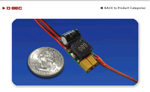

        As I reply in Runryder on your post, i suspect your ESC is getting too hot...especially the onboard BEC. Are u using any external BEC? If not, plz get one.
        In a confine/surrounded scale body, there is no moving air inside and thus the electronics tend to get hotter (so do your motor)

            Well, there are alot of brands and model of external BEC. Just ask for a BEC in any local hobby shop. Preferable to get a Digital switching (sometime they called it UBEC) type of BEC.
            Get at least 3A with either 5 or 6V.

                Hi luvmykids2
                Sorry for late reply... here is one of the digital switching BEC:
