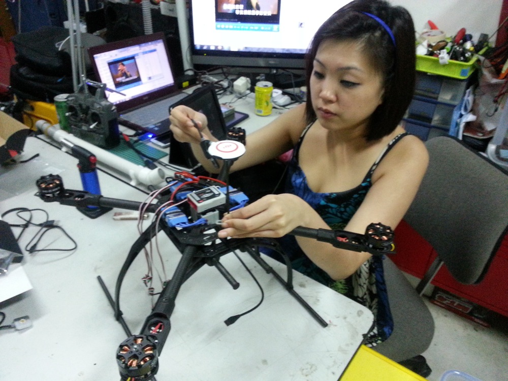

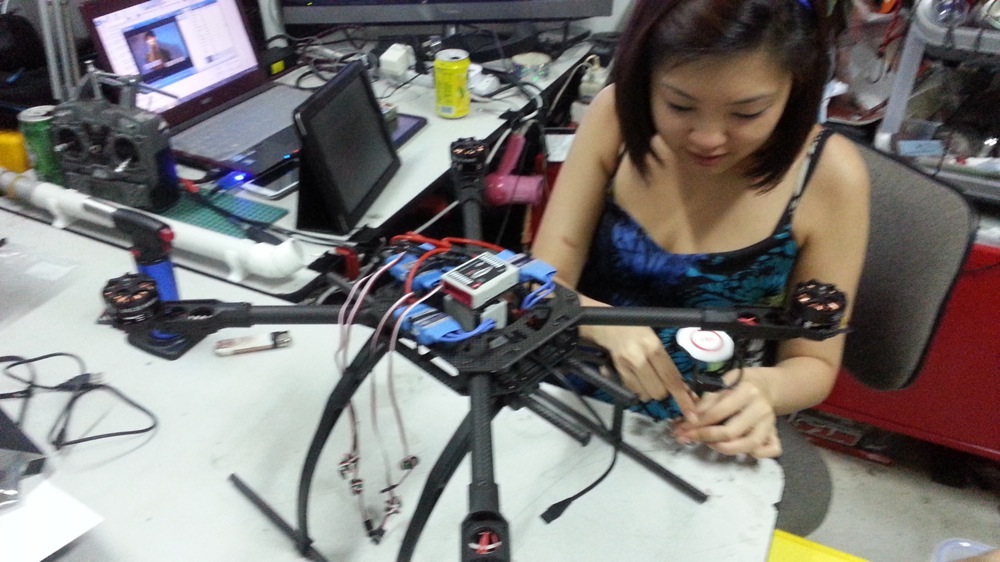

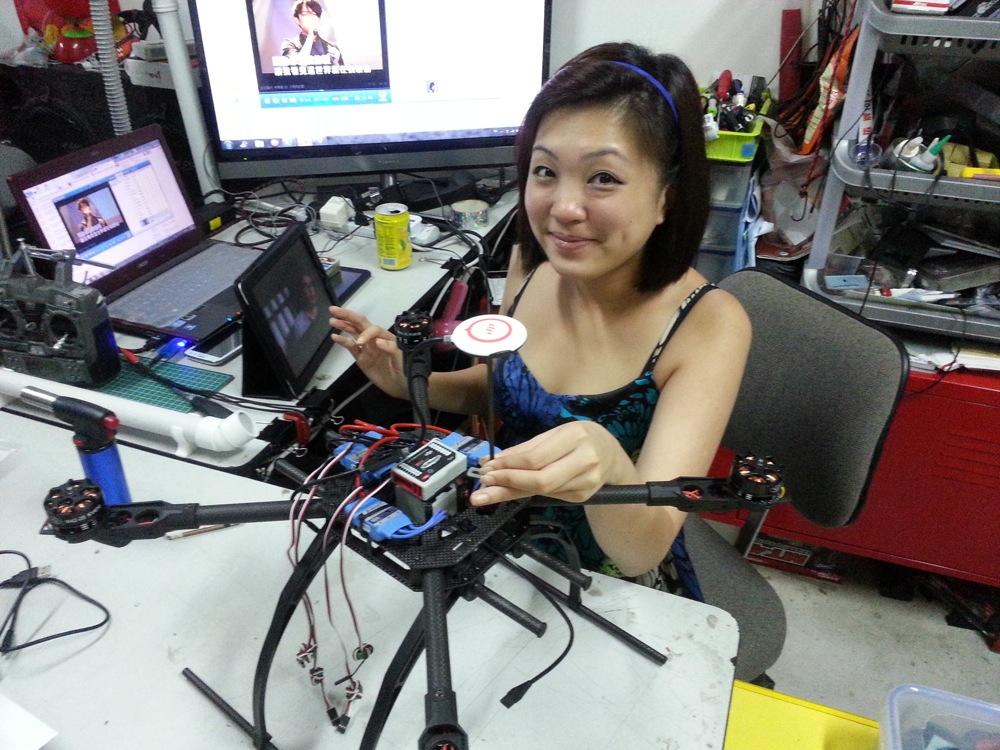

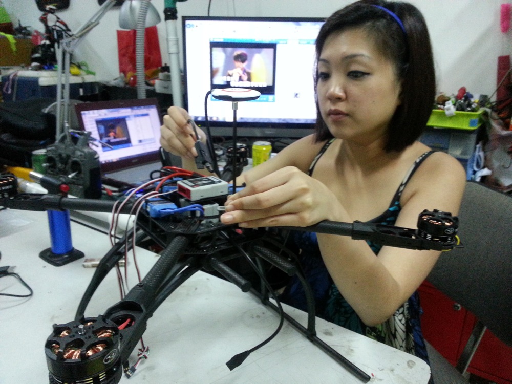

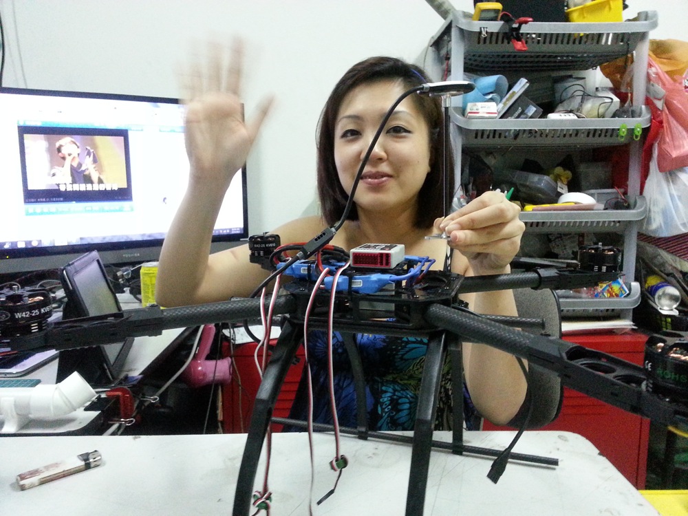

Yes, the number of girl flyers are few and far...but they do exist. Some of ladies I know does pretty aggressive 3D on their helis...but they have since switched over to gentle flyers - and quad flying more recently. So gentlemen, take note...this is not an all-male hobby. I wonder when will daddyhobby have a 'mommyhobby' spin off?Originally posted by TWE75 View PostWow pretty girl , now that's one more reason for more guys to go into quad lol just joking . But seriously , i've never seen any female into heli or quad before , seriouse . Esp when quad needs so much technical knowledge .
