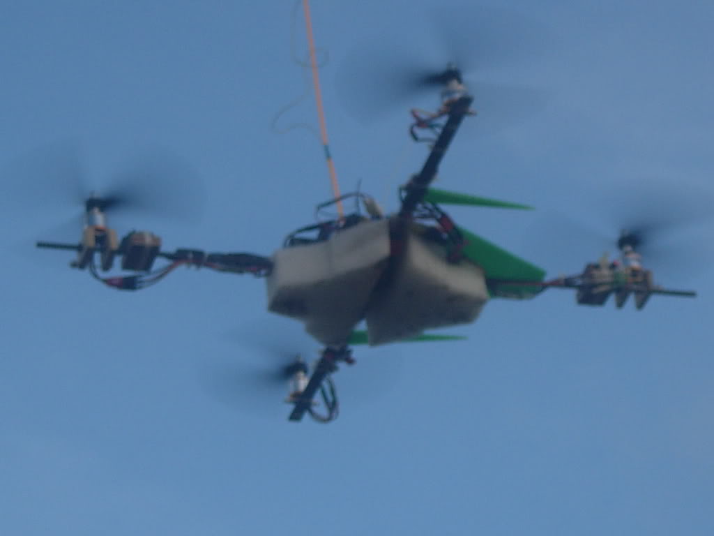

    Hi,
    Made the transition from 3 rotor to 4 rotor with the help of a fellow forumer at www.rcgroups.com :
    Regards,
    Joe Ling

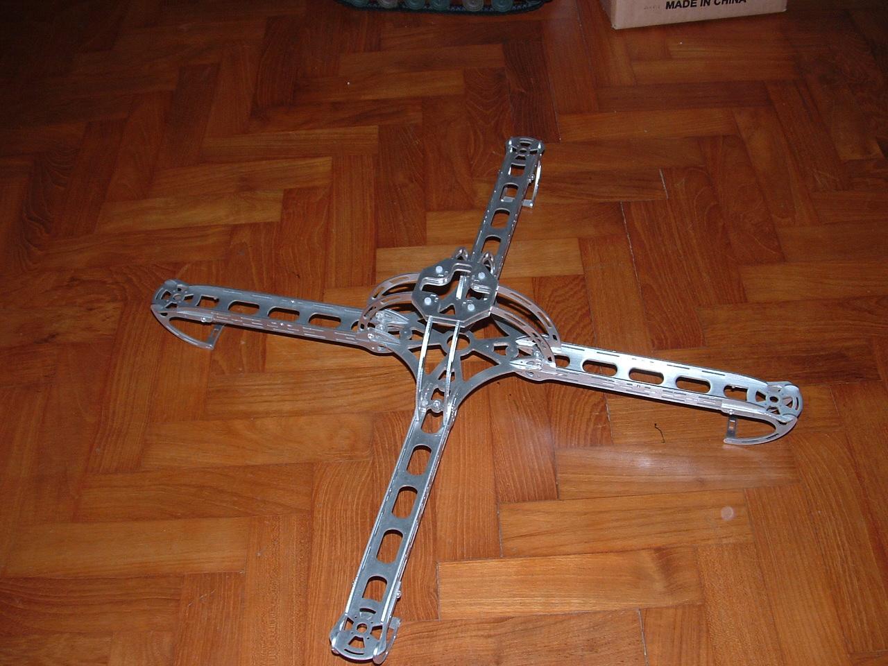

                  My frame...
                  Cool ! Did u get this from Nicoleto or did u fabricate this yourself ? I tried to order a complete set of UAVP from www.lipoly.de but did not get a response from them. I guess they are not interested to do business with me. However, I'm still keen to either build a uavp or mikrokopter. Would u be able to point me in some direction to acquire a frame similar to the one u have ?

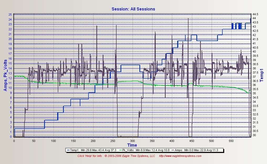

                          Hi,
                          Finally did a little datalogging on this thing.
                          What this shows is that my 2200mah battery is only good for 1888mah & about 8 to 10 minutes of hovering.
                          It needs about 13A to keep itself afloat !
                          Regards,
                          Joe Ling

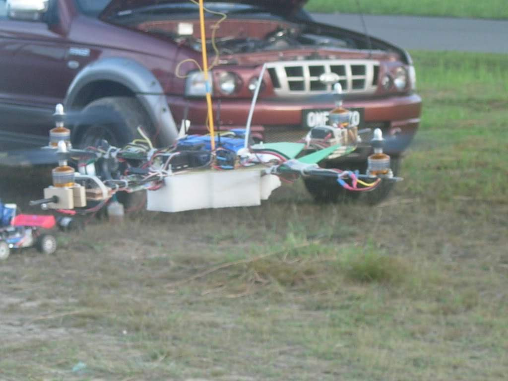

                            Hi,
                            New vid taken over the weekend !
                            Regards,
                            Joe Ling

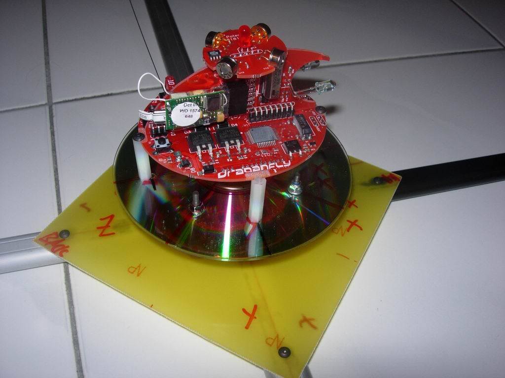

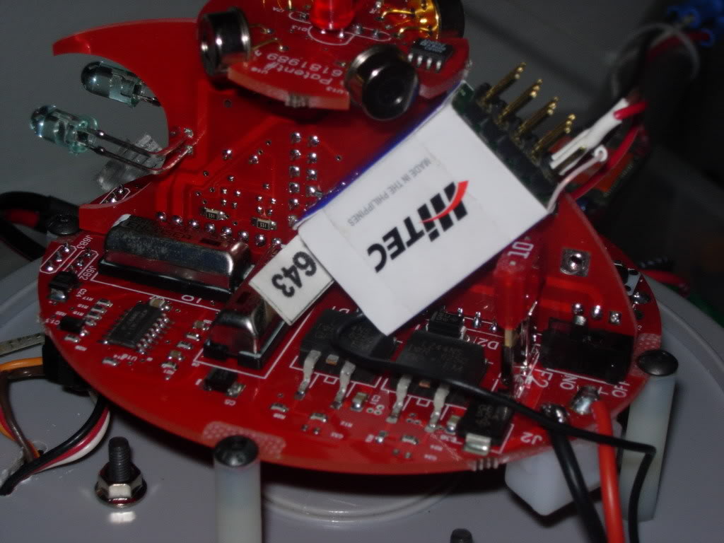

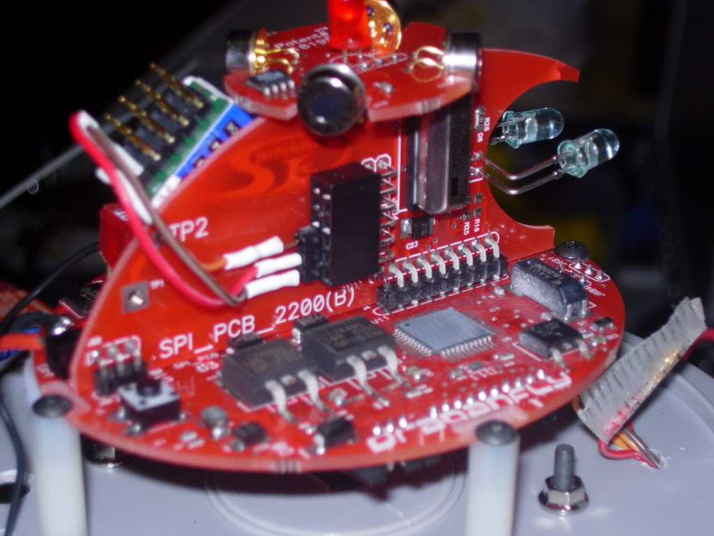

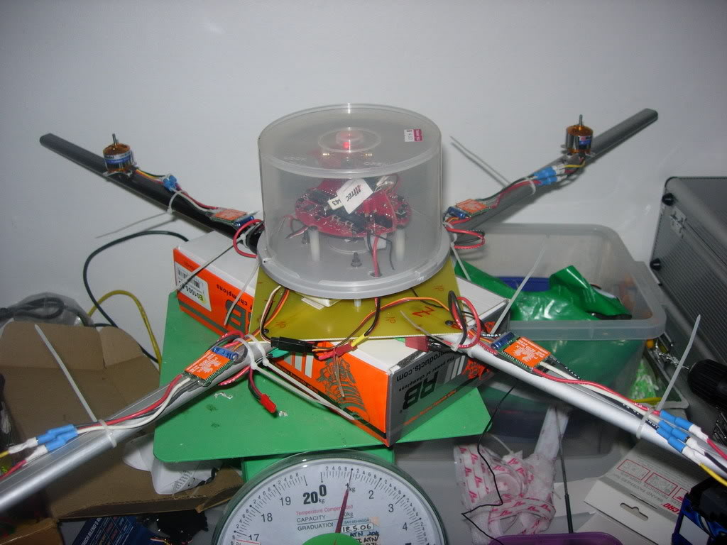

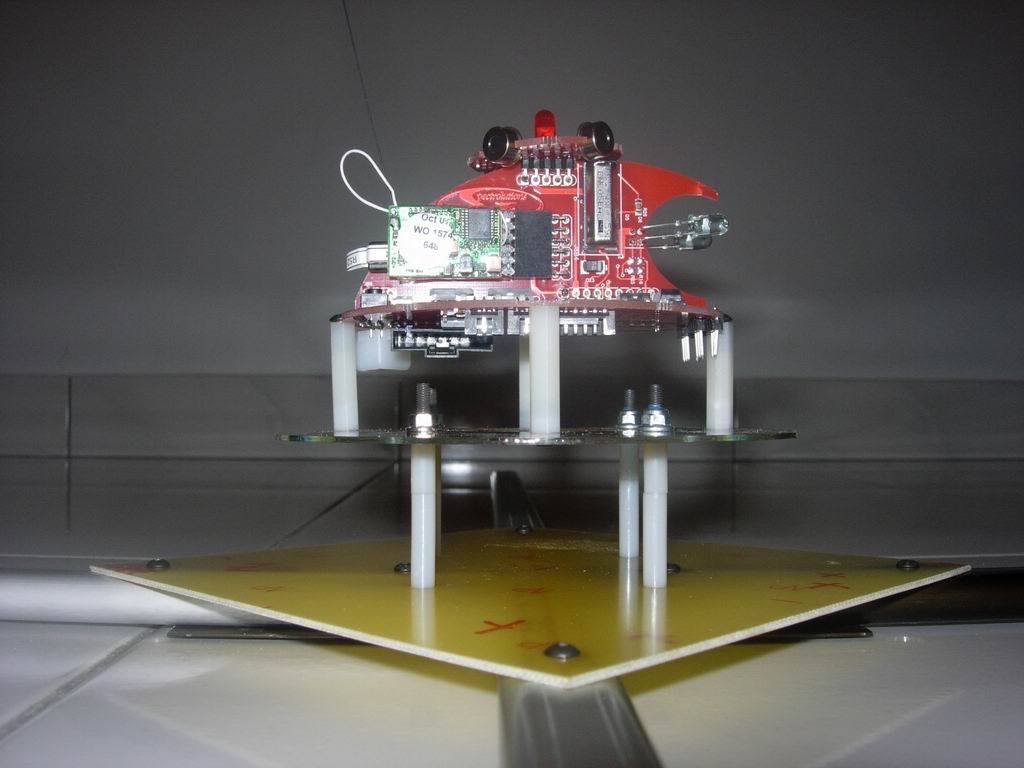

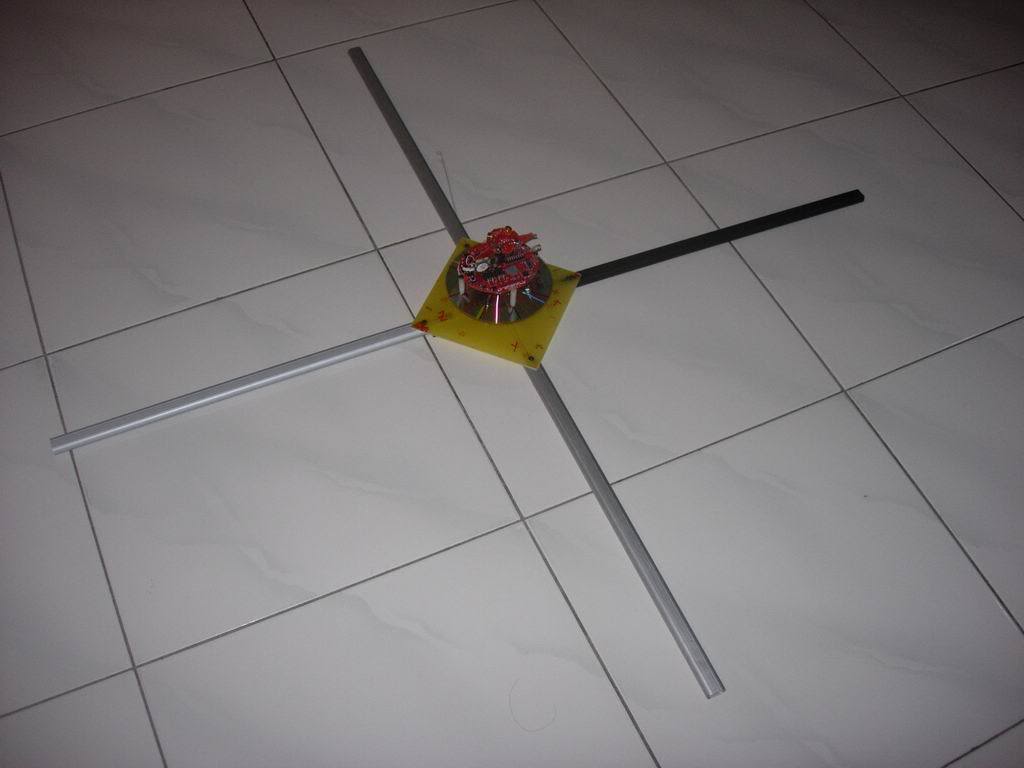

                              Hi guys,
                              New quad wip. Frankenstein son of the draganflyer :
                              Regards,
