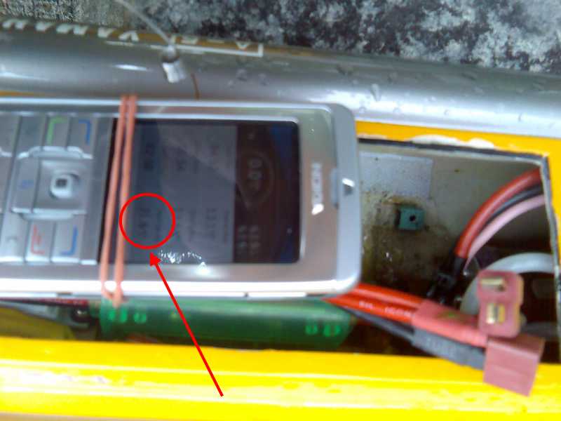

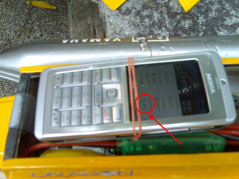

          Ran it tis morning with the following setup and clocked 31+ km/hr on Garmin GPS. Pics unclear, hp camera + reflection.
          JH Yamaha
          - stock prop(42 x 1.4), shaft and rudder
          - Feigao BL motor 7L 3500KV
          - Himodel 100A ESC
          - DN 2150mah 20C lipo on 2S2P
          Max amp draw on watt meter - 64A
            JH Yamaha
            - Himodel 100A ESC

              The boat is not tuned yet and only running at 3/4 throttle. If full throttle, the boat is practically uncontrollerable!!! More tunning needed. The boat is also running very wet, cause the feigao motor is heavy. Thus the whole boat's hull is sitting in the water during the run. Never brought pilers to adjust the trim taps. In fact the motor is still cool after the run, the witness were also there to touch the motor. Quite surprising.
              I believe it is capable of higher speed but due to newbie pilot n not tuned setup so only 31km/hr.
              By the way, the deans connectors fused together after another run which I pushed it to full throttle, 94A max recorded in the watt's up meter. Need to re-solder with bullet connectors to try again next Sat.
              Hope to get it rite for the upcoming race and up to the speed of a SV27 stock setup which was 30-35mph range.
