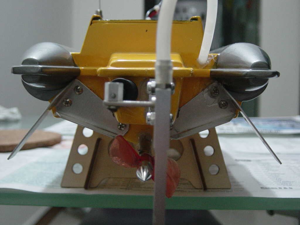

                          Juz tried wif turn fins tis afternoon. They were great!!! However currently still on brushed motor. Waiting for my BL motor.
                          Ran brushed 540 motor on 2S2P, no problem at all. Clocking 26A max n abt 198Watts. Lasted 10mins.
                          Ran brushed 540 motor on 3S2P, motor chao tar within 2min 40secs on Tx. Clocking 44A max n abt 400+Watts on the 30A brushed ESC. Fishing rod was put to good use. There goes another brushed motor.
