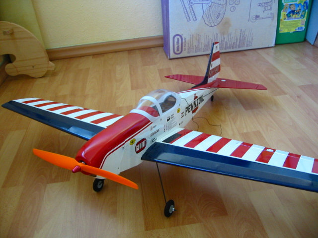

                        #56
                        Originally posted by protyne
                        Time to do balsa HDB!
                        Try this!

                            #58
                            Originally posted by msc
                            Try this!
                            hyperion chipmunk???
                            Powder, Anyone????
                              #59
                              No, this is the cheap version from world models.
                                #60
                                Chipmunk? Nah. AM is clearing my bowels fast enough
                                Taking my time. There will be a time for it
