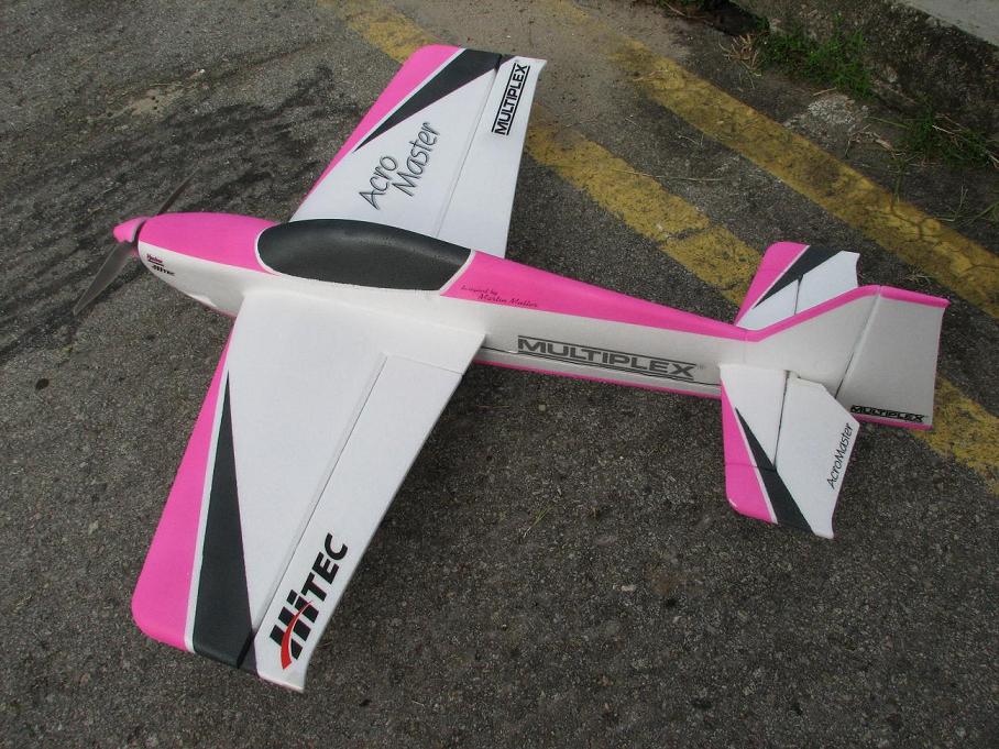

            1. I have recently built an AM with bob smith 10-25sec extra thick CA. Works really well without any kicker used.
            2. The only place i've reinforced is the inner side of the nose area. I've used 1oz glass cloth to glass the inner surfaces at the nose. There is a weak point around that area so glassing it may be a good idea. It's mentioned in the rcgroups AM thread as well. You can read up more inside.
            3. Yup the original hinges are good enough for anything you throw at it.
            Here's a pic of my AM

                Oh, forgot, your plane colour and design looks cool! I intend to use Pink too

                        wow, madflurry's AM takes the cake for the nicest looking AM in sg now I think.
                        Great PINK
                          Great PINK
                          Of course he has to make it look nice, it's the last one from NTC of the current batch. Has to make it look good.
