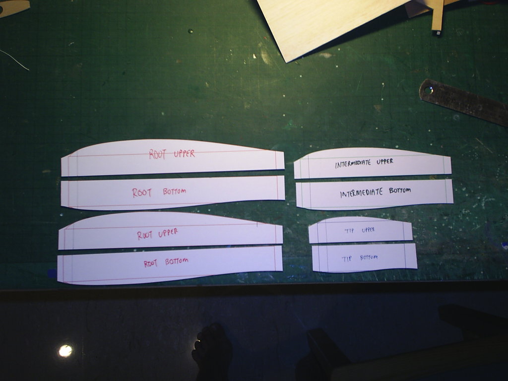

      For long thin foam wings requiring joining like you said, if I only have the tip and root template in hand, is there a way to extract the middle template from these to do foam cutting?
      Thanks!

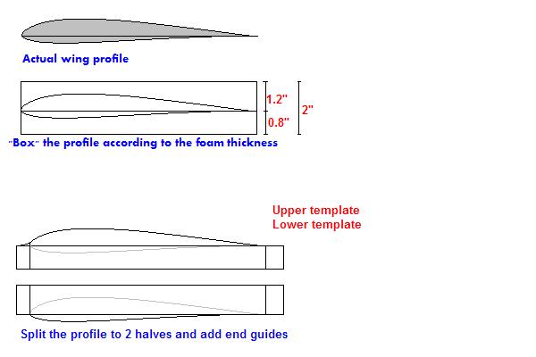

      Cycross,
      I always use Autocad to draw the templates after importing the profiles from Profili. As such, making intermidiate wing templates is always possible at any wing station.
      For such thin wings, you can't use a single full template at each end. The templates will be far too thin to stay properly pinned. It is also not practical as the template will be too flimsy.
      For each end, I split each template to 2; that is upper and lower halves. The lower template will have the upper wing surface cut to shape and and upper will have the wing lower surface cut to shape. You must consider the foam thickness you are using when making the templates.

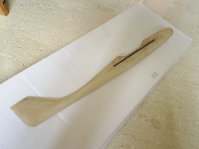

              Too early to tell. This is my first attempt of moulding a racer fuselage. Dunno how it'll turn out though.
                #97
                After dissolving the foam by pouring thinner, the fuselage is true revealed. The sidewalls were a still little soft and I laminated another layer of glasscloth internally to beef it up. So far so good.
                  #98
                  Well Done Joe...HAve you decided what color it will be??
