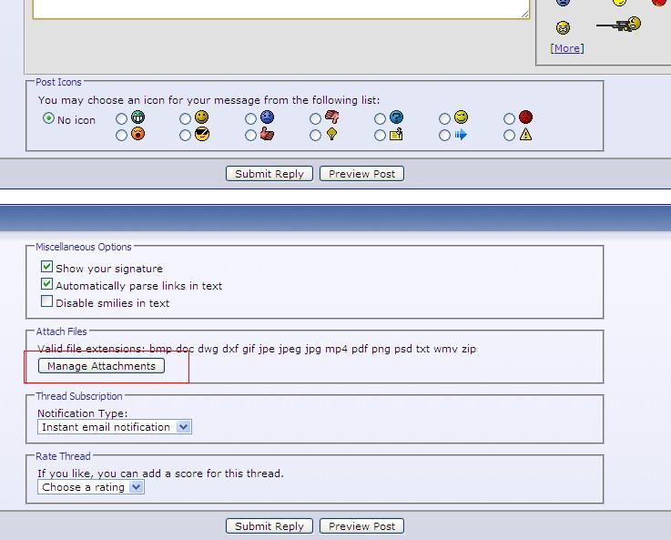

            Bro, when you reply, scroll down and you will see an area called "Manage Attachment". Click on that and you will have a new window opened to choose the file from your PC to attach.

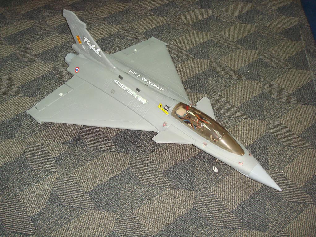

                      rafale

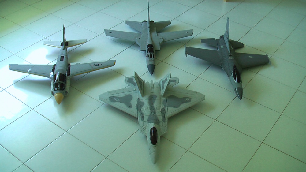

                        my kyosho "jets" collection

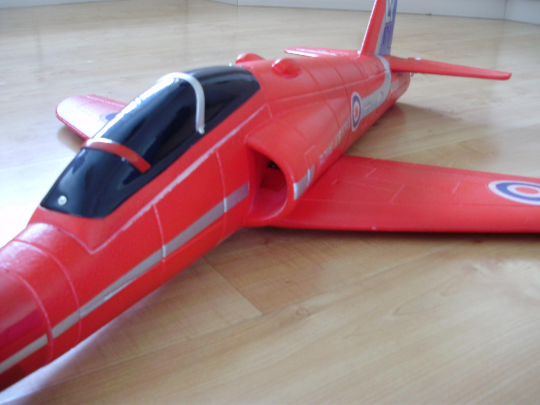

                          Accidental Acquisition
                          Accidentally clicked on the "BUY NOW" and acquisition realized.
                          This is my first EDF jet and has not been to the air yet.
                          Build experience is rather easy.
                          30A ESC requires wiring extension because it is mount to the rear.
                          Requires 2 X 9gm servos. No rudder.
                          I use Spektrum AR500 full range 5 channels.
                          Everything fit correctly with no trimming at all. One of the easiest plane to build and its EPO.
                          Some minor issues - In-Runner motor seems of lousy quality and has vibration not to my expectation at mid trottle. Coupling between motor shaft and 6-blade props is out of true. Require some rework.
                          Additional improvements - layered down the insde of the soft plastic nose cone with metal-epoxy. Slap on thick. Plane is very tail heavy and so using more epoxy won't jeopardize the C.G. In fact I think I need weights to the nose.

                            I had at least 5 nose dive till I know where is the CG(the CG point on the user manual is crap) and I also become a plastic surgery doctor for my plane..
                            A bad surgery doctor one cos I am still not able to restore the original shape after replacing the nose. Don't ask me how to fix nose...
                            Anyway.. who cares, fly up there nobody can see liao...
                            Got the same red arrow as yours.. care to share what's with the C.G. ? Instruction says 9 cm from edge of wing +/- 0.5 cm
