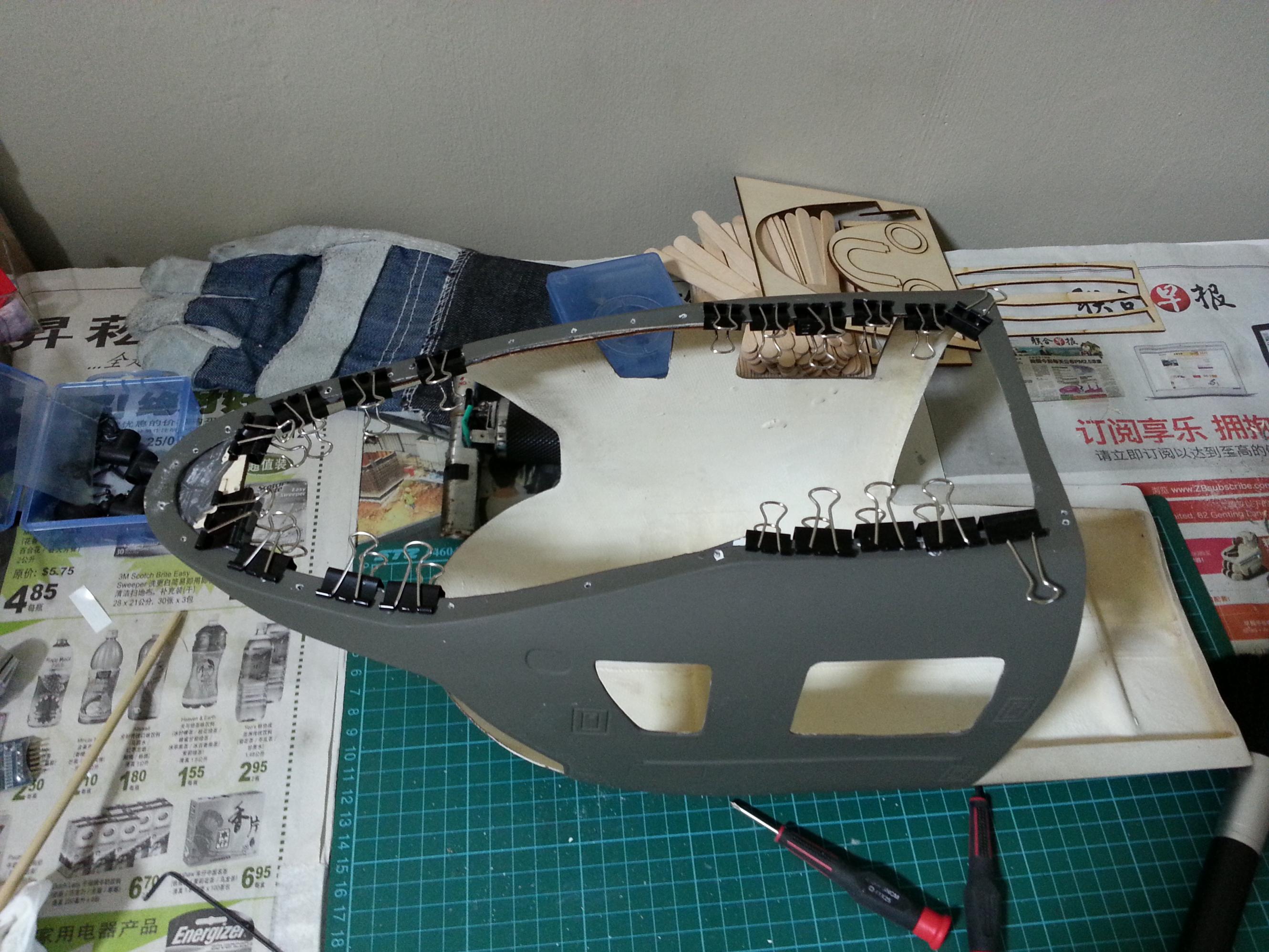

After keeping one 500 size fuselage for quite sometime, it is time to start building it.

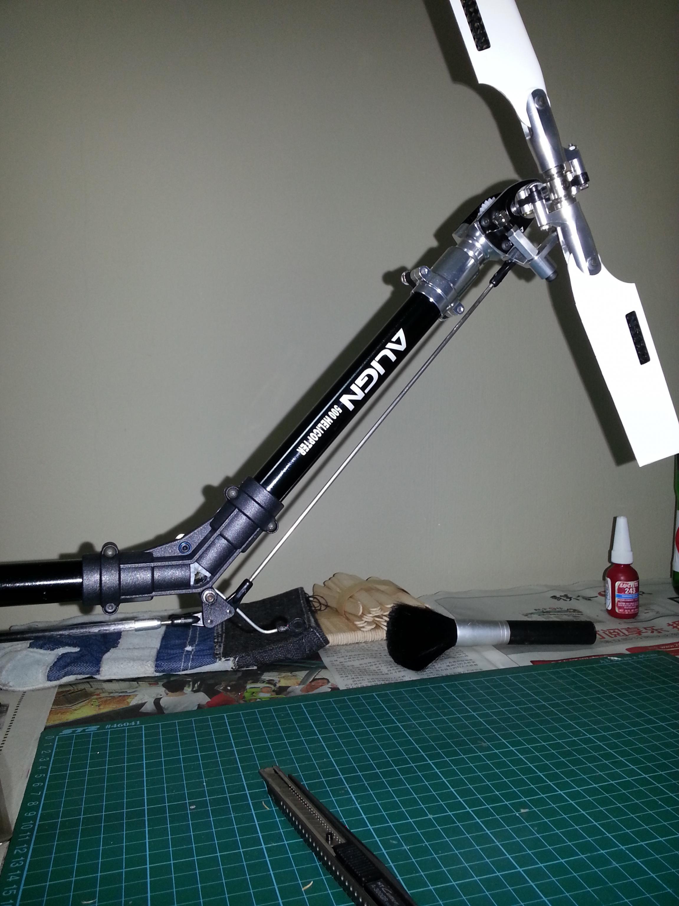

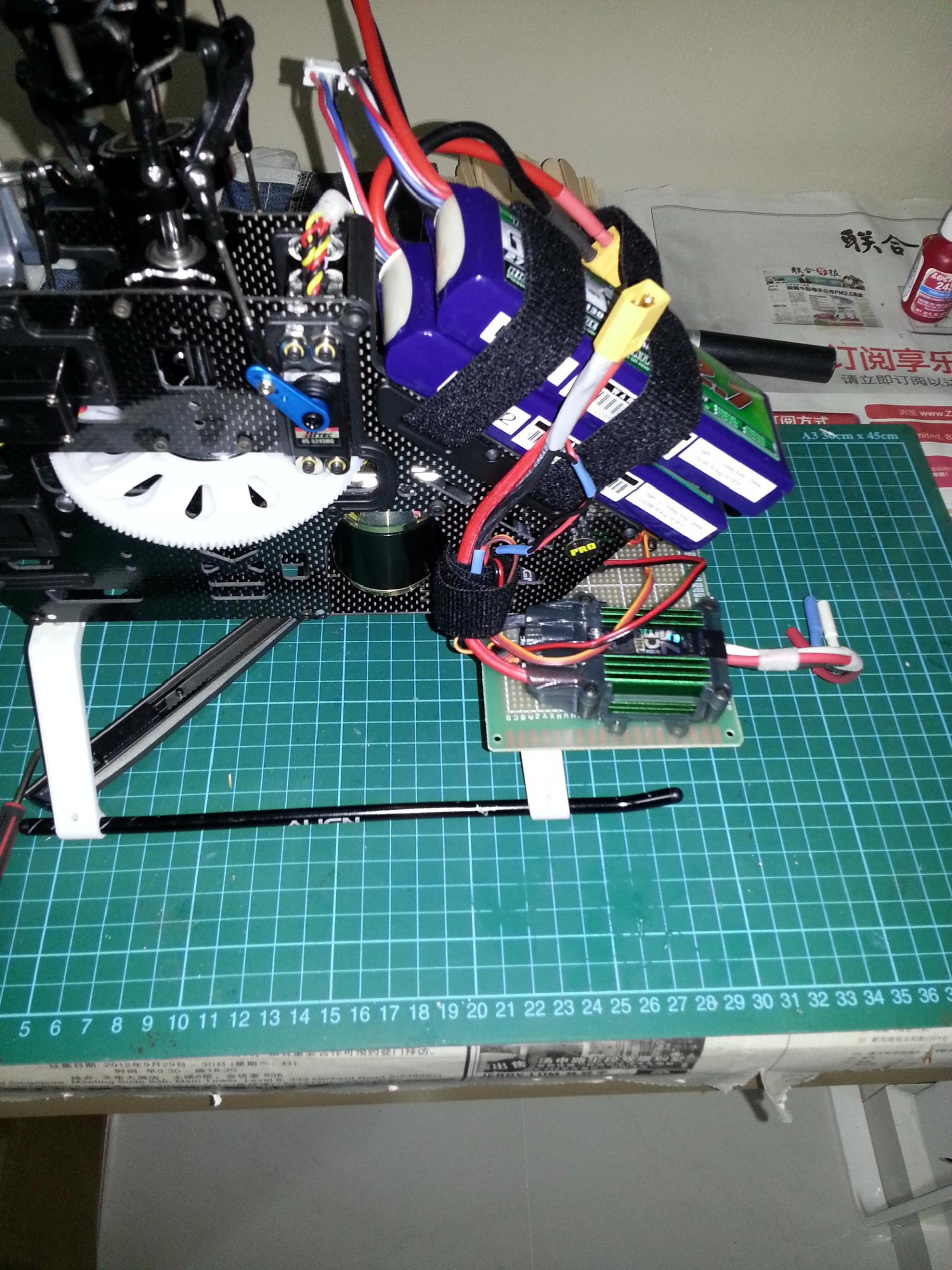

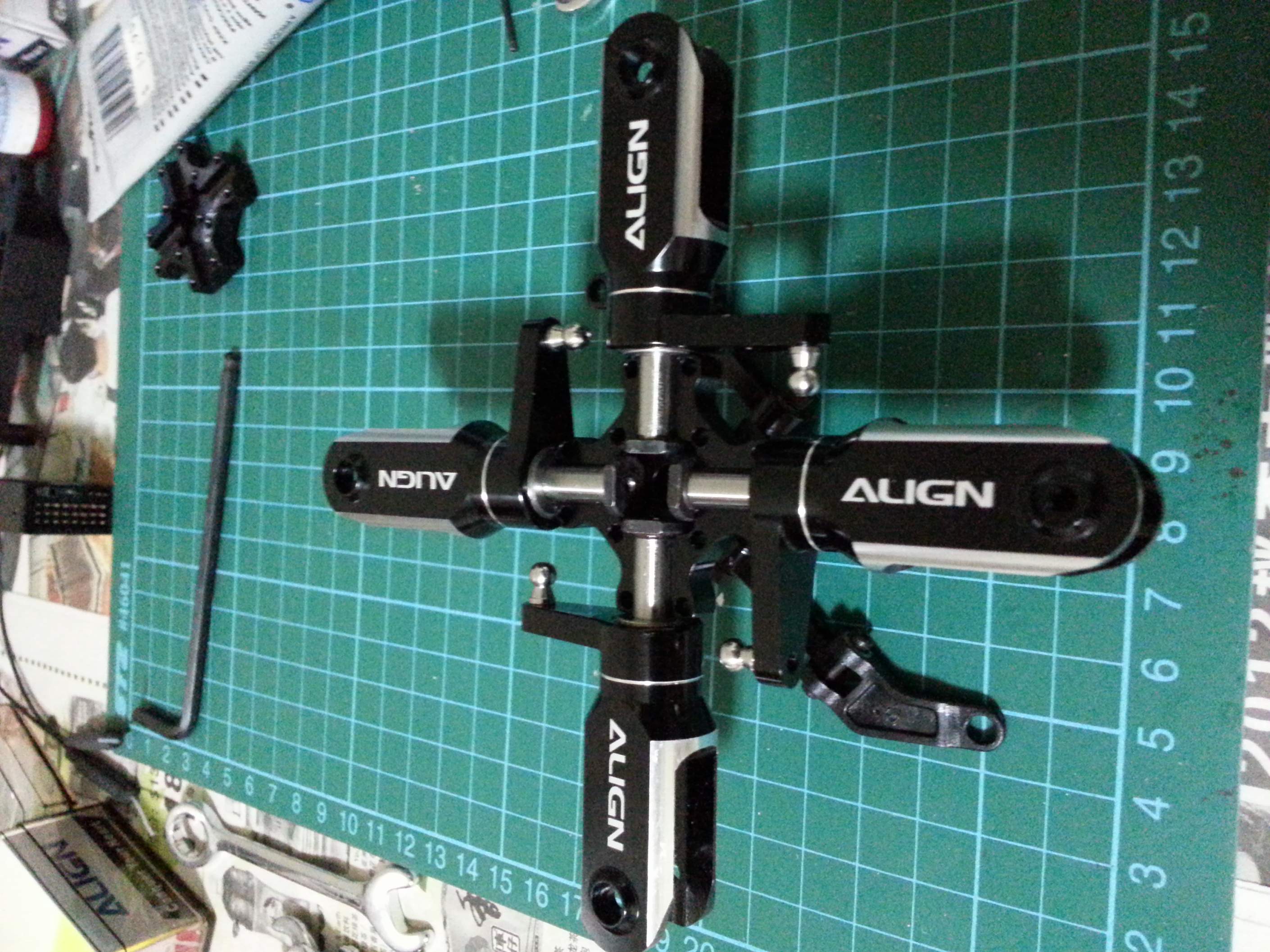

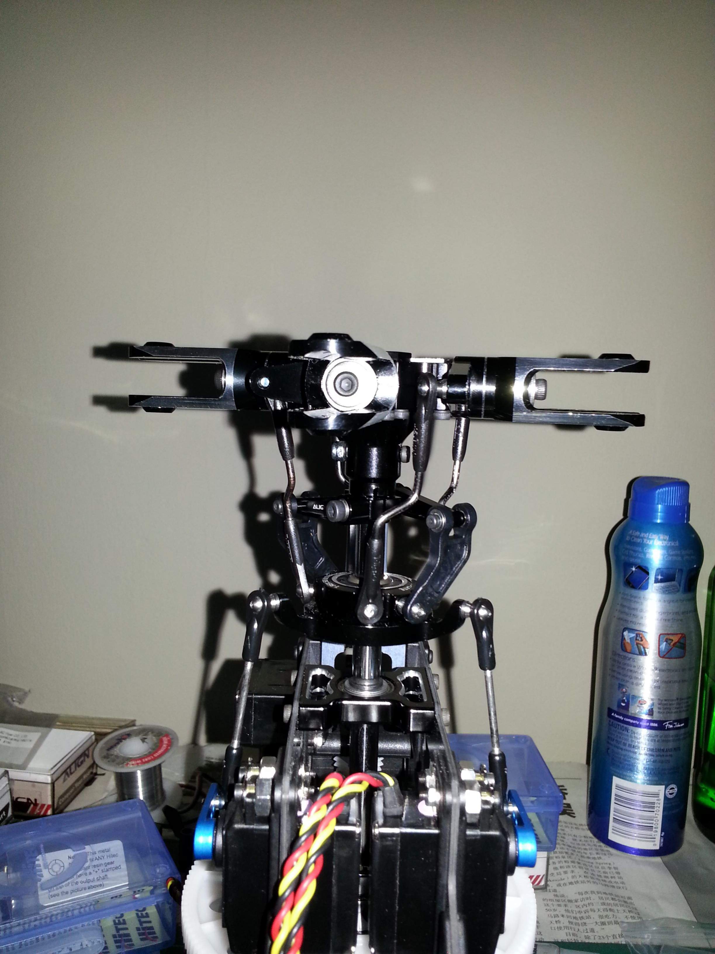

To start up, I decided to build using parts for TRex500 size, Pro version. This will be the 1st 500 size torque tube, elevated version.
Since TRex500's main rotor is default to spin Clockwise rotation, the real heli for the scale I going to build spin in Counter Clockwise rotation. Thus, I need to modify the one way bearing in 180Degree reversely.
In other word, knock out the one way bearing and fit it back in opposite position.

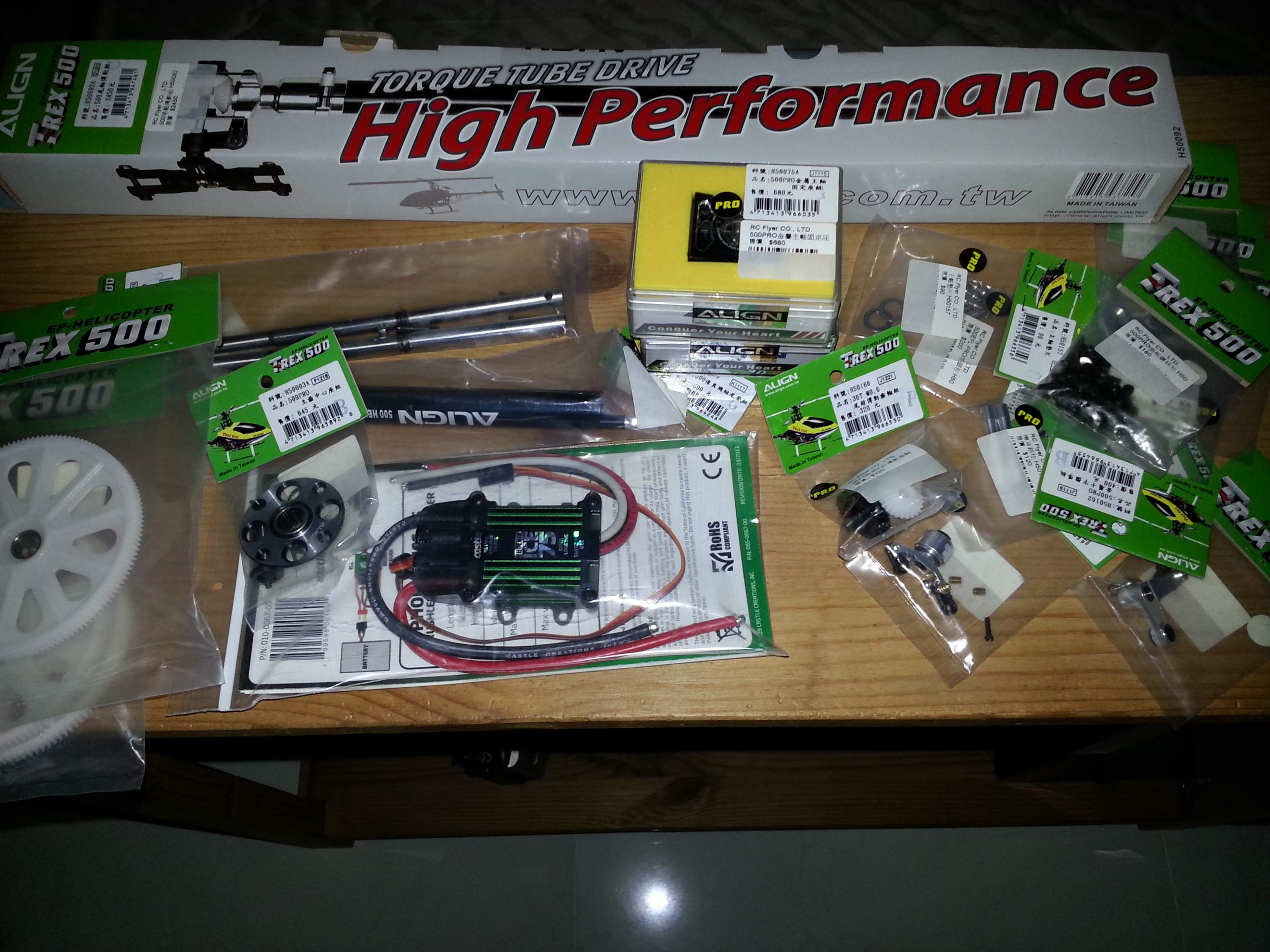

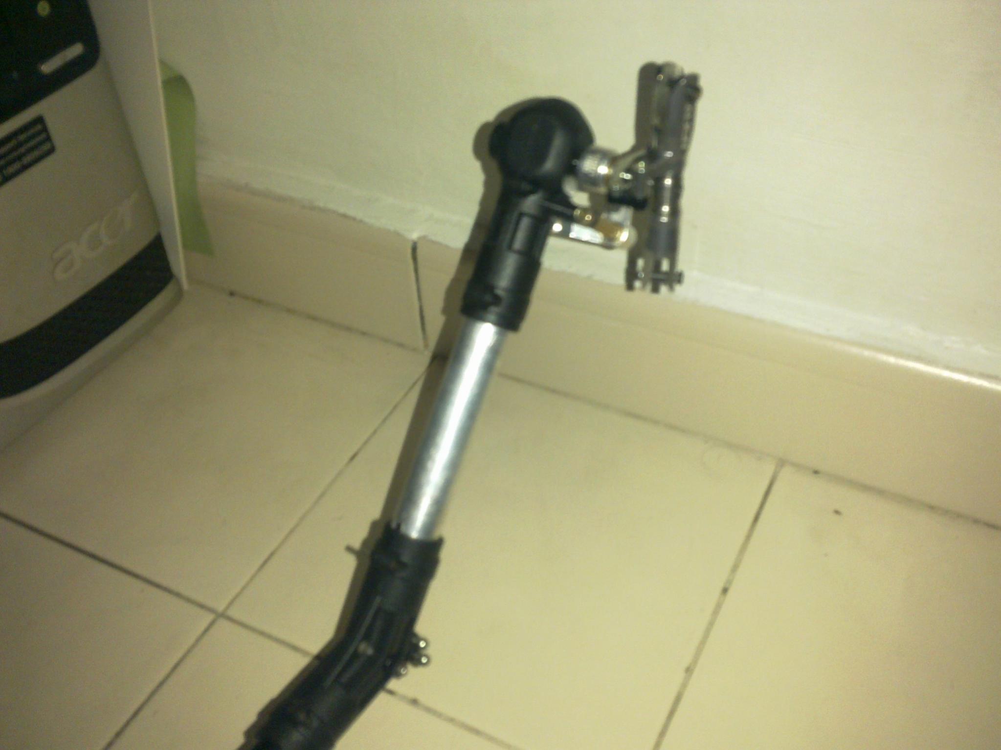

Obstacle #1:

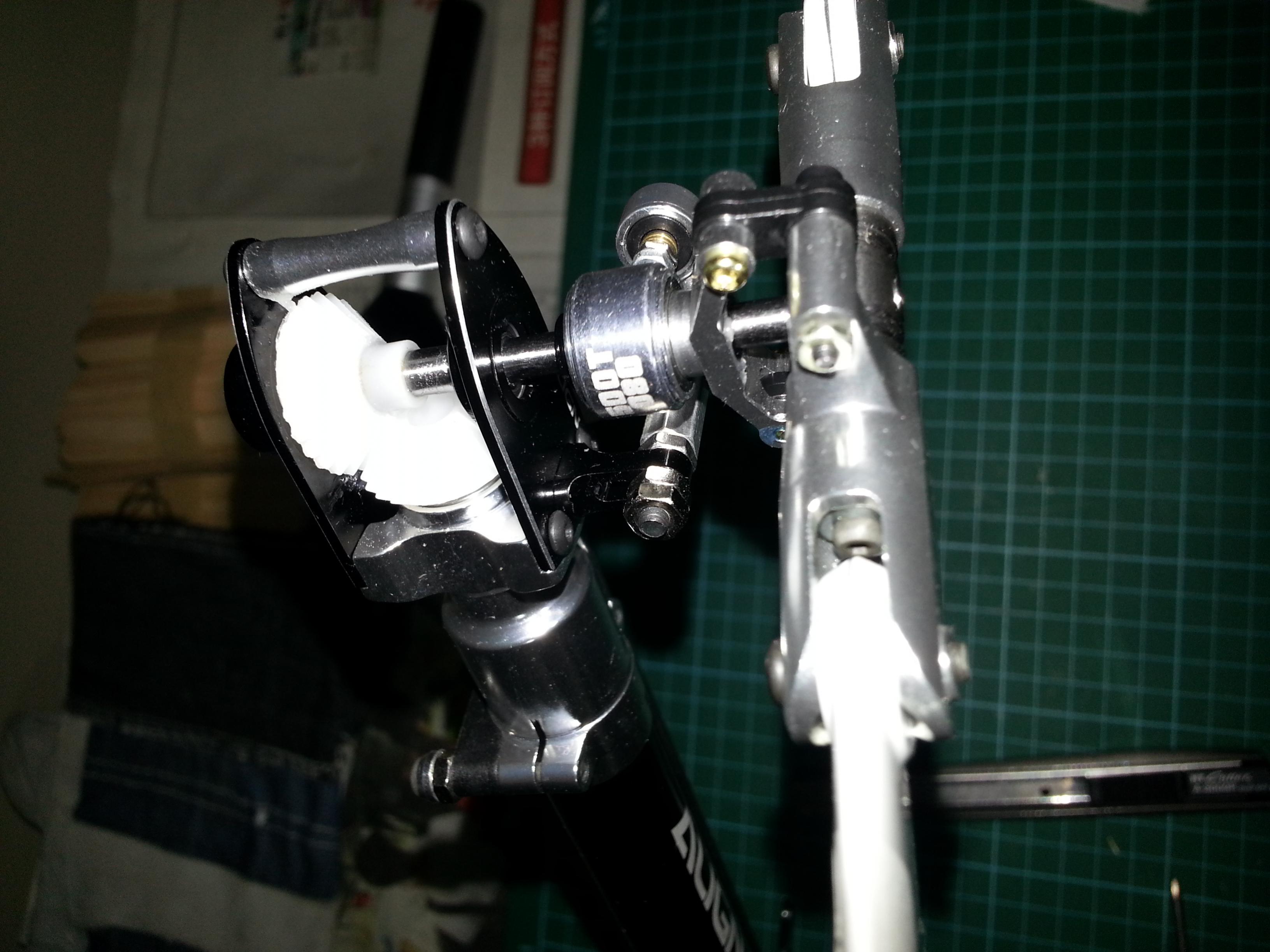

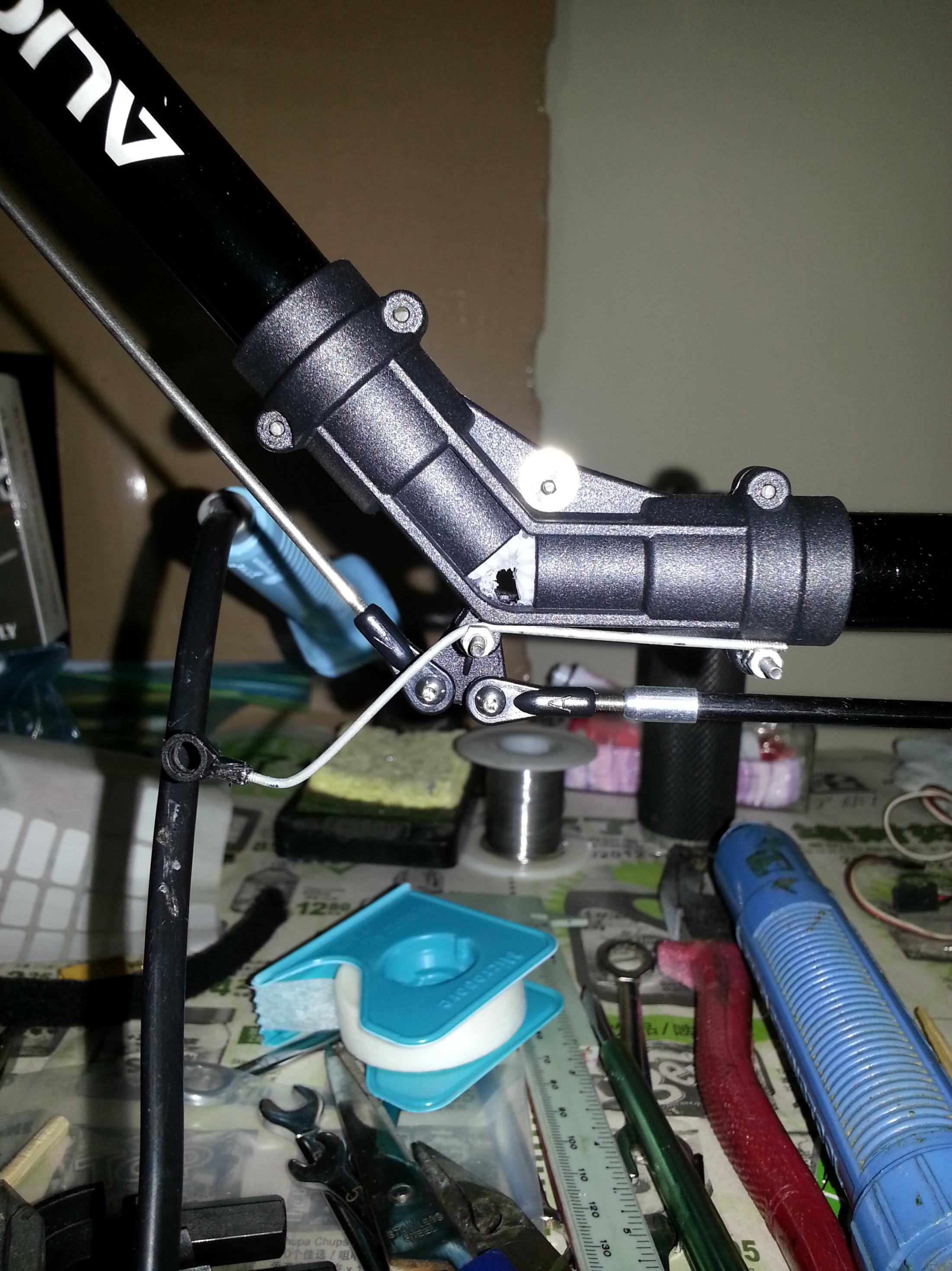

Building TRex500 size mechanical, realized that the frontal tail torque tube that I bought was wrong. It was for TRex500 non pro version. The width is wider than the Pro version.
Thus, spending some time to go Rotor hobby to get those missing/incompatible parts.
