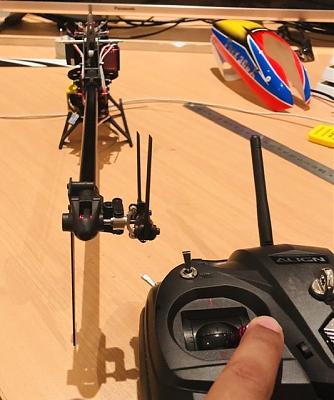

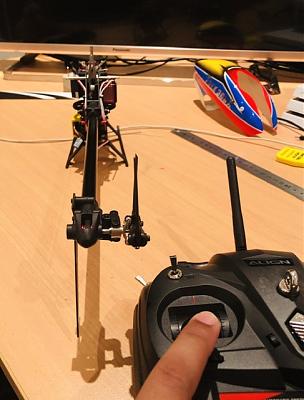

    Trex 300 rudder does not work. When I move the rudder stick during set it moves. But when I move the stick during flight mode, tail does not move to the end. It just move like10% on both direction.
    What FBL and your tail gain?

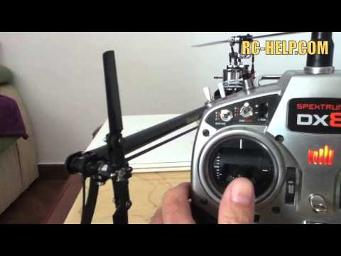

      Do this simple check on the bench (not in the air). Please take the necessary safety precaution.
      Move the heli (by hand, not using Tx) tail clock-wise, the tail blades' leading edge should move to the opposite direction (i.e. CCW).
      Move the heli tail counter clock-wise, the tail leading edge should move in the direction of clock-wise.
        Yes. I am testing the tail movement on the table not flying it. I think i have done set up correctly. But after completing all set up. Tail does not move properly.
            Hope this video help to explain what I was trying suggest that you check.

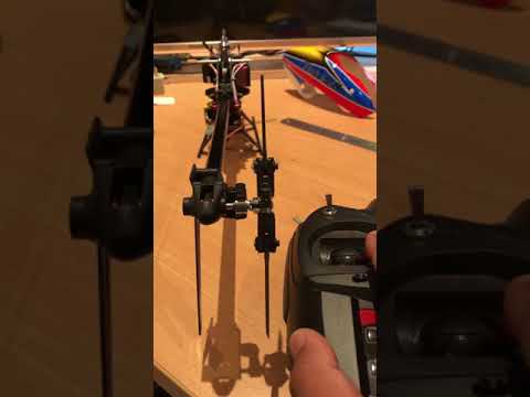

              Every thing is working properly. After completing setup. This occurs...
                So when you were in the setup, the tail moved. But once you out of the setup, the tail doesn't move.
                What happen now if you enter the setup again, will the tail move?

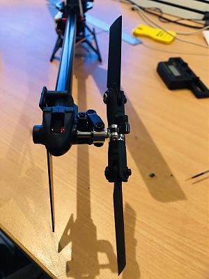

                        Now when i switch from normal flight to idle up 1. I got the same problem. And also when I switch to idle up 2 tail completely goes to the end as shown in picture. But i works in normal mode.
                          I think it may be a Tx setting issue.
                          Do you see any output on the rudder channel at idle up 1 and 2 modes ?
