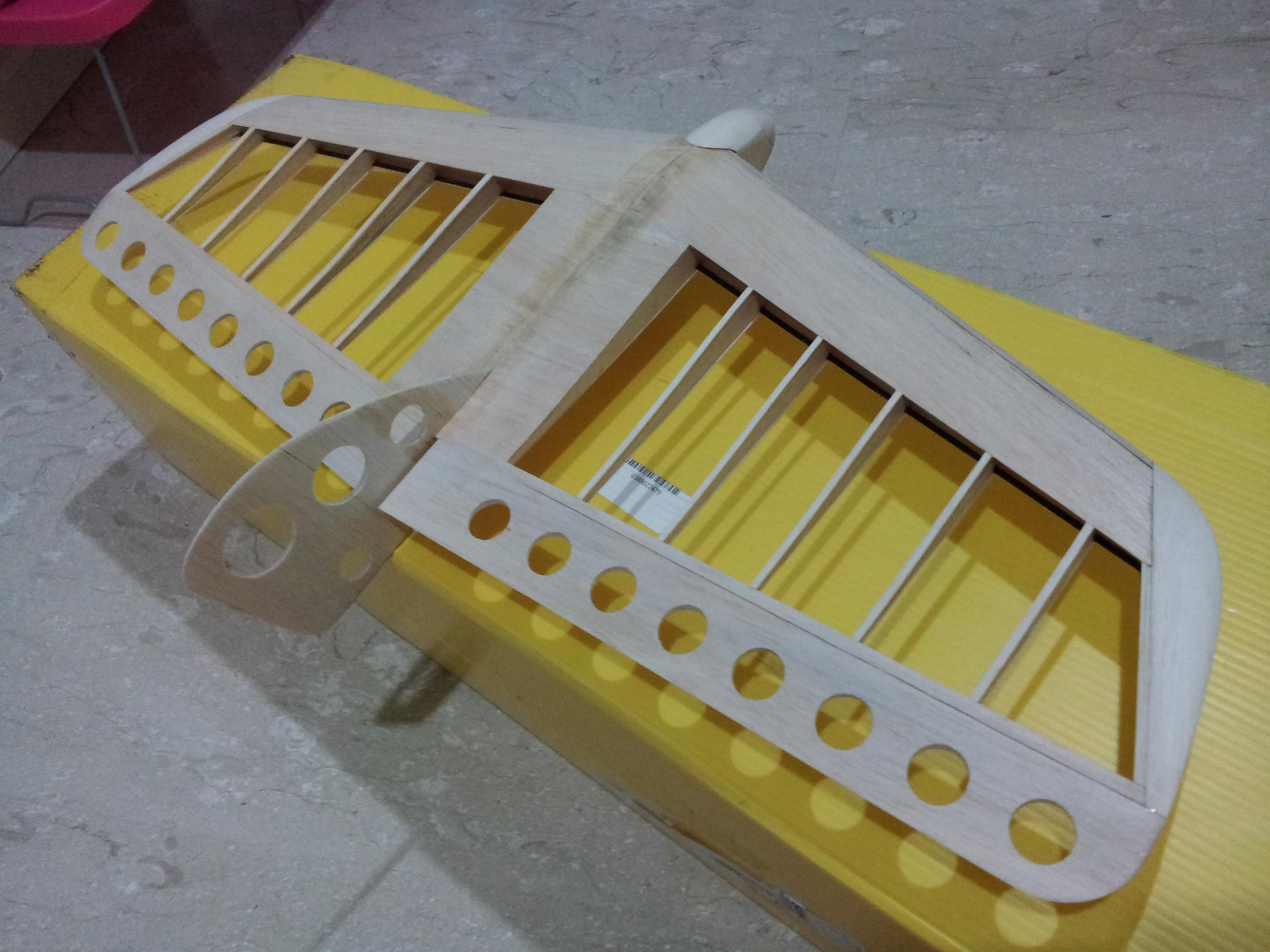

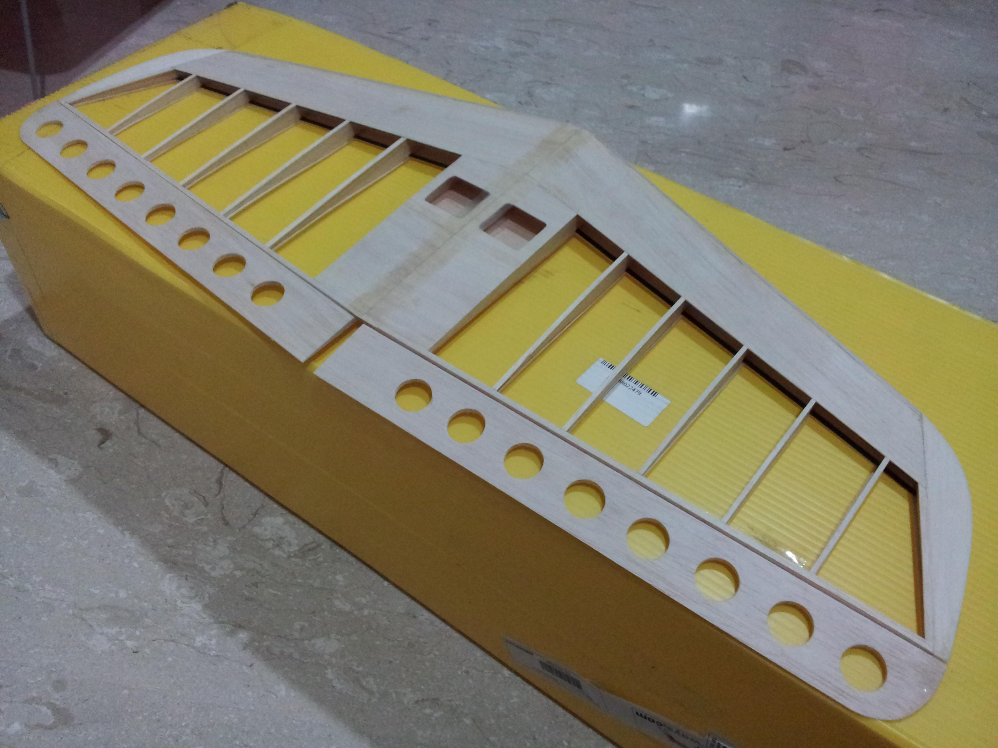

    At this point, all balsa structures are done, awaiting coverings and servo installations. Eventually, this model is going to be an one-piece plane. The wings have carbon spars and the rest are balsa. The 2 wings are built separately and joined by epoxy and glasscloth. The elevons are planed down to taper from 3/16" balsa sheet with multiple lightening holes cut.

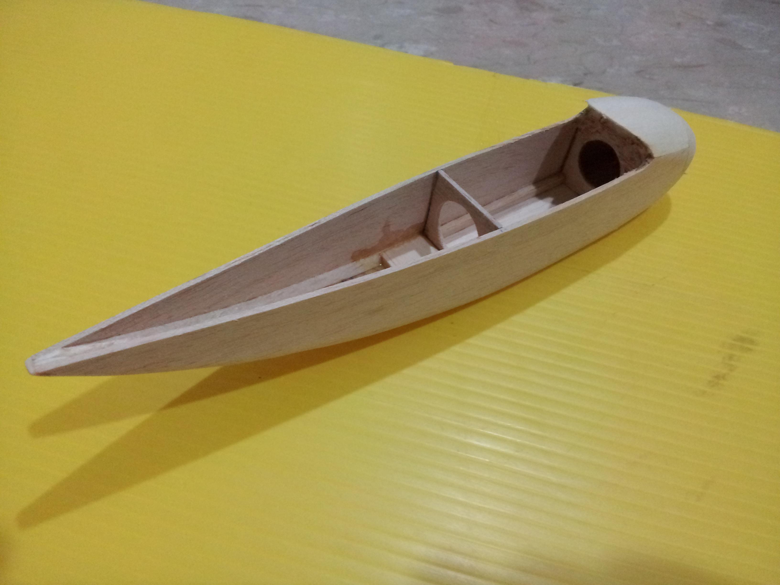

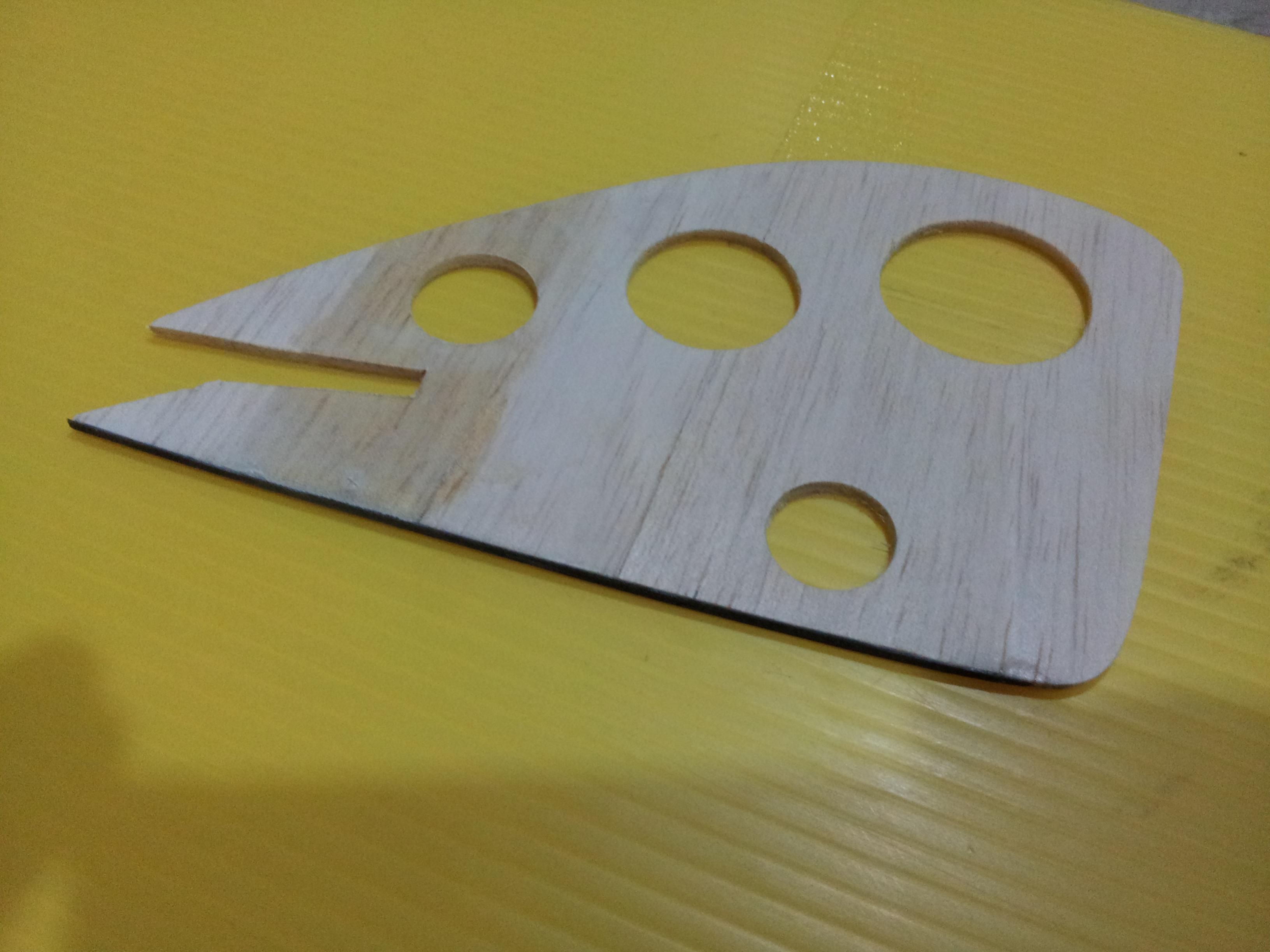

    The fuselage is just a usual box type structure with a hatch provision on the belly. I also epoxied a piece of plywood behind the hatch for tow hook mounting, in anticipation of possible high-start launches. The vertical fin is from 1/8" balsa with grain running vertical. To minimise warping and splitting, I glued a strip of carbon at the bottom edge and glassed the forward area.

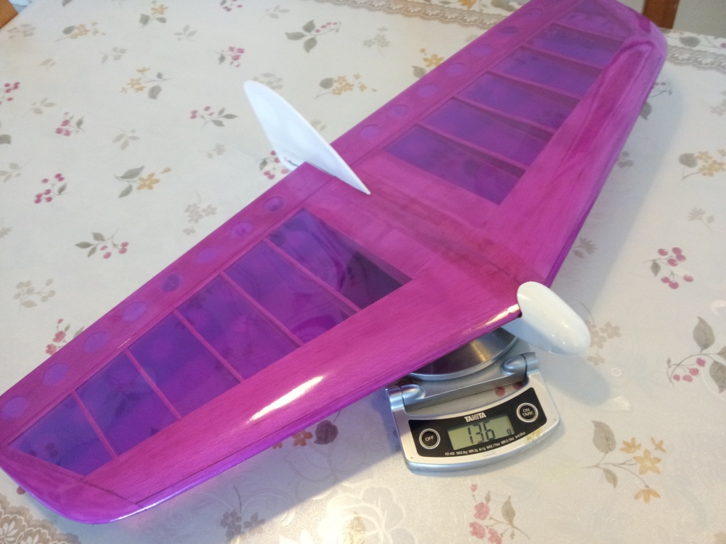

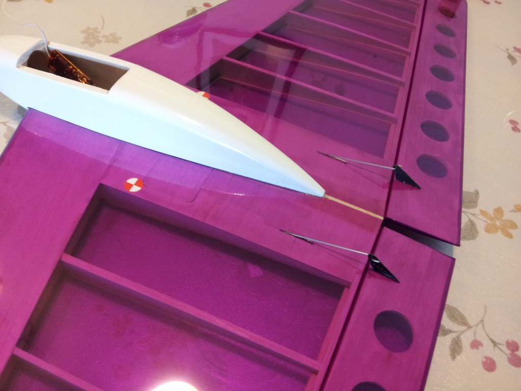

      Done up with the coverings and the fuselage is permanently epoxied onto the underside of the wings. The control horns are fashioned from thin carbon sheets and epoxied directly into the balsa elevons after rigging.

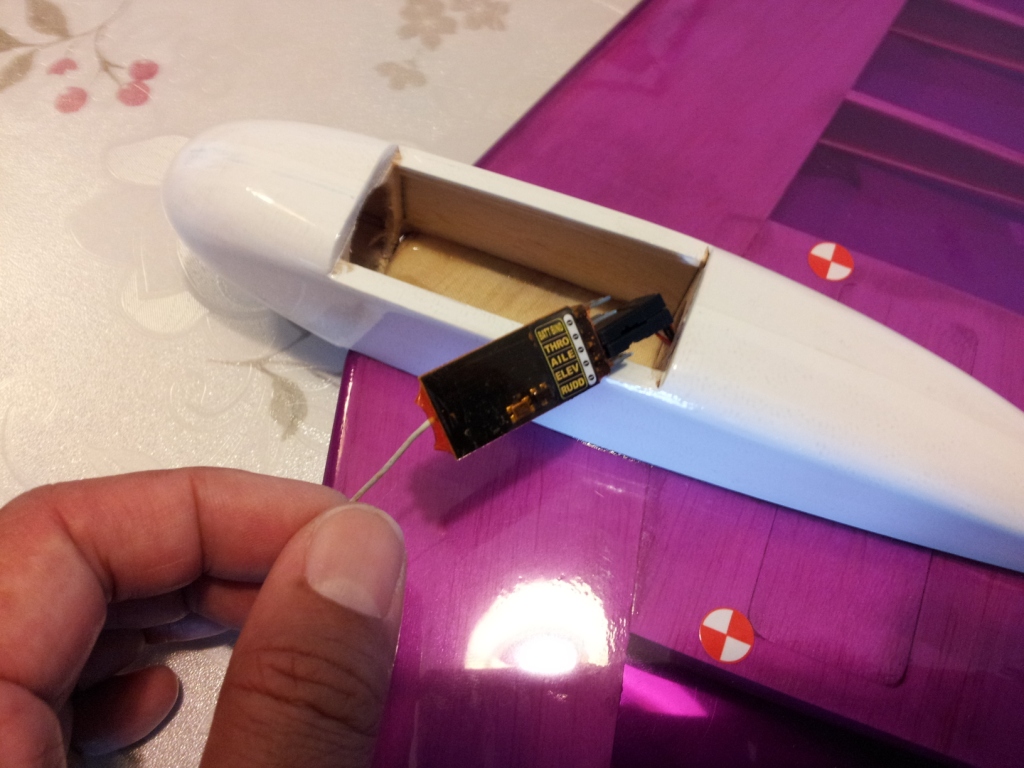

      This model will be used as a check out slope soarer on light lifts and small slopes. As such, it is not intended to be flown cross-country and an indoor Orange receiver is sufficient for this job.

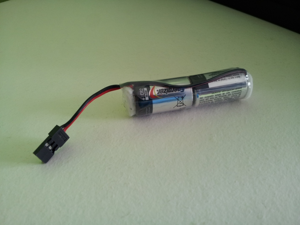

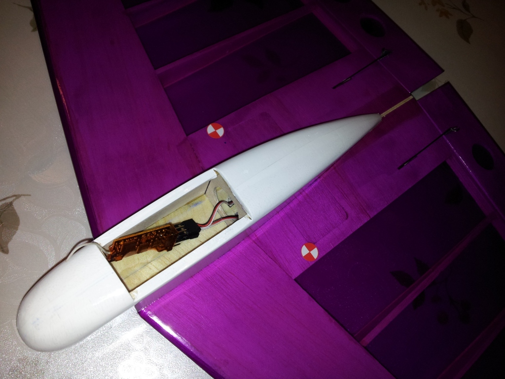

        The receiver battery pack is made from soldering 2 Lithium Camera battery cells in series.

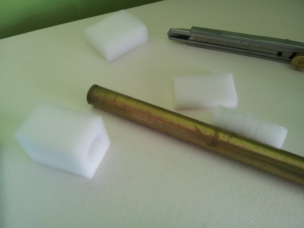

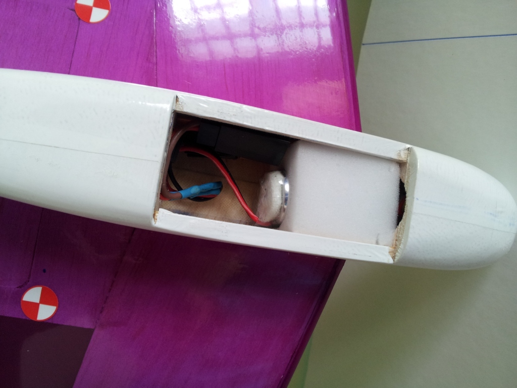

          I bought some Melamine sponge from Daiso which are pretty cool stuff! The sponge is very easy to be cut with a penknife and a sharpened brass tube, which I used to make a customised shock mount for the receiver battery. The whole stuff fit snuggly and neatly in the nose of the fuselage.
            The model is now ready to fly at 136 gram, including a 5 gram nose ballast.
