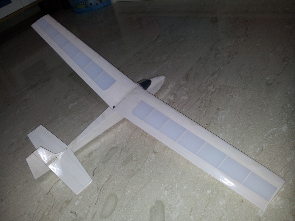

From past experience, scaling down the wing in proportion is not a good idea, in terms of aerodynamics. So, I broadened the wing tip chord and enlarged the stabilizer to compensate for the increase in wing area. A flat-bottomed airfoil with moderate thickness is chosen to avoid complicated numbers and construction. The controls are only limited to rudder and elevator to save effort, which in turn requires a distinct amount of dihedral to make the rudder effective for rolling.

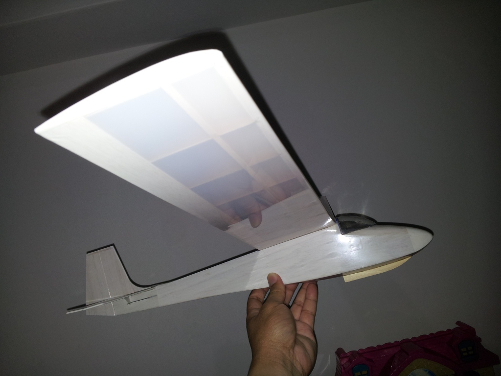

The entire airframe is made up of balsa, with a little plywood here and there. I use 2 ~3gram servos for indoor model and a nano Orange RX and a pack of 2 photo-lithium cells battery. I used Oracover lite transparent white covering throughout to keep the weight down and All-up-weight is about 105 grams.

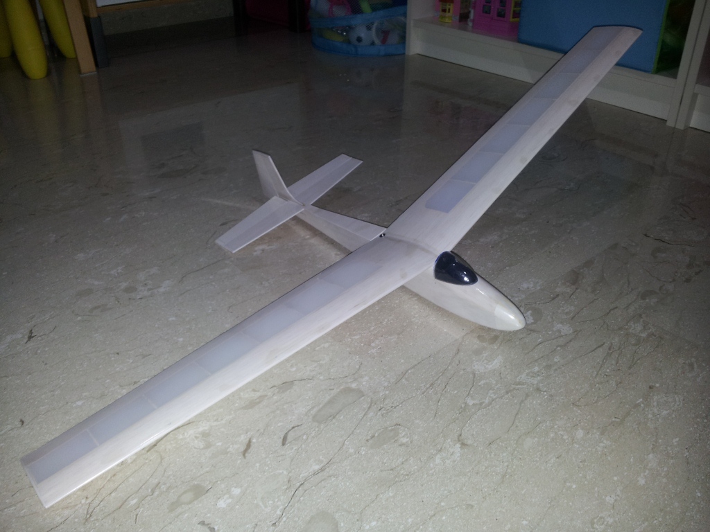

The model was maidened at Sedili last Sunday in moderately strong winds with a solid blue foam canopy, which the model handles pretty well. Only last night, I have replaced the canopy with a clear moulded PVC one.
