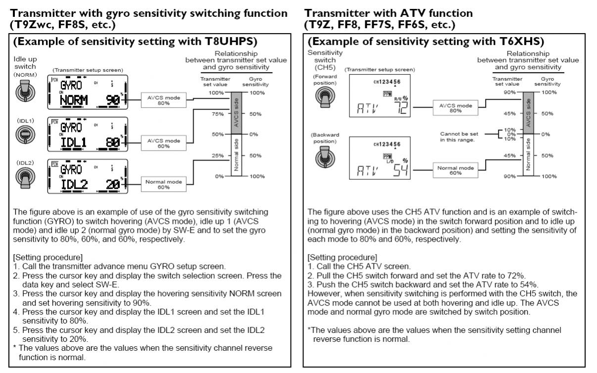

Can any kind soul adivise me on this?
-Which channel should my rudder input connector and sensitivity switiching connector goes to on the reciever? Input connector to channel 4 and the other to 5? The hitec manual says channel 5 for gyro but when i insert to channel 5, nothing happens when i adjust my rudder input and there's a blinking light continously. I tried adjusting the gyro gain but nothings happen.
-How do we goes into the normal mode? The gy401 maual says intermittent flash is normal mode, so does we adjust the gyro gain to go to this mode?
Initally thought that its just a simple setup like GY240 but i was wrong....help please....
