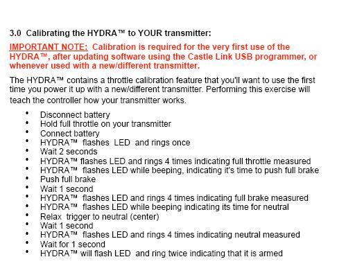

Can not fin din manual anymore.

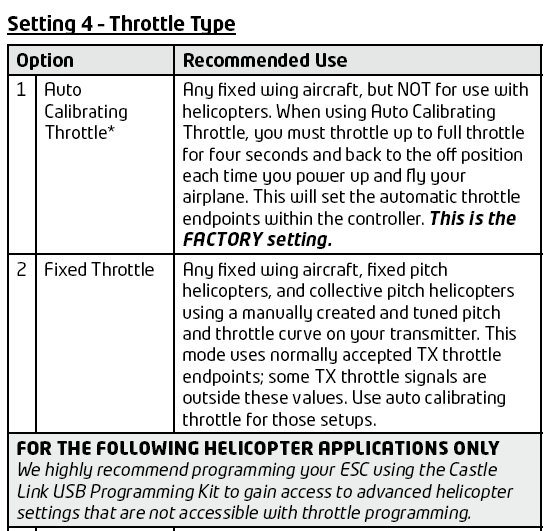

These steps are only for CC ESC. I'm not sure about others. This setup is very important if you use fixed mode. It is also important when you need to setup the bottom throttle to arm your ESC. This way, your ESC will arm when the throttle stick is at the lowest point, and not somewhere above it, hence your pitch will correspond to the correct headspeed of your throttle input.
