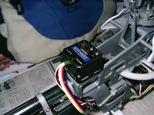

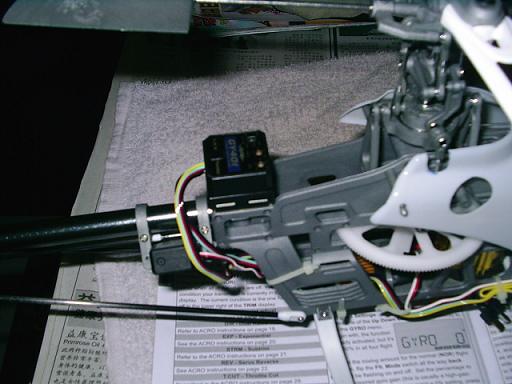

    My trex just had a maiden flight, manage to tune the pitch & hover at 50% throttle but the rudder keep heading right side when throttle up, tried strim & manual trim also can't solve it, is it not neutral or my 401 gyro direction is wrong? anyone have this problem before?
    Your Gyro direction unable to see clearly.
    U using 401.... did u connect to channel 5? Hehehe.
    If u do connect... did u set your TX for the gain value?
    If u do... did u disabled your Revo Mixing?
    If u do... did u let your GY401 initialize itself before u move your Gyro or Heli?
    Super-Hornet
      Your revo mix is on.
      Turn it off and you will not have this problem
        It should be your revo mix is on. Mine also had this problem until I called HZM to check for me and found out that the revo mix is on.
          Super-Hornet
          yes
          yes
          yes, revo=0%
          yes
            btw i'm using eclipse7 so revo can only set to 0%
            is there a way to reset the gyro?
            thanks
              Trying switching the DIR on the gyro to the other direction. It work for me. Jonathan
