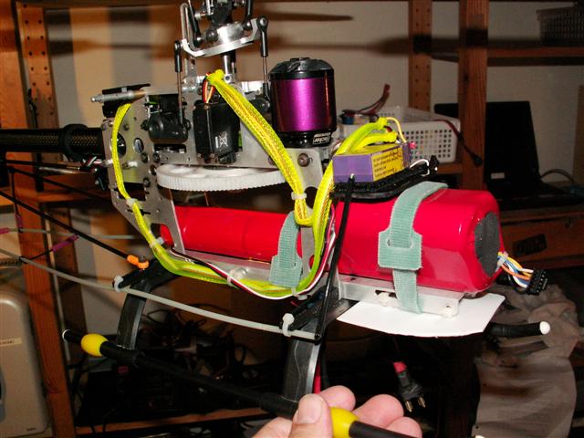

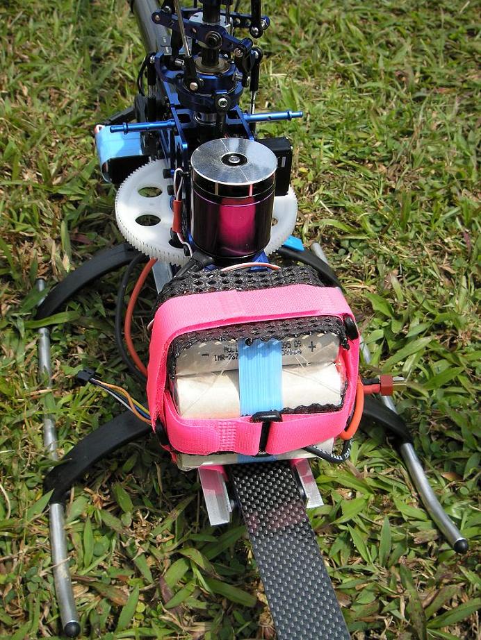

Shaky pics but you can see tele's unique way to elevate the battery platform to raise the CG higher for more agile flying. Also the use of r/c cars servo mounts for adapting to normal landing gear. Cheap and works like a charm...

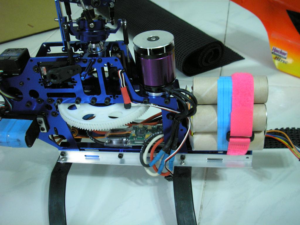

Well got some emolis for myself and made some packs up.
they look a bit phallic but they fit in the frame nicely and are perfectly balanced!!! cant beat that

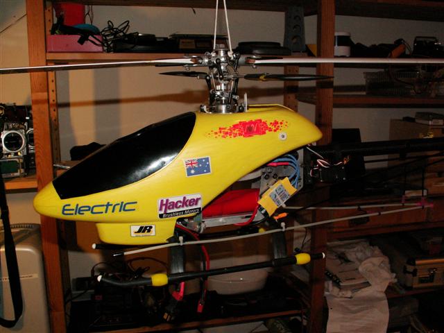

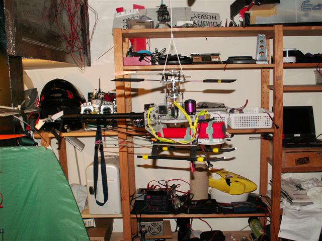

you might also notice my heli balancer..I suspend the gheli via the flybar on the two hooks and then use a small bubble level on the tail to make sure that its level. works great!!
