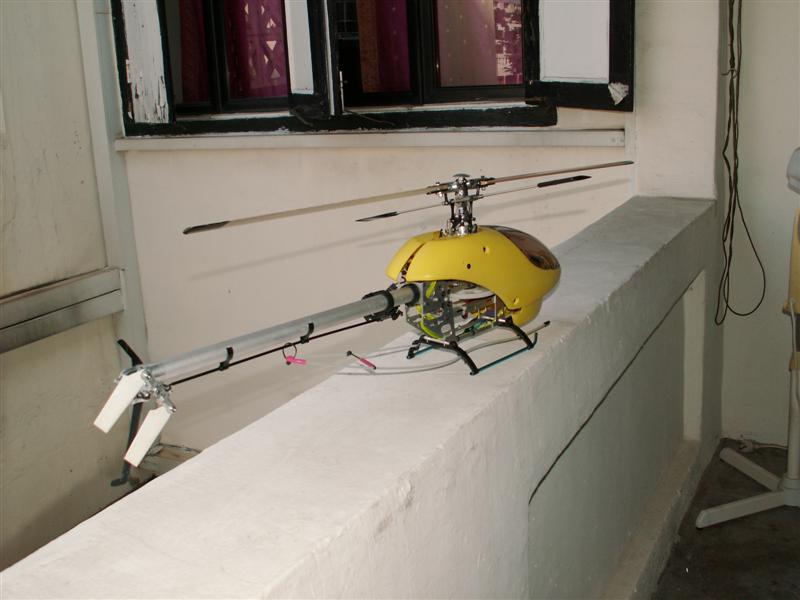

    here she is 3 flights old.
    setup
    hacker 30A-8xl motor
    5s 2100mah Tp pro light ( 7 min each pack)
    gy401 + S9253 servo
    schultz Rx ( no gliching what so ever as of yet ...not even on the glich counter!)
    5 v S&T BEC
    CC35
    I will however change the paddles ..they are very "soft" for this heli.
    cheers all
    Doug
    ep8
    Maybe my net heli is EP 8
    POWER NOT ENOUGH
      U using trex skids???
        ha! just a few weeks ago i asked you about going to a bigger heli, and your answer was a simple ... "nahz!". So what happened :P hahaha
          good deal came up that i couldn't refuse you can thank Ammo for upgrading :P
          the skids are from the blackhawk a mini nitro bird from the shop that "should not be named"
          but they fit nicely since the mounting hole is vertical instead of on the strut itself..... some small drill holes, some spacers and she fits like a charm and is about the same width as the stock.
          still getting the throttle curve worked out. she draws about 16amps hovering. weights in at 1516g with 60g of ballast in the nose. so in reality the flyweight could be 1456g.
          cheers doug

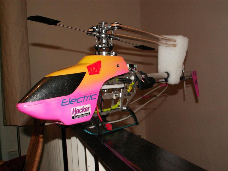

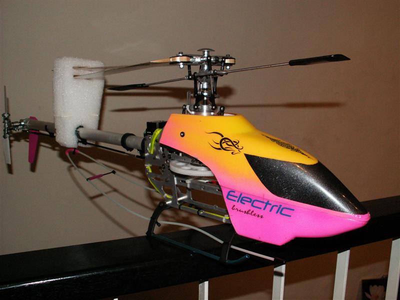

                    What do you think about the swift canopy on the ep8.
                    lots more room for batteries. only 50g heavier a small mod and very little cutting needed.
                    does it look over sized?
                      It looks ggggggreeeeeattttt!!!!! But please do up more on the plain yellow.
                        It looks ok
                        but now the skids looks small
