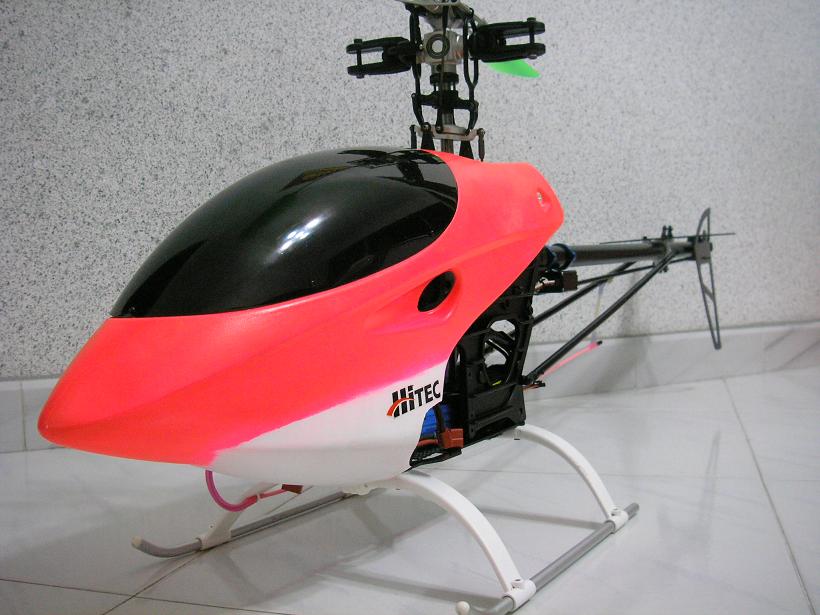

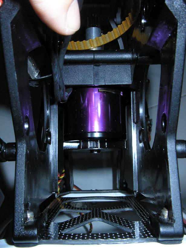

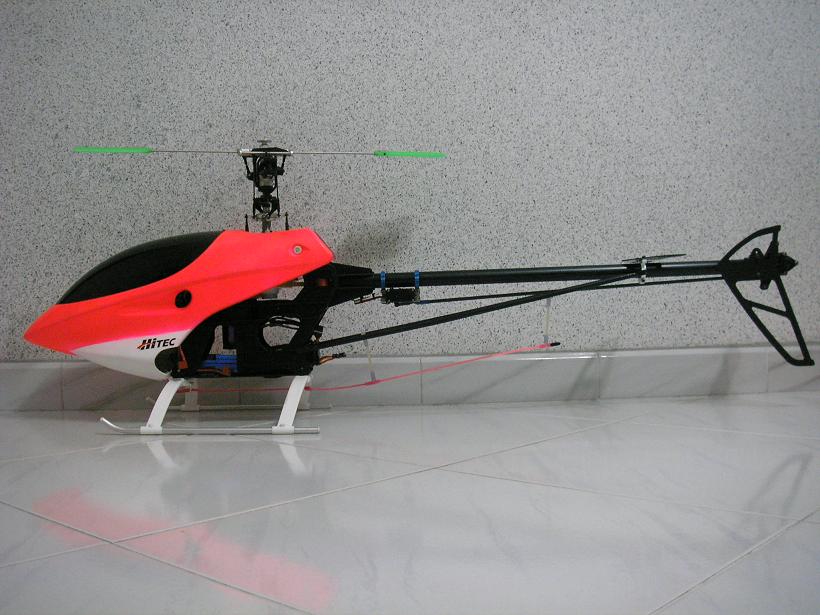

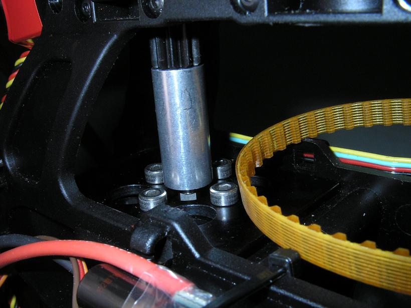

          Conversion kit comes with Motor and Mount, can fit directly on raptor 30/50 frame.

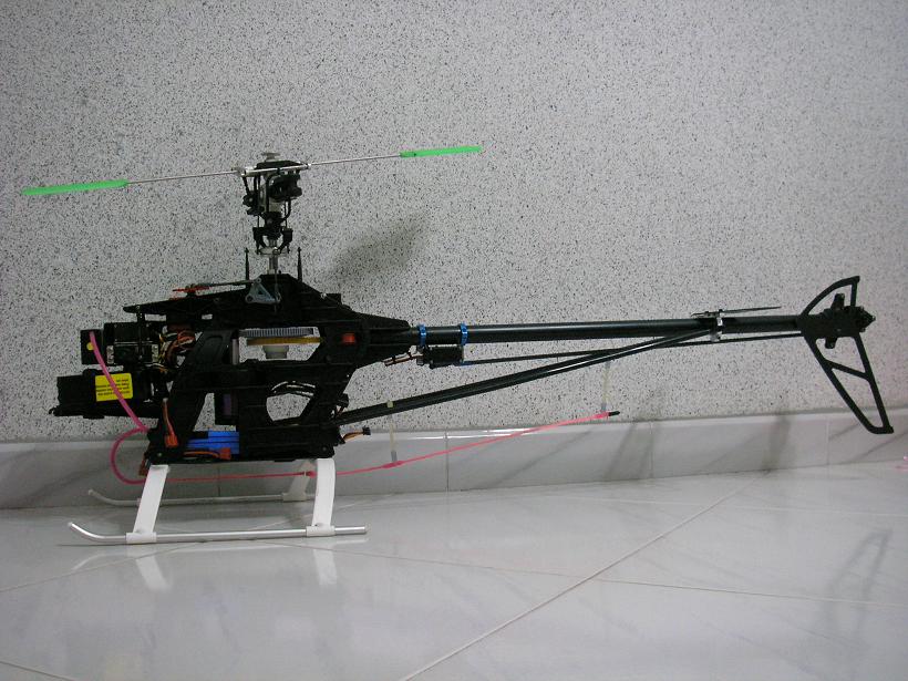

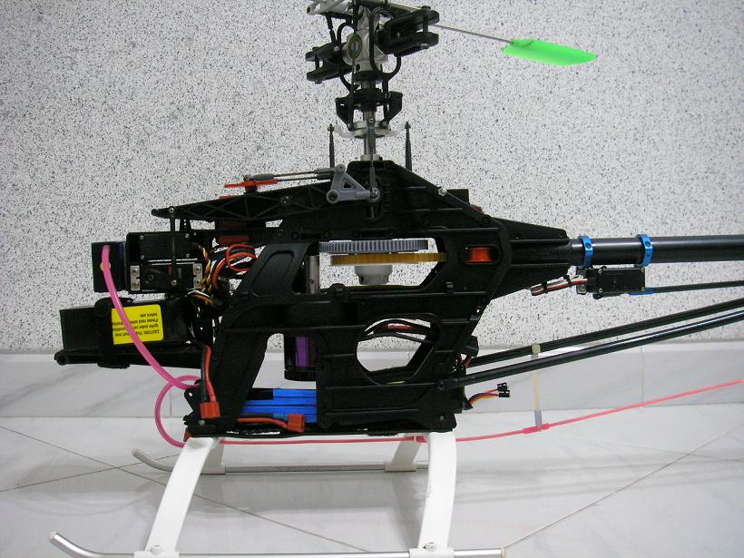

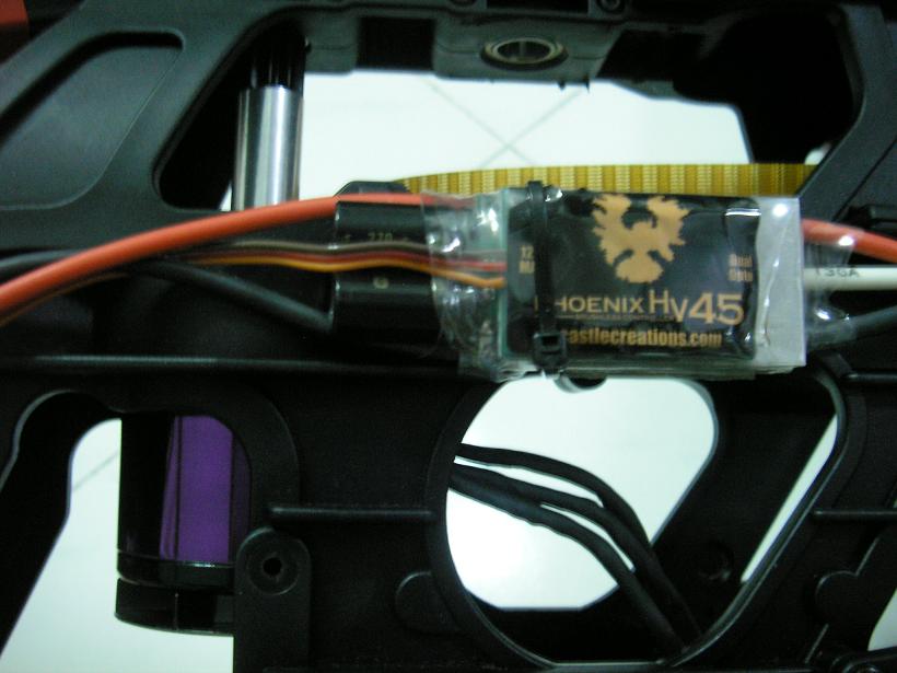

            I am also doing a raptor 50 E-conversion.
            My specs are
            Raptor 50 v2
            Futaba 401/9253
            TPPack eccp conversion
            3 futaba 9202's
            CC phoenix 45 hv
            Hacker A50 12s
            TPPacks e-conversion kit
            11s Emolis
            Fma heavy duty
            Medusa 6v bec
            2s lipos for the electronics
            I am almost finished with the conversion, I can't wait to put this bird in the air.
              My specs are
              Raptor 50 v2
              Futaba 401/9253
              3 futaba 9202's
              CC phoenix 45 hv
              Hacker A50 12s
              11s Emolis
              Fma heavy duty
              Medusa 6v bec

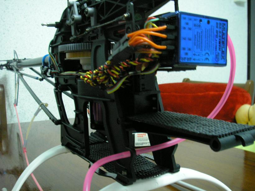

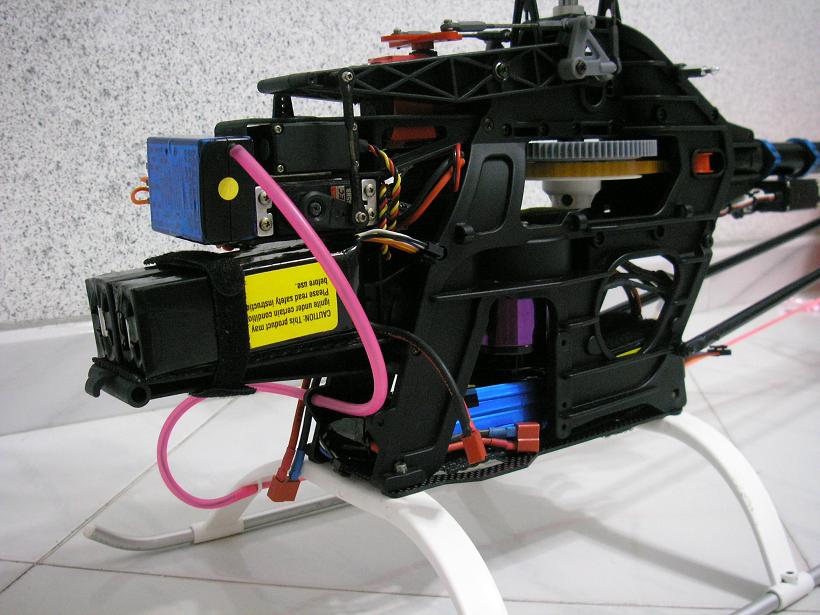

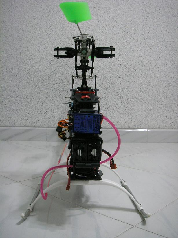

              wah a separated 2 lipos is required for the electronics? btw what is the main flight battery specs are u guys using for e-raptor?
                e raptor conversion
                The 2s lipo is for RX, 11S emoli means 11X 3.7v (round cell)for main motor.sure no problem for that setup.
