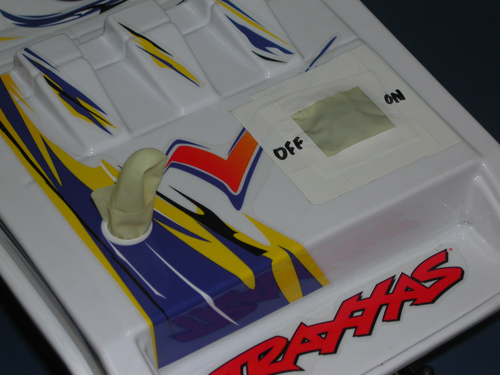

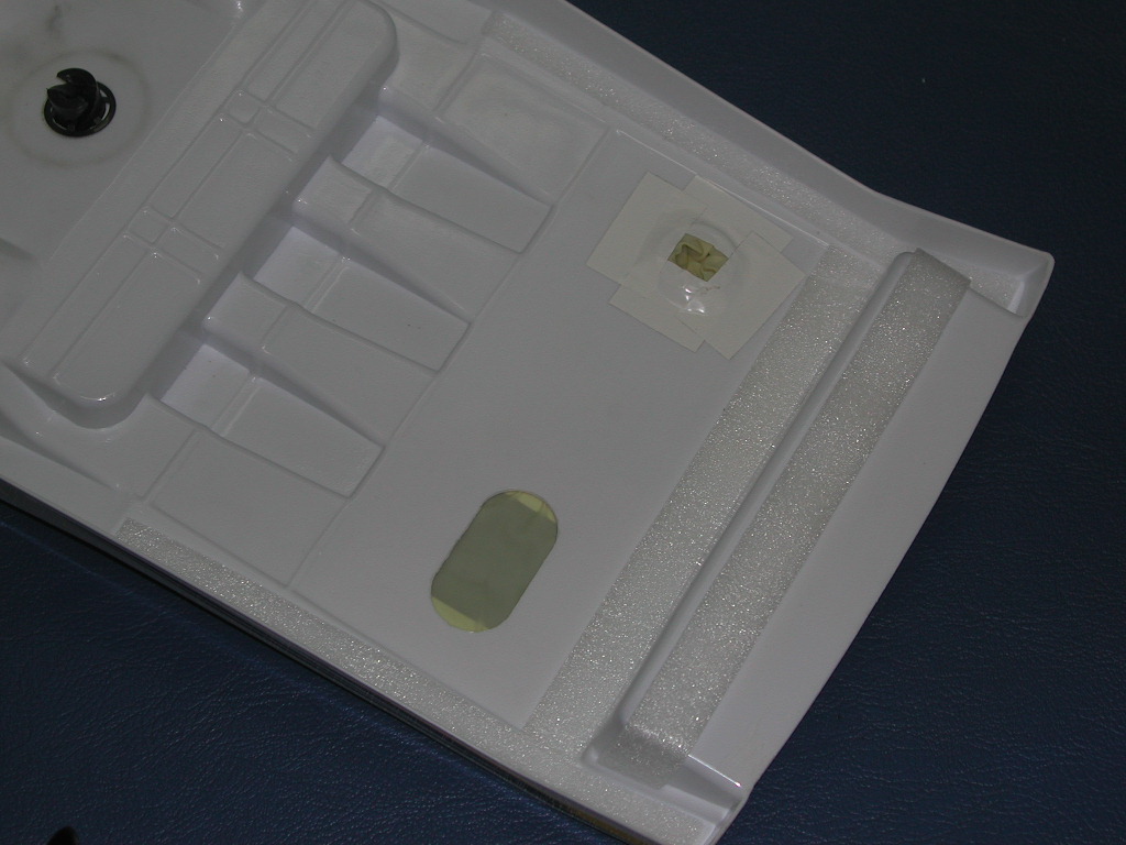

    I've some pics not so presentable waterproofing attempts using latex glove for my Villain's hatch. Works well.

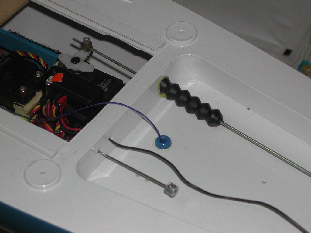

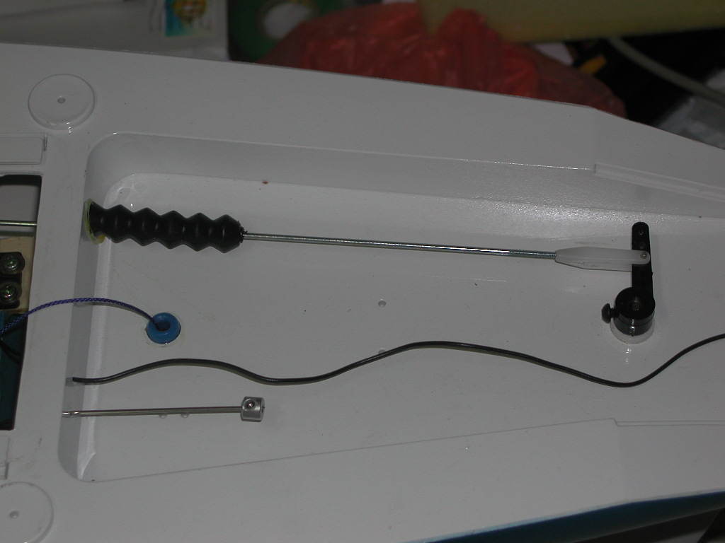

      Here's some pics of the bicycle brake 'bellows' being converted to pushrod boots for my Victoria.
        #63

        The bicycle bootee is kinda stiff, make sure u get the softest possible otherwise your servo will drain lots of juice.

          Yup, agree that bootee (wah, learn a bew word today!) is a bit stiff. Wat to do, at that time can't find proper pushrod boots.

            no kidding guys ...... I bought a pack of condoms and latex gloves to see which fits better. Its a very tight area and the gloves seems a bit big. But the gloves did well over my receiver and ESC switch.

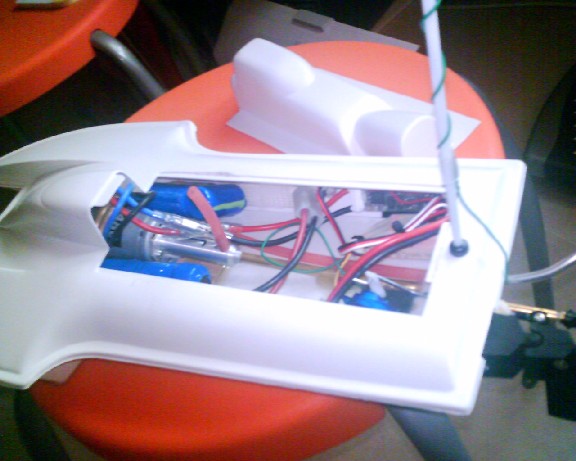

                              Hi - Other than paint and trying out in the pond, this seems to be completed.
                              PS : Couldn't find the bootie at Toykar. Anyone find something more appealing than my make-do bootie pls let me know?
