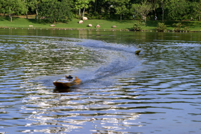

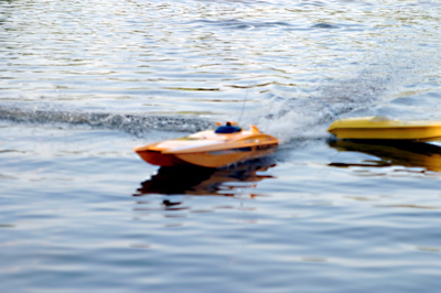

                Anyway, the Cat will be taken out of cold storage next Sunday for a run at PP. I was going through my old photo files and found these pictures (taken around Aug/Sep last year
                The first shows my Cat being chased down by Zanter's highly modded Nitro Vee. The second made my jaw drop!! That's me coming in for a re-fuel and Zanter's NV screaming past... goes without saying that I never saw him coming Zan, you should fly for the RSAF!!
