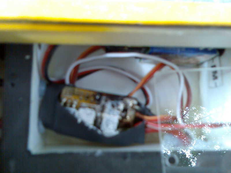

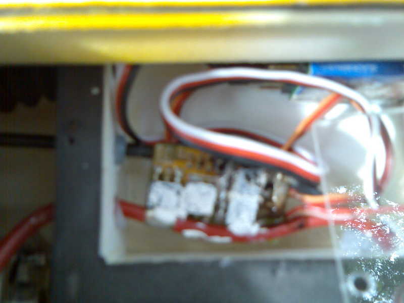

    4th run - 1min into run, esc up lorry liao. Lucky strong wind blow the boat towards shore.
    3S lipo definately no good for this brush setup!!! motor very hot after each run. Did not check esc so I guess I fried the esc.
    There r little water seeped into the hull, kinda of pin point the leak area, will touch up will aquarium silicone n monitor.

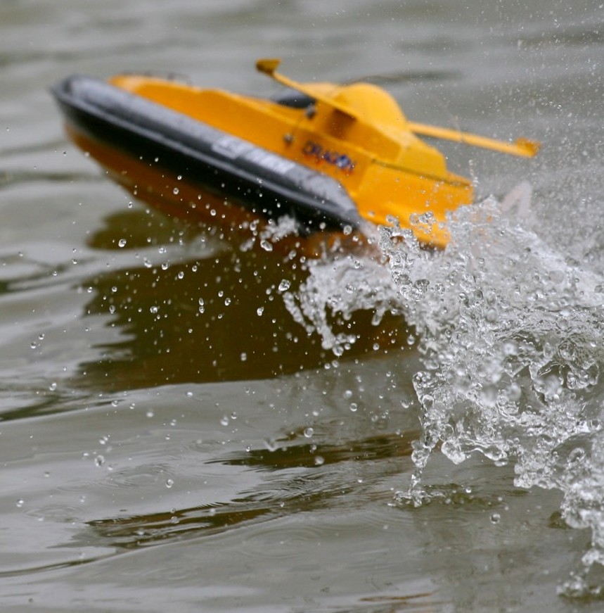

          First pic ... see how nice the water is ..... lost focus on the boat
            #50
            nice...........

              Glad you had a great time. As for the fried ESC, perhaps a cooling plate would have prevented the overheating.
              As for the leak, since your boat's fiberglass, epoxy might be a better solution.

                Wah....the droplet's nice.
                  #53
                  ya manz ... miss the boat but got the water droplets
                  More pics here
                  Post all pictures and videos here. Alternatively, you can upload pictures and videos at the Photo Gallery.

                        I found the leak already, its the cooling tube to the cooling coil of the motor. Will cable tie it to prevent any leaks!!!

                            Hmmm.....just shove the silicone tube deeper in. Cable tying is a good idea. You can also flare the end of the cooling coil a bit.

                                U know of any place to get cooling plate for the esc like the Jet hobby ones??? http://www.jethobby.com.sg/cgi-bin/e...6&cid=48&idx=1
                                Anywhere cheap or I'll just buy the one from Jet Hobby.
