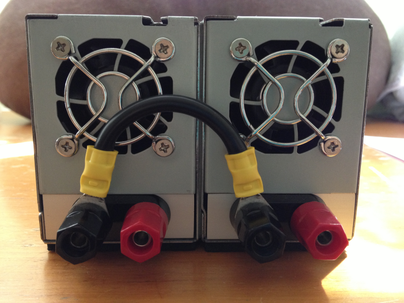

    Did you mean I still have to make sure the floated unit is still connected to the other psu like the photo below in order to use the floated unit as a single 12v unit?

      Very sorry Mflex, I did not know you posted again.
      This is what I meant:
      Floating Ground on the right hand unit will take reference from your regular Ground (DC and AC tied together) on the left hand unit in this configuration via the jumper cable. So you have essentially "de-isolated" the floating ground unit and it will be act as 2 regular/separate 12V power supplies again.

                    I followed this guide and made my 1st 24V PSU. Thanks yhchoong.
                    Materials:
                    2 x 1.25-4L ring terminal (for crimping ribbon cable 1-5 to GND).
                    8 x 6mm 10awg yellow ring terminal (for connecting from GND and 12V on the PCB to binding post)
                    4 x 8mm 10awg yellow ring terminal (for jointing the 2 PSU)
                    2 x M3x8 nylon screws (for floating ground of the 2nd PSU)
                    4 x binding posts
                    ring terminals were bought from sim lim tower and the M3x8 nylon screw and binding posts are from hobbyking.
                    Tools:
                    Crimp tools for insulated terminal (bought from sim lim tower)
                    black and decker drill (I already had this which was used for drilling holes on the wall.)
                    Procedures:
                    1. Remove the hot-swap board. (remove the ribbon connector, cut the 2 wires and remove screws)
                    2. Strip the wire 1-5 and crimp them together. I just use a paper knife and carefully cut a little bit on the insulation and be able to strip it off by pulling hard.
                    3. Floating ground for the 2nd PSU: Remove the left and right screws from the PCB. I put the electrical insulation tape under the 2 holes. I didn't remove the whole board so the spacing between the PCB and standoffs are very limited. I just used a flat tip screw driver to push the insulation tape under the PCB holes. Then punch a hole through the tape then screw in the nylon screws.
                    (Step 1-3 took about 2 hours for 2 PSU.)
                    4. Drill holes and mount the binding posts. The holes for my binding post are 7mm.
                    (Step 4 took me 2 hours for the 2 PSU.)
                    5. Cover the gap below the biding post with duct tape and also use it to wrap the 2 together.
                    Here is the final image.
