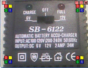

Can 12V 2amp 24W power up charger?
    Can advise if this charger of 12V 2amp power up triton/T10 chargers?

      Here's a picture of the charger
      Pls. advice..thank you.

            DO NOT use accu chargers to power your chargers.
            The pict u showed is not a proper power supply.

                It is a 6-12V 2amp 24W for lead 12V battery charging.(Lead battery charger,this is what it says on the box)I was told by Jeff from SHS to get a power supply of 12V 2-3amp for the T10.Thought so this charger also can work as a power supply for chargers.

                  nope, u can't...
                  Seal acid chargers work on a Constant Current (CC), Constant Voltage (CV) detection....
                  First, it'll give constant current to your sealed acid batts....this can go up to 13.8 volts or more.....the charger will feed as much current (2amps in this case) to your sealed acid batts...thereafter, it'll switch to maintain a preset voltage and the battery will draw whichever current it can accept....just like lipo charging....
                  When u use this to power your T10 charger, 2 things will happen.....the over voltage might blow your charger.....or your charging will randomly terminate because of the SLA batt charger's CC/CV circuitry switching.

                          They might work lor...but seriously, it's not recommended...if your charger is good enough, it will help to regulate voltage & current as much as possible, but still got limitations...
                          Use a proper powersupply, the best are regulated ones....12v high current PS unit are usually pretty expensive.
