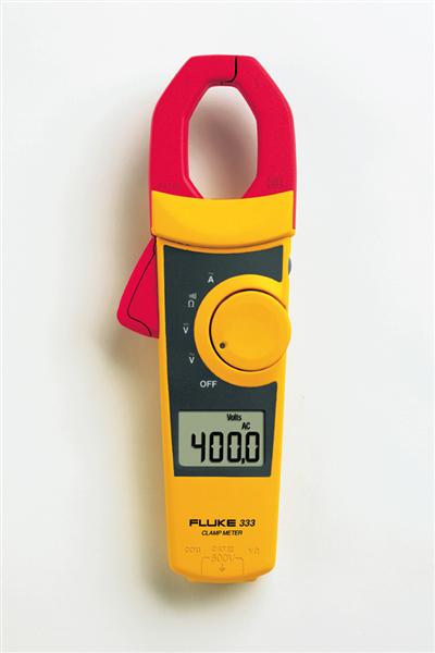

                      If you want to get a ammeter, get a clamp one. Alot more convinient. You just put the meter round the wires and it measures the current flowing through.
                        Thanks for your explanation! So am I right to say the amp draw is the current at WOT?
                        And the clampmeter is something like this?
                          Yup, that is. Nice one too.. Buying one?
                            Er......soon but not this one. The Fluke is pocket busting.
                              Ya I want that too....if I have the $$$$$$$ that is why end up using panel meter
