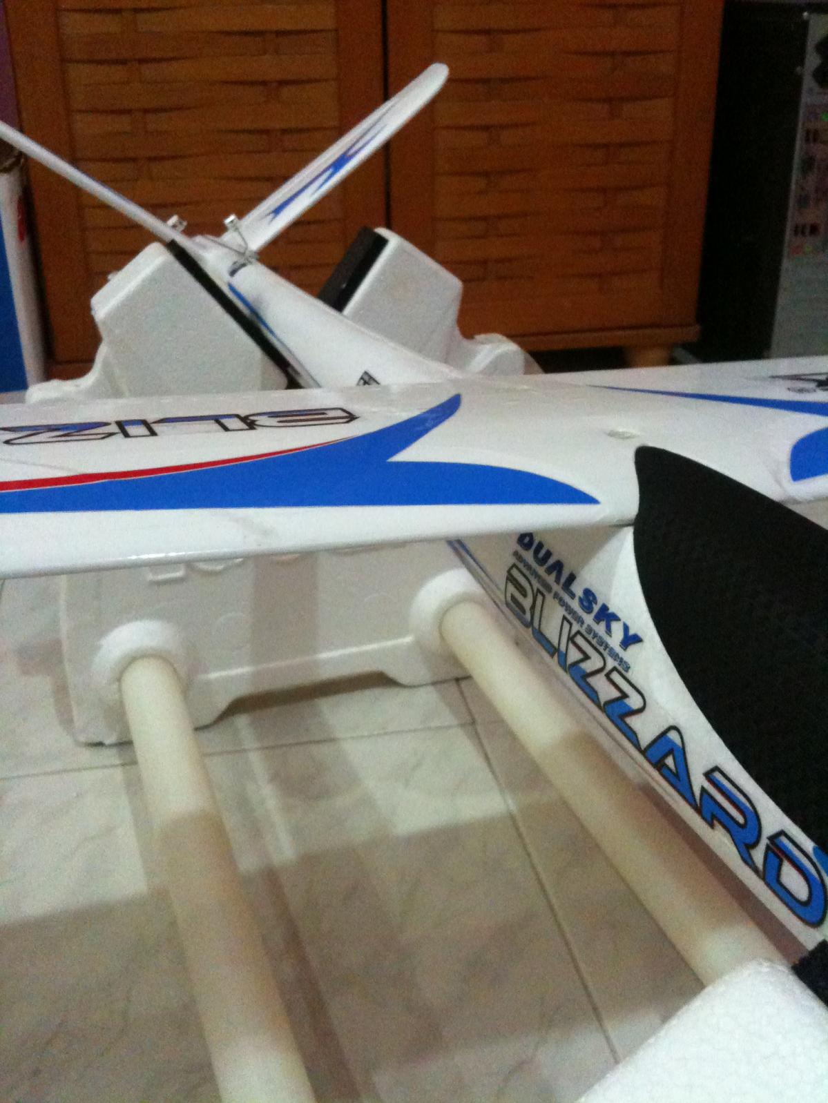

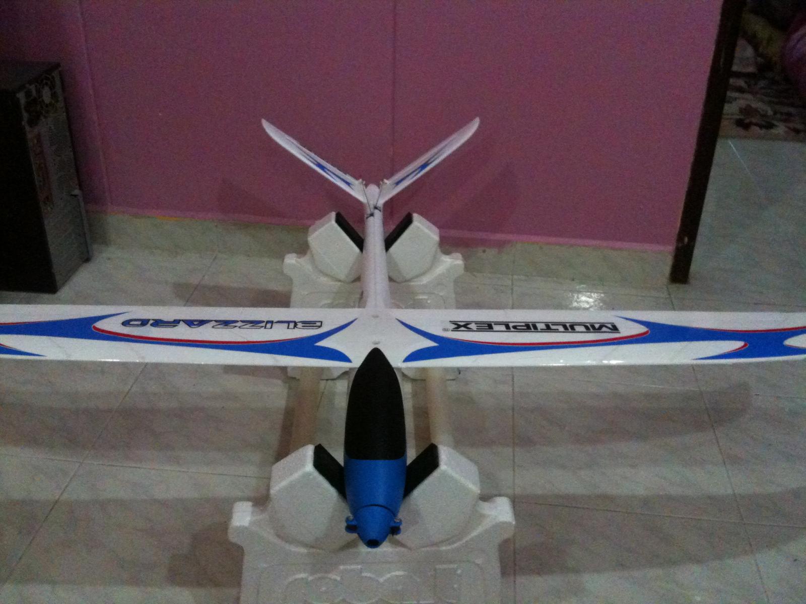

            #20
            Finally done.
            My setup.
            Turnigy HXT 35-42A 1450kv Brushless Outrunner
            TURNIGY Plush 60amp ESC
            Dualsky S-2200mAh 11.1v
            11 x 8 Prop
            HS-55 All Servos aileron / rudder+elevator
            AR6200.
            Boy it's a pain with the ribs. :x
            Overkill?
            [SIGPIC][/SIGPIC]
              #21
              Have you run a static test yet?
              This combi might be stressing the motor some, if you pull extended runs at full throttle. My dccalc software says about 60 amps draw at WOT. Might be more on a fully charged batt.
              Apart from that.... I think it should be a very nice performer. Have fun.
                #22
                Originally posted by nixaad View Post
                Finally done.
                My setup.
                11 x 8 Prop
                AR6200.
                Overkill?
                1450KV using 11 inch prop with pitch angle 8??!!

                      #25
                      Originally posted by Housefly View Post
                      What motor re you using?
                      If you full throttle all the way and the motor did not fried, let me know the brand and model... I would like to get one...
                      which Part of My post u dont get? All the details are there. Are you a speed reader? Being sarcastic doesn't help. A friendly advice goes a long way.
                      Anyhoo, yes it is overkill. Did a little static test without any equiptment, esc felt warm on 10 secs half throttle. Going down prop size to 9x6 range. Not going 11 as recomended by motor manufacturer.
                      Still got no time to fly lah Adnan. thought today can make it, alas got to do chores. Sigh...
                      [SIGPIC][/SIGPIC]
                        #26
                        Sorry... I did miss out on a lot of details... left eye got stamp..
                        I had similar setup, 35 size on 1400kv, max I can go is 9 x 8 prop.. and I am talking about holding full throttle for at least 2 minutes. Motor was hot but not fried..Did at least 10 flights on full throttle... By the way... it flies really fast..

                            #28
                            aye aye. I'm a bit sceptical because with the whole setup, the whole plane feel kind of heavy. Hence, the 11x8 prop n also bcoz of the manufacturer recommendation. But I'm takin u guys advice and propping it smaller.
                            [SIGPIC][/SIGPIC]

                                #30
                                No way you can full all the way with 11 x 8 prop on 1450kv motor, it will burns out in 60 secs or less...
                                I think you might miss out a small line saying" Do not hold full throttle for more than 10 secs on 11 x 8 prop".. jOKIN...
                                The manufacturer wants you to buy another motor, that's why THEY recommend such crazy prop size..
