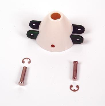

                    The spinner size is 40mm. The prop is up to you =)

                            The problem is you have to use MPX spinner for blizzard. This is because there is no cooling inlet on the fuselage and the MPX force you to use their spinner. So far our LHS don't carry the turbo spinner or not that I know of.
                              Shucks... sucks... hhhmmm.... What do u use btw?
