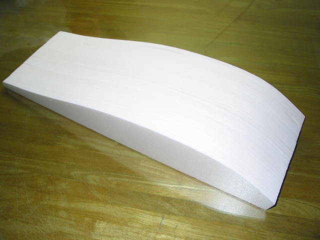

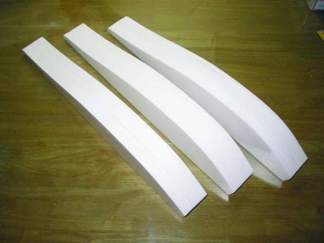

Ok, finished cutting up 30 pcs of foam for canopy, 3M77 spray glue used for this canopy build, tedious work man!

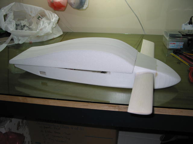

Well at least it's starting to look like a plane now
Will be shaping the canopy tomorrow night, tonight too tired liao! see too much foam at too close a distance!, i can still see whitish/opaque color when i close my eyes!

I glued 10 pcs each because my penknife is not long enough to continue cutting 30 at one go, so that's why there are 3 stacks of 10s, the 3 stacks are then glued together finally, PHEW!

Jesus mate! How you managed to cut those templates so accurately that they fit so nicely?!?! Hmmm, Artist hand you got there lol. Very nice! When do you reckon you will maiden this bird, doesn't look like much to go except for wing and power system.Stop looking for a gyro in my plane, they are all in the head.
