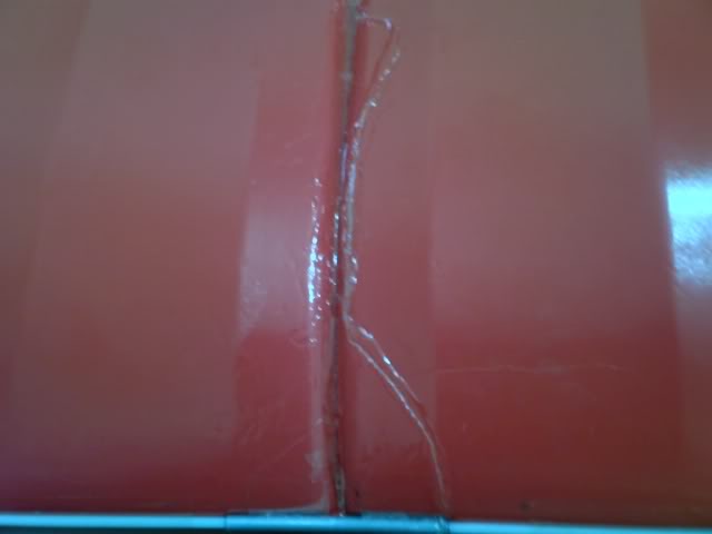

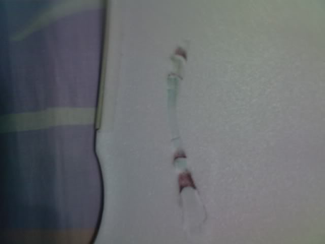

          Ouch.i crashed my plane.
          i almost broke the wing.I lost control of it and it came down and the fence ripped its wing.luckily the fibre grass rod save it a little.my lipo flew out too.I lost 1 of its wheel too.Anyone knows how to repair this?its kinda compressed.

            Fill it with Epoxy, flatten the epoxy nicely... den sprinkle Johnson baby power.
            It will look good as new.

              sand the epoxy?but top of the wing oso got hole leh.

                Stick a piece of sticker on top lah...
                Fill the hole with epoxy.
                Before the epoxy harden, use a atm card or wat so ever scrape off the access... After harden it will be flat den no need sand liao loh.

                  i epoxy my wing,still got abit of hole coz hold not tight enough.will that affect the performance of the plane?

                    ok.haha.sanding fun.lol

                      No need to be so perfect & nice one lah.... Cos at learning stage, more crashes will come, and more repairs too.....
                      Secure and can fly & land, most important.....
