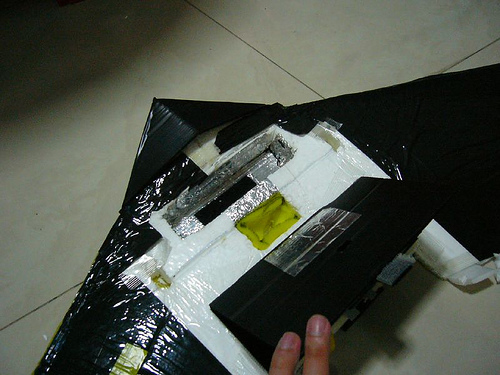

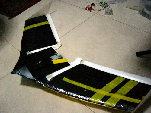

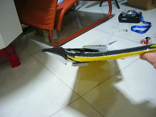

I just did a couple of modifications for this build... cut short the wing span by at least 5 inch i think... used another type of wood motor mount, re-located the servos location, used straight wired rods instead of the bended wire rods that came with it. Used another type of control horns and stick a light plywood underneath to achieve a wider area of contact on the foam elevons. Installed a plastic canopy which came from one of my foamie planes to protect the electronics. Couple of hours spent on this build.... Tested with a china made 3200KV motor, 25A castle creation ESC and below mentioned battery. i think achieved 14A Max, 180-200Watt on ground run test if my memory doesn't fail.
OK..enough said. Here's a few pics to share
Just need CG check with 1000mah 11.1V 15C battery. 1 more roll of fiber tape...to tape up the remaining exposed foam. buy a Spektrum 6000 or 6100 series receiver...or steal one of the receivers from my foamie plane. And lastly a nice day get a first test flight of the plane.
