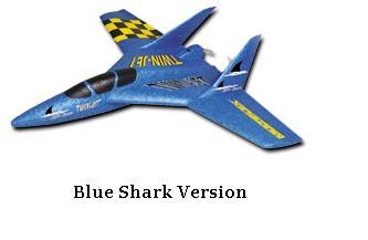

want to know more of Twin mico-jet from multiplex
    Hi, would like to know if anyone has flown this plane before.
    I went to the website of Tower Hobbies and Omni models and some other site to find that this model was discontinue. Is there some problem with this kit. Anyone know why ?
    Am thinking of getting this kit but have my reservation because of the ...discontinuing clause of this model.
    It was very popular a few years ago, although most owners changed the powerplant to brushless setup to spice up the flying capabilities. Multiplex do not usually produce a kit design for too long. After a few years, they move on to newer or upgraded design. By the way, the Twinjet predecessor is the Picojet, and later followed by Microjet before being superceded by the Funjet.
    Check our local store, NTC Engineering. Their website still shows the kit. Do check out our local store before jumping into oversea websites. You will probably get a better deal unless you are bulk ordering.
      Hi Joe, thanks for the info.
      May go down to NTC to have a look and see if they have stock or look elsewhere.
        I think I saw one of them at NTC today. So yes, they have it in stock.

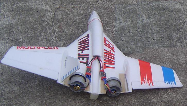

          there's pretty good reviews in rcgroups on the twinjets , especially the twin brushless setups.. i do have 2 nib kits that i bought from hobby-lobby @ a steal but sorry , ain't letting them go.. i am going on a twin brushless setups on them,
            jus a question on these twin pusher setup, wat if one motor loses its power more than the other and began to slow down, wat will happen? i notice the motors are mounted apart not side by side like your twin ducted fan, will the plane yaw to one side?
            More Birds, More Luck!!
              You'll notice assymmetry thrust in this case and the plane will yaw to one side. However, for twin electric setup, this scenario is very remote unless the motors have different utilisations before being setup as a twin. I've witness one with twin brushless setup which blew both motors together during a very high speed dive.

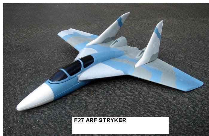

                F27 Arf
                Hi, while browsing the internet I saw this plane looks vaguely familar isn't it
                Now I know why the twin micro-jet has disappear.....
