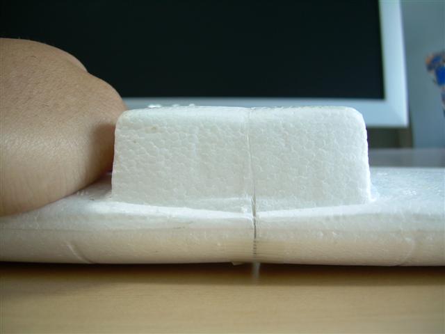

                          Okz, got the mod done. Here are the pics, in sequence of the steps taken.

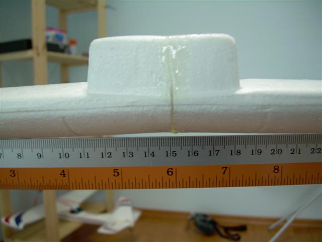

                          First, I cut into half and trim the wings in the centre to make the wing flat. Once trimed, the V-shaped wing will be not V anymore. Making it a flat wing supposely for better acro moves.

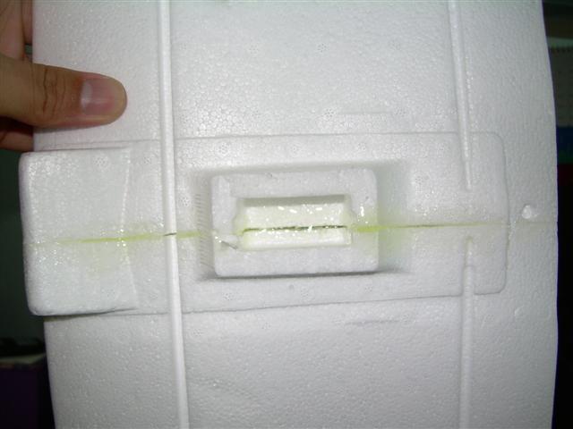

                            Once the desired flatness obtained, temporarily tape the wing together, and epoxy. Make sure the entire line cut, has epoxy throughout to hold it together for best strengthen bonding.

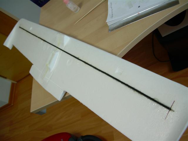

                              Next, run a 3mm carbon rod along the wing. The original groove is short, for what I intended. So as advised by John, I lengthen the groove with screwdriver.
