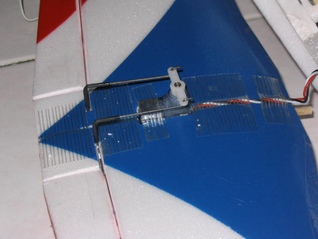

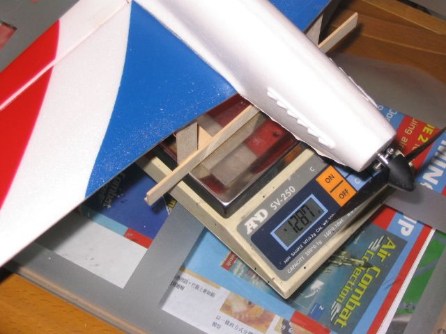

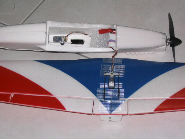

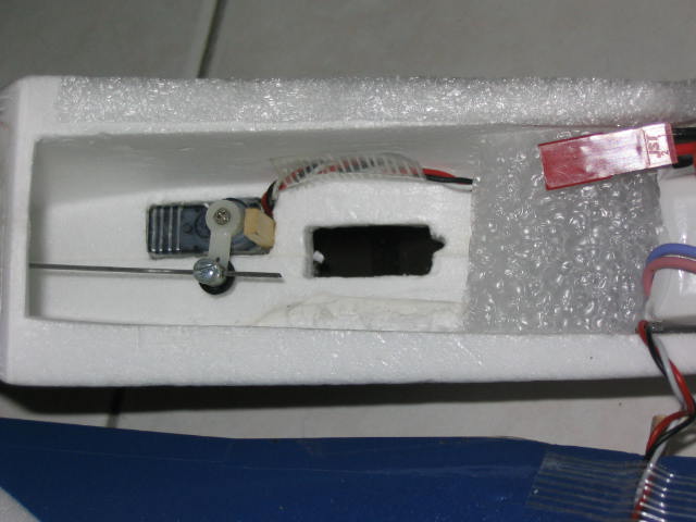

                  Yes, mine is aileron with elevator.......some mode on the wing too. Reinforced with carbon rod and additional 3mm compress foam glue to the underside of the wing to change the wing airfoil shape.
                  Some pic taken from my old P51 building threat, hope it helps.....BTW my P51 AUW (inclusive of 450 mAh lipo) is at 128.7g......
