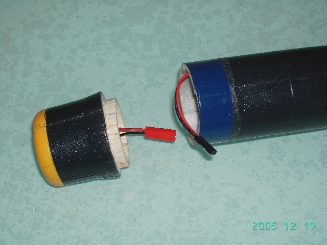

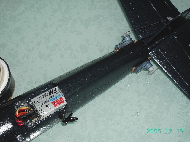

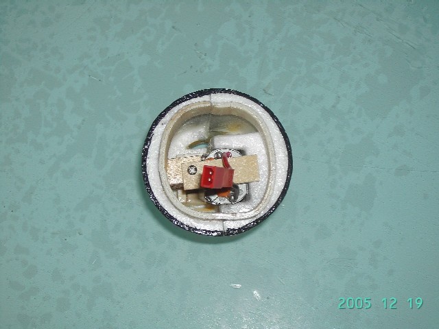

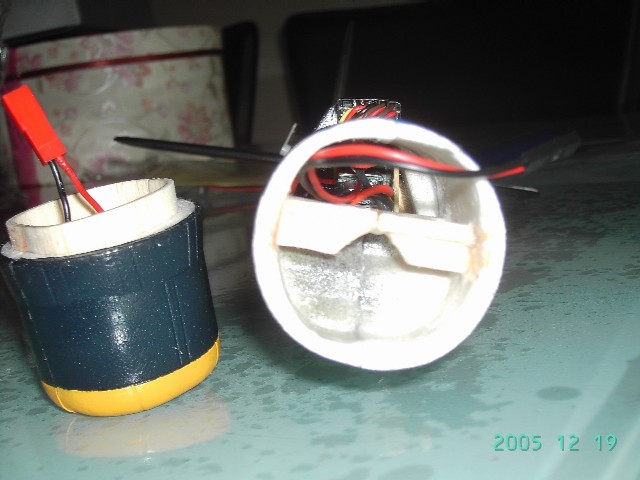

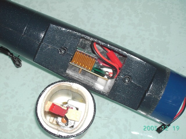

                    Cossair Build
                    Hi
                    Been building up my cossair. So her it is with some mod.
                    1. Cowling cut off so that motor can be easily replace.
                    2. A look inside the cowling.
                    3. Rx is kept in the cockpit & servos are mounted externally so that can be easily taken out.
                    4. Battery compartment. Now to look for a gd batteryto fut that space. A little sad that by inventory don;t have a battery that small.
                    5. ESC mounter in the fuse can also be easily removed. Look like have enough space for aileron servo as well
                    So any one know a good compact battery to use. Any mod on aileron also well come. Thank you.
