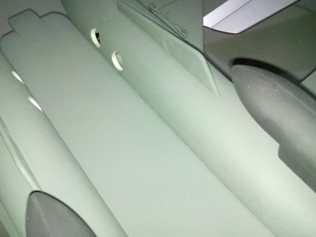

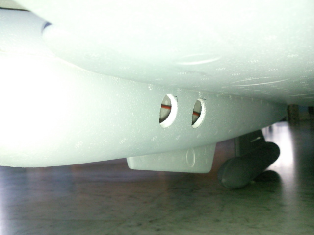

                    Hey Dave,
                    Think you got the same EPF F-14 as mine. You need to open up cheater holes close to the fan cos the original intake duct is too small.(Makes hell lot of difference!) Just be careful not to cut any wires while your doing it. I down size the fans from 2 x 70mm to 2 x 64mm. Shifted the fans back nearer to the tail cones 3 inches from the exhaust to prevent loss of thrust.

                      Hi Raven,
                      Thanks for your quick response, looks like u r on line now
                      From the picture, yes, we both have the same model
                      I did cut some cheater holes (per those early build thread), in fact, I cut 4 sqaure holes (10x17mm) at the same position u shown in your enclosed picture.

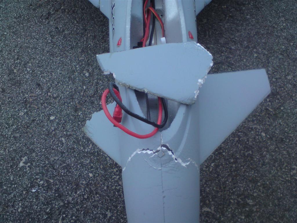

                        I have maiden it , can take off , but no power , always on full power , then
                        decided to land quickly ...... then ...... crash ...

                            Bro,do yourself a favour pls.If already say throw away where will give u?
                            Falcon,it still can be repaired.Not very extensive damaged.Maybe wont look nice but can fly ok already.Good luck for your next flight!
