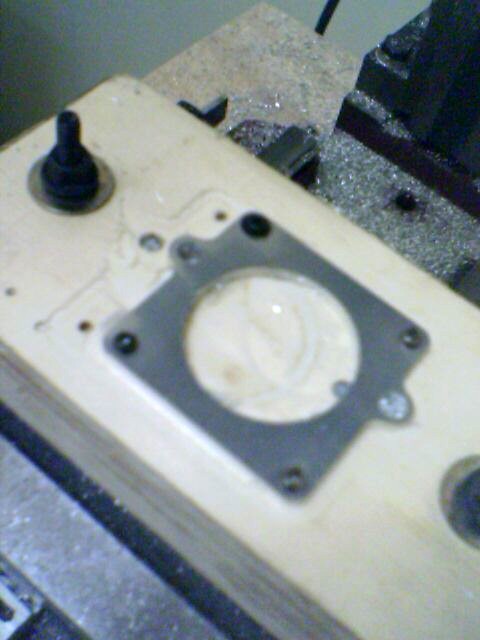

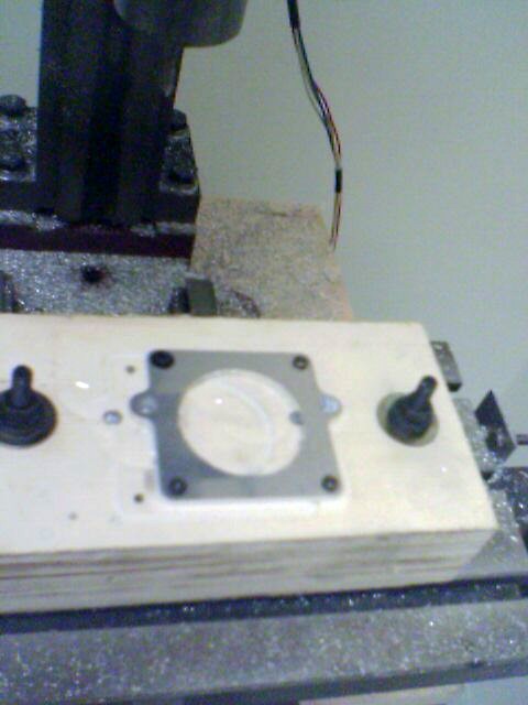

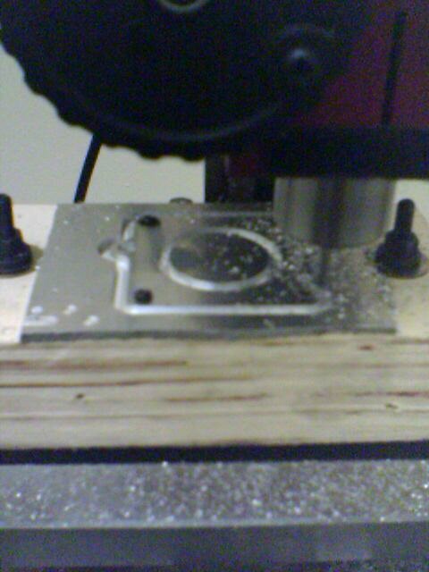

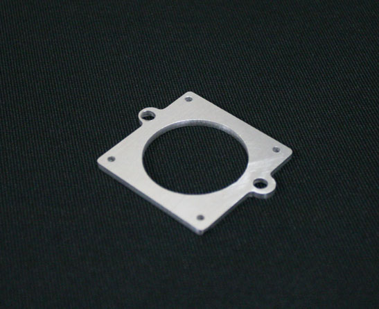

    Did my first CNC'ing on a 3mm thick Aluminium
    This part looks real simple but took me ard 3hrs right fr the beginning till the complete part

    seem like the left hole needs a bit of adjustment.

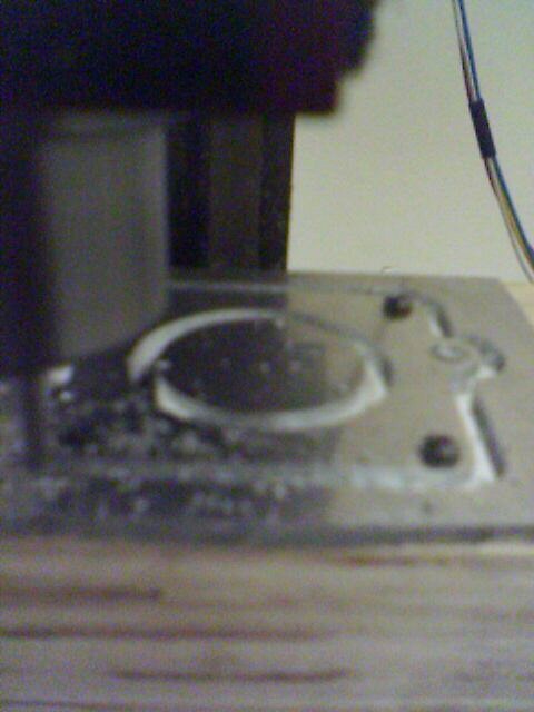

      yeah...bcos nv do pilot hole .... so learn fr mistake ...
      The big hole also had some defects.... feed in too much at too fast a speed.
      Overall is a satisfactory cut Nv do nv learn
      One thing I learn from cutting this part, holding the part down itself is already some challenge

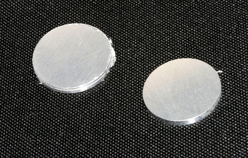

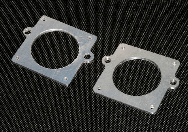

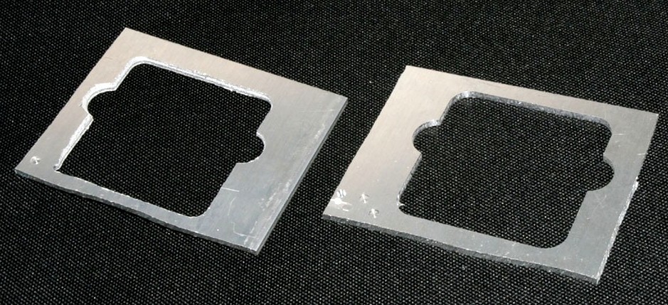

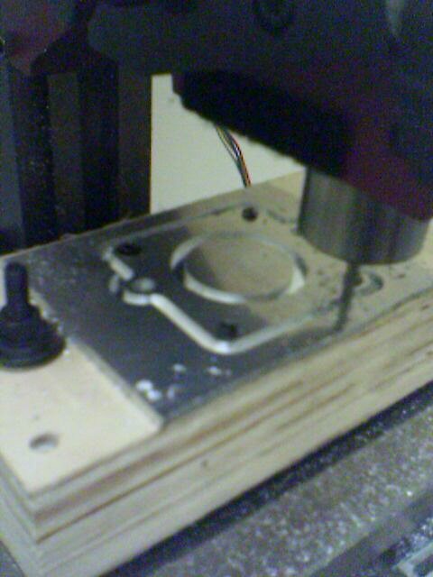

                  Yeah, do another round of CNC today for the same parts. Time used : 1.5 hrs instead Quality is much better with better speed and tooling used.
                  1st pic is the actual mount. 2nd and 3rd pic shows the left over

                              Initially I used a HSS 3mm End Mill. The cutting is ok.
                              Yesterday, I switched to Carbide Type 4mm End Mill. It can take deeper cut w/o problem thus reducing the overall cutting time.
