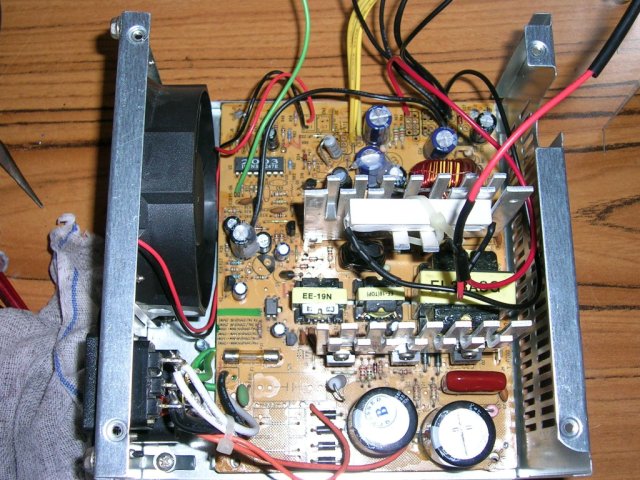

0. Try to clear the power left in the capacitor (if any). Use bulbs or ammeter to check.
1. Open up the P/S, removed all unused wires.
2. Keep only red (+5), yellow (+12), black (ground), green (PS_ON), and any other wires u want to play with.

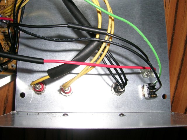

3. Drill holes on the casing, mount the posts. I had 2 12V post and 1 0V post.
4. Connect the +5V to the postive pin of the LED. And the ground wire to the negative pin of the LED.
5. Connect the +5V to the resistor and negative wire to the other pin. (To load the P/S for stable o/p).
6. Connect (solder) half the yellow wires to 1 12v and the rest of the yellow to the other 12v post.
7. Connect the green wire n 1 negative wire to the switch. How? If u dunno, u SHOULD NOT be attempting tis mod!
8. Close back the P/S and u're ready to rock!

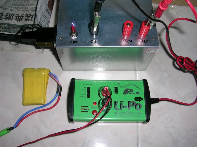

measure the output to be about 12v, dun have a DMM to check.. using analog MM.
Charged a 2s lipo using the prolux 3834 without any problems.

I tied the resistor to one of the heatsinks to help dissipation.

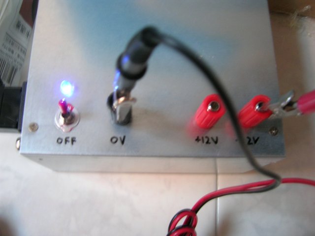

2 red, 1 black post, 1 switch and the led above the switch.
New P/S in action!!
I love blue leds!! Looks damn cool charging at nite!
