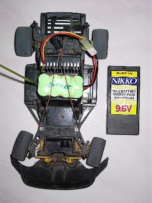

    Add connector to accept 9.6V 1000mha bat (from art-tech), stock nikko only 630mah. Full throttle run time increase from 20 mins to 30 mins ! Weight is 160 g compared to 180g. Price the half too !!!!! Improvise man .. CG not affected easily like plane !
