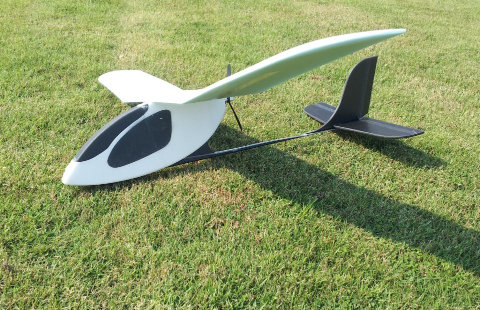

One day, I was surfing the internet, looking at Autogyro designs, something really caught my eyes, and being a pusher, all I need is to redesign the fuselage and tail to accept a pair of fixed wings and the empennage.
I was so excited with the pleasing outlines, that I took just a few days from drawing to fabrication. The original has a V-tail and had since been replaced by a conventional empennage, due to 2 crashes from severe dutch rolling. The motor is a 20gram HK outrunner 2000kv spinning a 3 bladed 6x3 prop. The ESC is Hobbywing 10amp and fed by a 2S 850mah Lipo. For simplicity, the design only needs 2 pieces of 5gram servos for rudder and elevator.
I have flown it on a fully charged pack, all the way till the BEC low-voltage cutoff sets in. The total flight time was 23 minutes with wild aerobatics like loops and rolls. Yes, it rolls in rudder pretty well.

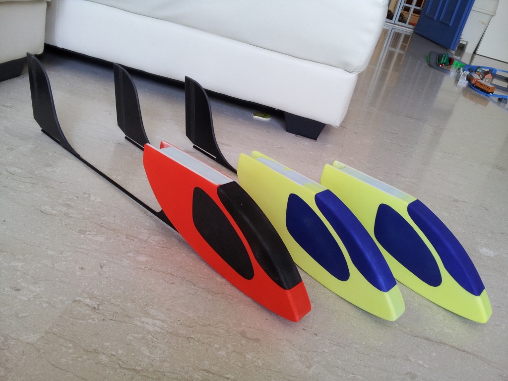

From the picture, you can see the repair glue joint. It was induced during the second and most violent crash into a tree. Currently, I am building another 3 fuselages for the club. I really like the way the paintjob turns out to be.
As for the name, I wanted something cute and appropriate. From the looks of yellow and orange fuselage, they match well with the various types of Canary I have seen from the internet.
