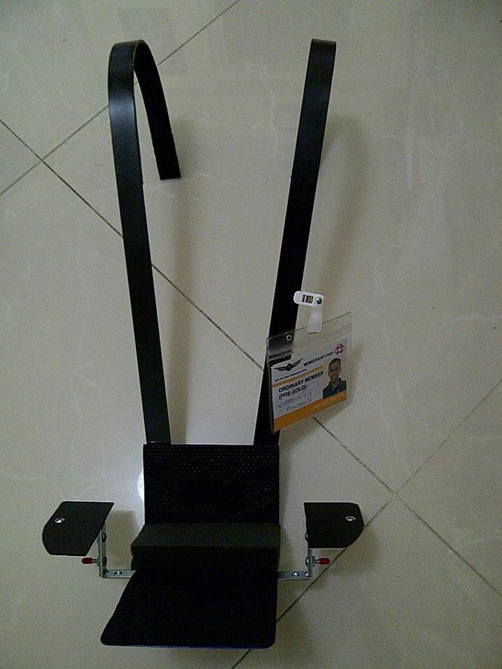

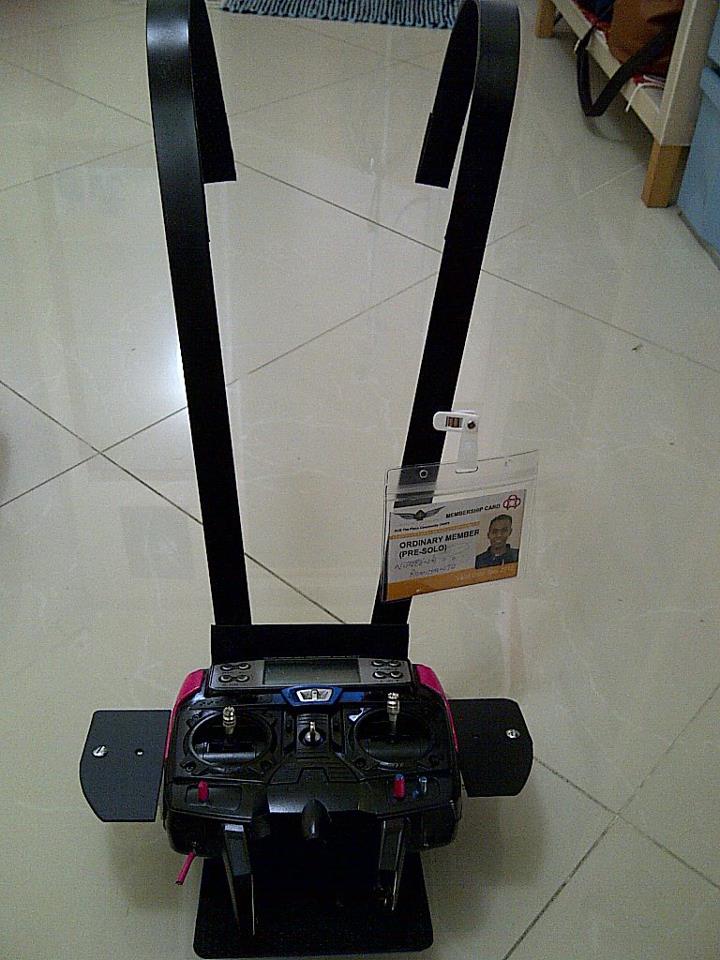

    Well can't afford the Dubro TX Tray so i diy one. This is my 2nd one actually. The first one i did was without the hand rest and was a very simple one. This 2nd project is with the hand rest and some materials from daiso for cosmetics purpose. I'm more of a finger-thumb pinch mode so it really helps to have the hand rest by the side.Click image for larger version

    Materials used:
    2 x 2 1/2 feet flat aluminium rod (Hand bend to shape for the shoulder area) Shoulder harness $1.30/ft
    4 x corner brackets (Available at hardware shops. Comes exactly 4/pack) Hand rest assembly $2.90
    Old book end for the main base.
    Small clipboard (Available at Daiso) Cut and trim to shape for hand rest plate. $2
    Anti slip mat (Available at Daiso) Lined the top of the main base and shoulder area for cushioning. $2
    Foam double sided tape.
    This is a pic without the tx.
    More details and pics at our fb page.

      Great idea
      Nice... It's a great idea to use a book-end as the tray body.
      Saves the trouble and work of having to saw, smooth and bend a sheet metal piece to get that shape.
      Where did you get the aluminium flat strips? And what's the thickness suitable?
          I bought the aluminium at my local hardware shop. I think most hardware shops have them. I usually ask for flat aluminium rod. The thickness is 3mm and its easily bendable with a little strength.
