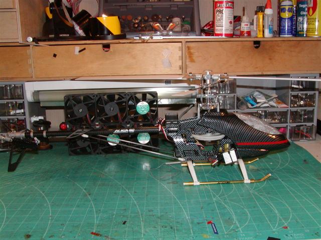

      its just waiting for the mega 4t and and cc25 with bec to be mounted. then with the double gyro stabliser and the camera .....well you get the picture

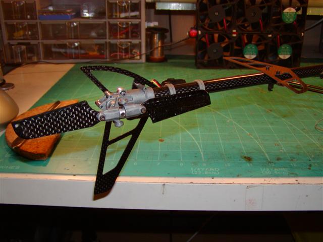

          ha, my DIY carbon tail fin is also 3g. But due to lack of materials, i have to design it with the best I can, which makes it rather ugly, but it works the same

              yeah its amazing what 2m sodium hydroxide will do 15 sec and they are no longer blue
              and it looks much better close up .... and big
              be carefull with loading up the heli while tied down ..good chance to for something to break ..but way to go to get them so well tracked

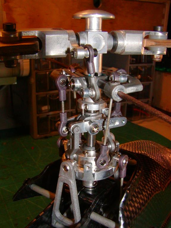

                    rotor hub from a guy in the states ....( did a swap for a set of grips from champion) grips from champion, arms align, swash SHS shogun ( 90' and as well as 120')
                    dont ask about price ...I dont want to think about how much
