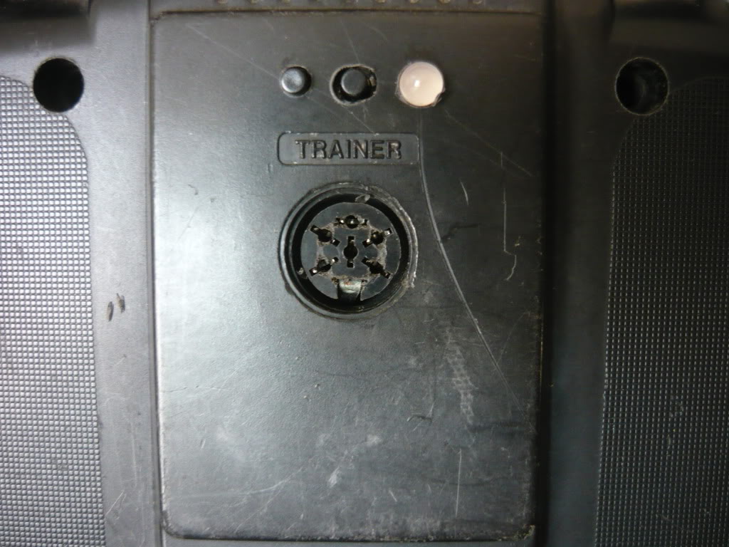

    All ready for conversion
    All fixed up
    All ready for flight test

    Photo time

    End product
