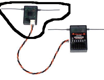

    i traded some of my stuff for a dx6i and now im wondering how to put the thing extended from the receiver.
    i circled it in the picture.
    some say parallel or perpendicular.. i duno wad it means. pls help

    As shown in your picture they are parralel to each other.
    TUrn one or the other 90 degrees or 1/4 cicle when looking from the top then they are perpedicular to each other.
    Hope this helps.
    It would be useful to know what you are fitting it into /onto if you need any more help.

          Since it's a parkflyer, you do not need to be that precise. Just place the primary and secondary receivers away from each other.

              No need headache, just put away from the main RX can liao. I'm not sure where u get the idea to put it perpendicular or adjacent, etc. ;)

                    As the manual states perpendicular is best but its tough to do that and maintain them at least 2 inches from each other. The set up shown in the pic will be fine

                      then rotate the smaller one 90 deg lor
                        why didnt i think of dat?
                          Just make it such that the 4 wire make a cross
