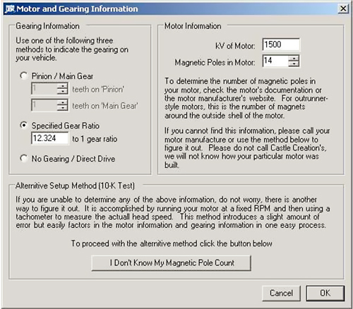

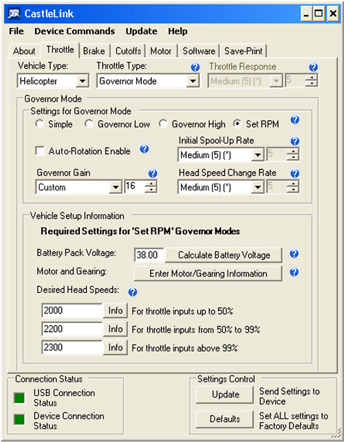

            I am using the new firmware now, the governor seems fast and consistent with no oscillation. You don't need to tach the head speed just set your targeted HS in the software and you're done. My settings for my Mini-T are 2800 for normal and 2900 for idle-up. The logged data from Eagle Tree is ranging from 2800 to 3000 with mild 3D doing flips, inverted hover and tick-toc. Going to set the CC80 on my Trex500 and see how it performs.

              I am using the 'Set RPM' mode BTW
