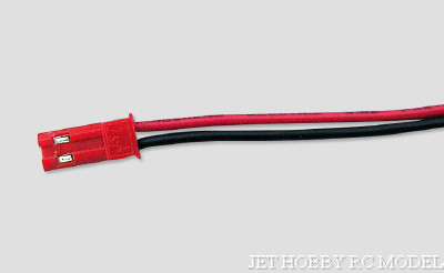

          My guess is u referring to the JST connector as in the pic.
          JST type of connector is good for up to 5A only. I suggest u go for this :
